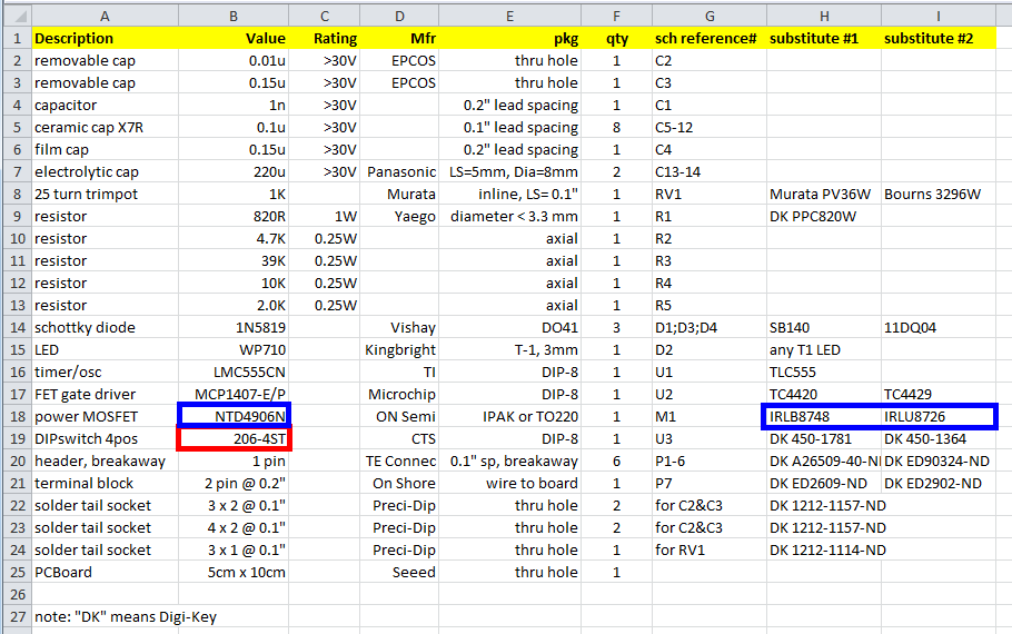

I have only tried the devices listed in the Bill Of Materials. I have not tried other devices that are not listed in the B.O.M. You could do some experiments with non-BOM parts, and find out whether they do, or do not, work well on the QM V4 PCB. Remember that Cheapomodo manages to function properly using 3 crummy 2N7000s in parallel. This might provide a reason to be optimistic, that other types of MOSFETs may succeed too.
The DIP switch is listed in the BOM, see red box. Its web page is here.

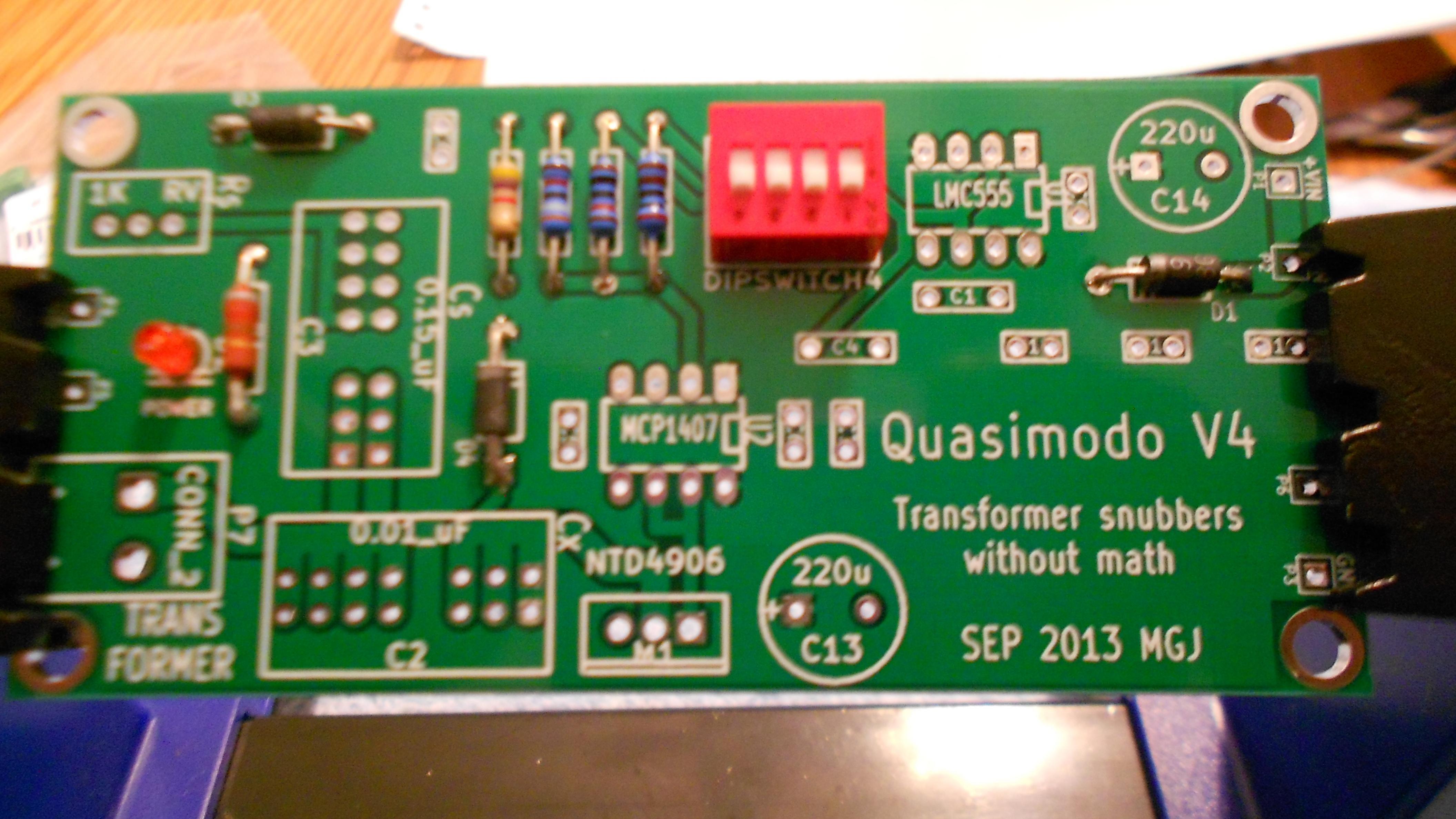

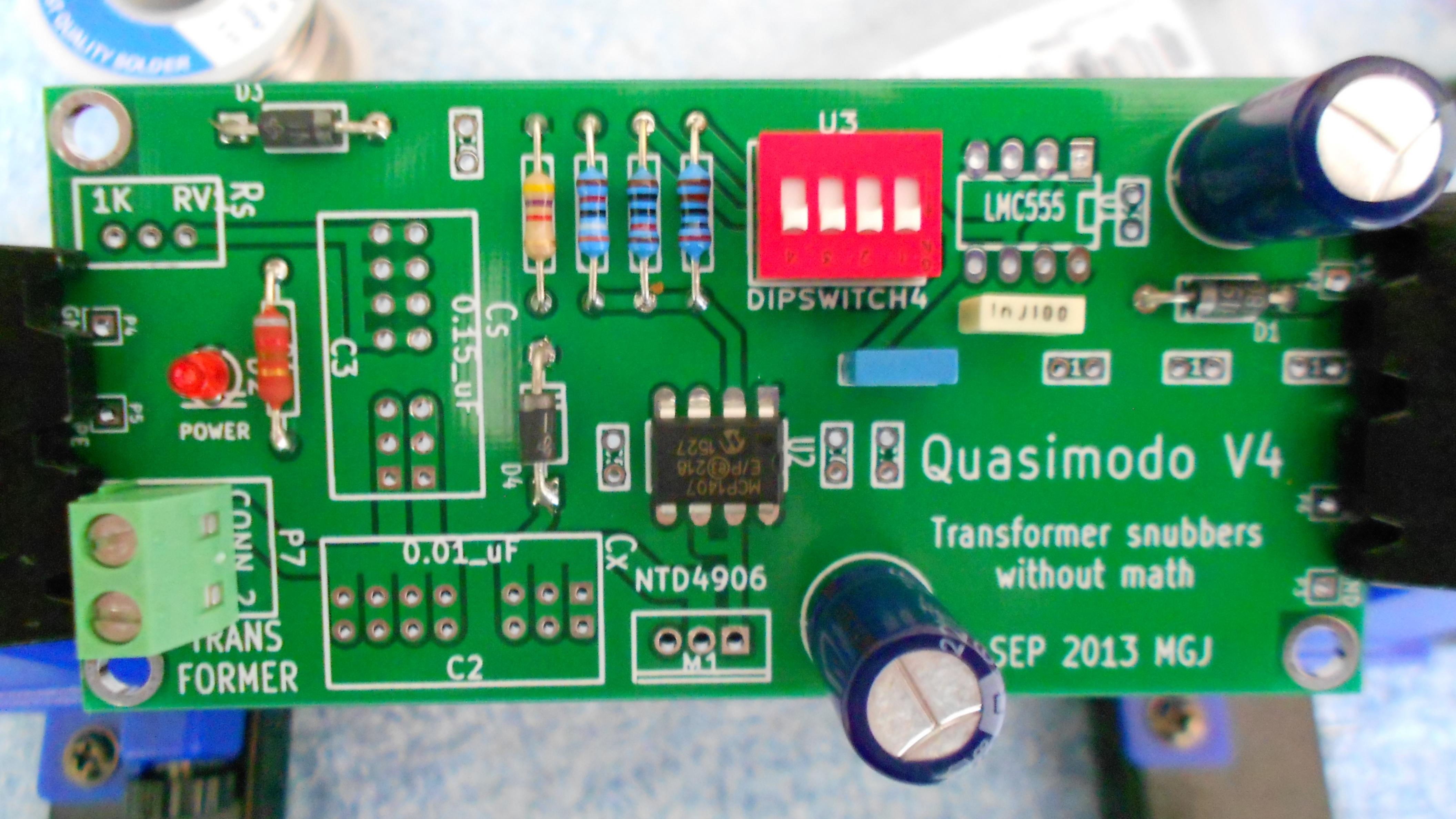

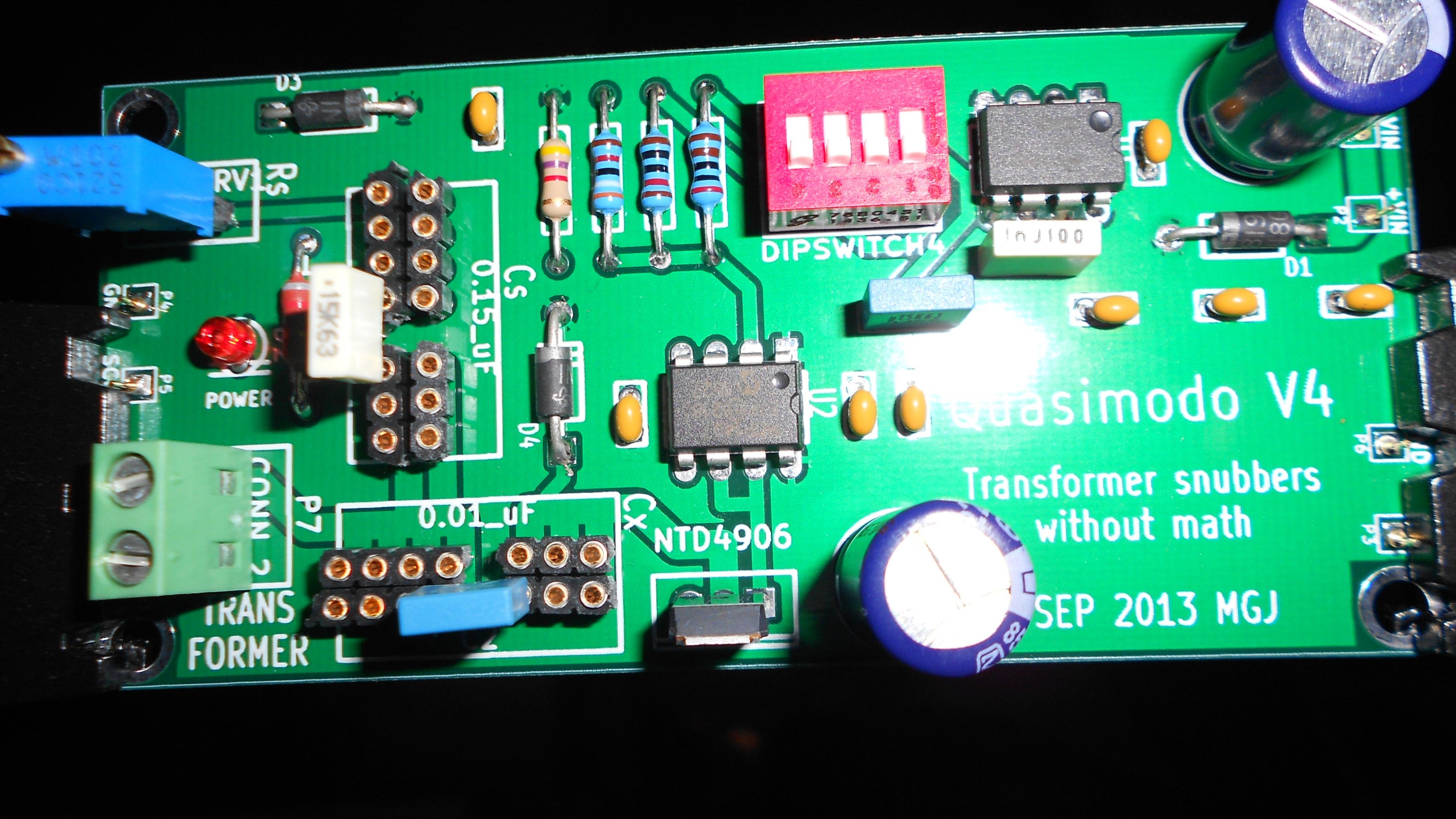

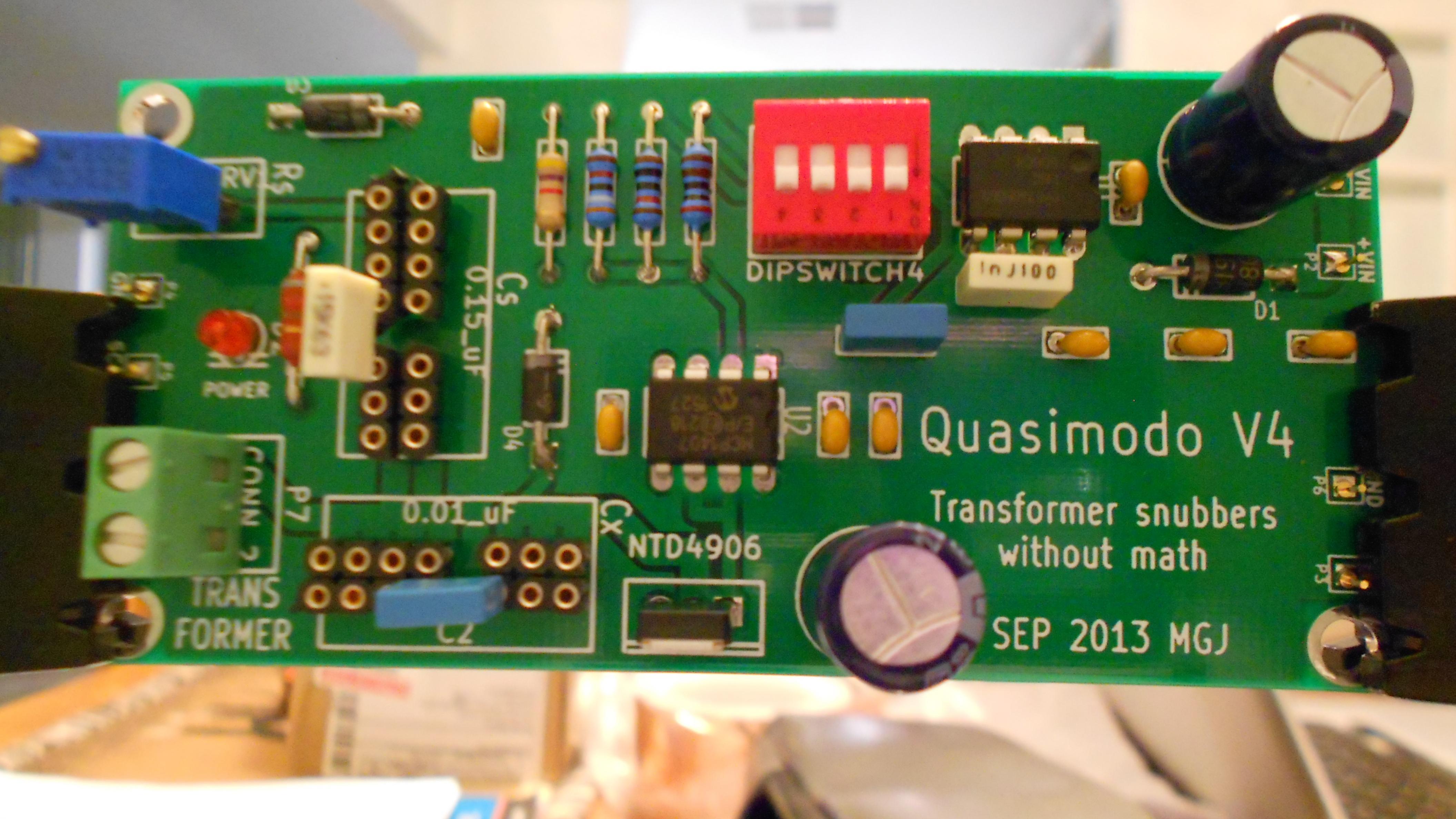

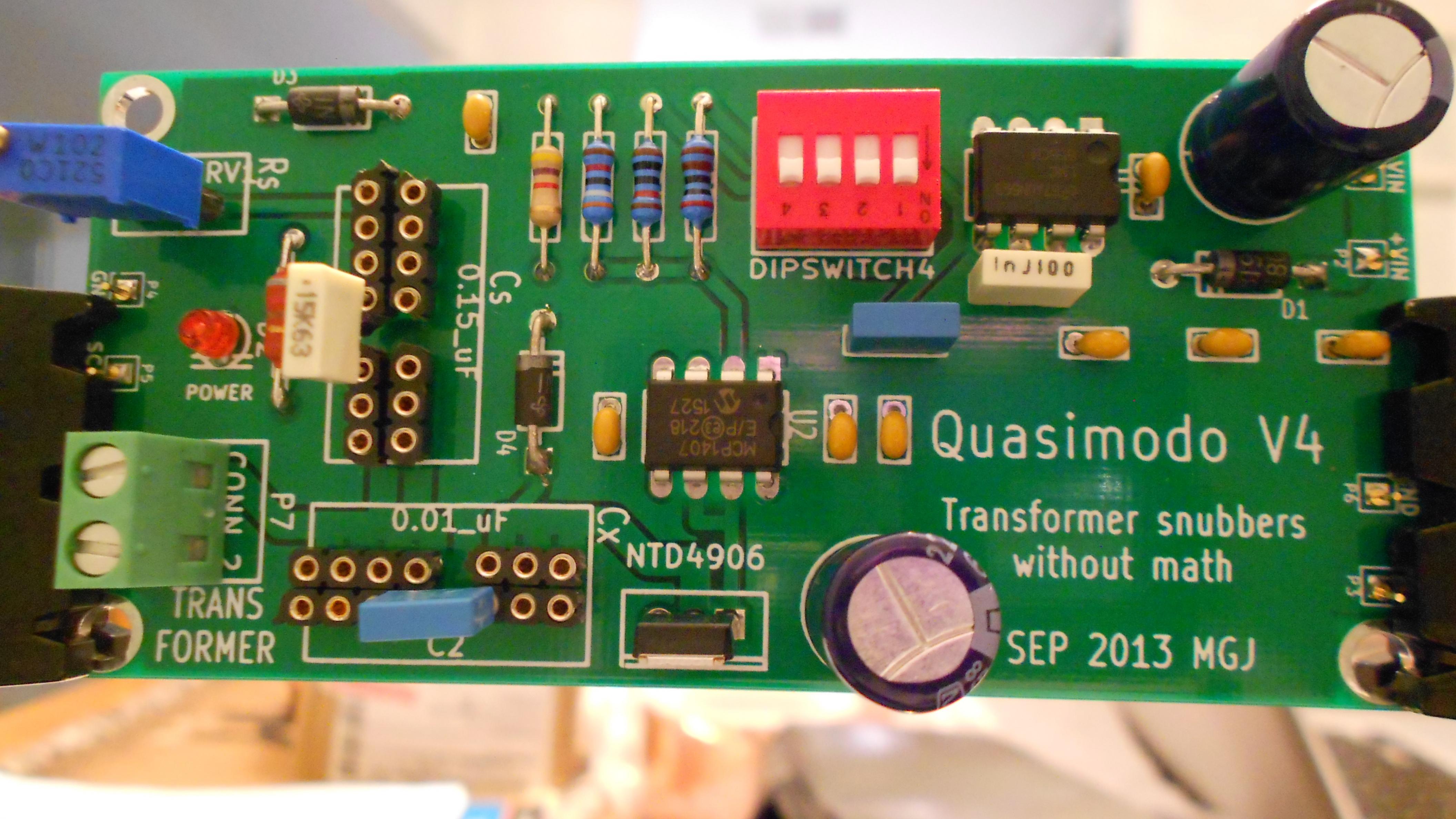

My Quasimodo build
Attached are some pics of my Quasimodo project.
I look forward to comments that identify possible issues prior to testing.
Thanks Mark for the support and others who assisted in my search for a pcb.
