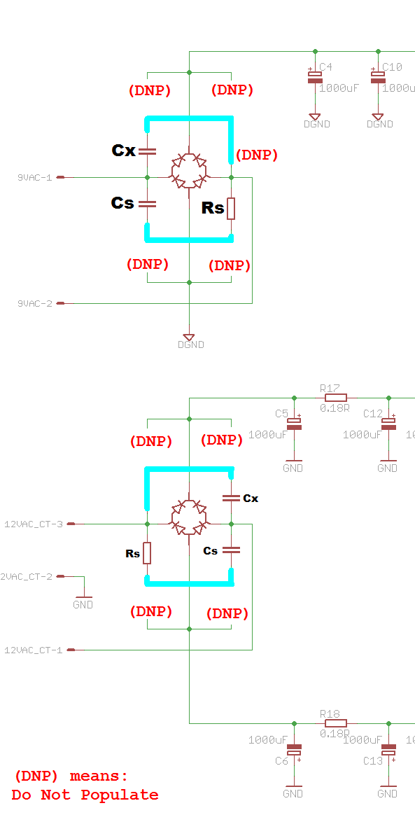

So, what I wonder now is how/if I can apply this to the snubber arrangement I've left on the PCB
I think there's a pretty good chance that you can use the same PCB holes and the same PCB pads, to make the Quasimodo-preferred 2C+1R snubber, instead of your earlier 4C+4R design. You simply re-purpose some of the component footprints, and install a couple of insulated jumper wires (shown in boldface blue, below):
attachment.php
Yikes! Only now do I see that your second schematic uses a center tapped transformer. For that case you need two CRC snubbers, please see the bottom row of QM design note page 11, and subsequent discussion. The bottom half of Post #341 incorrectly includes only a single snubber. Oops. You need two, not one.
You want to locate your snubbing components Cx, Cs, and Rs as physically close to the transformer secondary as possible -- right at the ends of the transformer lead wires -- to minimize loop area, and to snub out oscillatory ringing immediately. Someone asked that same question previously in this thread, and someone else answered, but I don't have time to search for it.
Thanks! Yep, that 12V CT will need two, I measured it in accordance with the PDF which shows two 3 component snubbers. If they are best located near the transformer then I shall simply add them to the not-yet-designed transformer board, as you suggest, right on the transformer output.
As for the PSU board, I can simply leave these parts unpopulated.

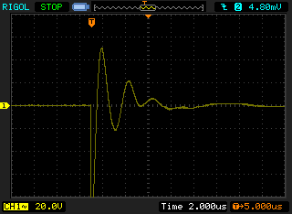

If you connect the Rs, Cs network with Cs to the Quasimodo output pin (transformer secondary) and Rs to ground ...
Then Rs is DC isolated from the rest of the circuit. You can measure Rs with your ohmmeter without removing it from its socket.

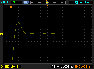

Tried the Quasimodo with several Nuvotem xformers, all 230 primary with 15V-0-15V secondaries:
Here are the results for critical damping (15V out paralell, first 2 figures) -
For a 120VA xformer, C1= 0.01u, C2 =0.15u, R1 ~42.5 ohm
For a 80VA xformer, C1= 0.01u, C2 =0.15u, R1 ~39 ohm
For a 50VA xformer, C1= 0.01u, C2 =0.15u, R1 ~38.6 ohm
However, I cannot measure the value for with only one 15V out while the other 15V shorted (last figure):
I suppose you could connect up the transformer in a crazy & unrealistic configuration, and use Quasimodo to find an "Rs_Phony" for the secondary from end-to-end (with center tap floating). Then make a tenuous assumption that the correct value of Rs to use in each of your two snubbers (from each end to center tap) is probably something in the neighborhood (1/2)*Rs_Phony.
You may decide "hey, it's better than nothing."
You could try it in simulation to see whether the assumption is bogus or not.

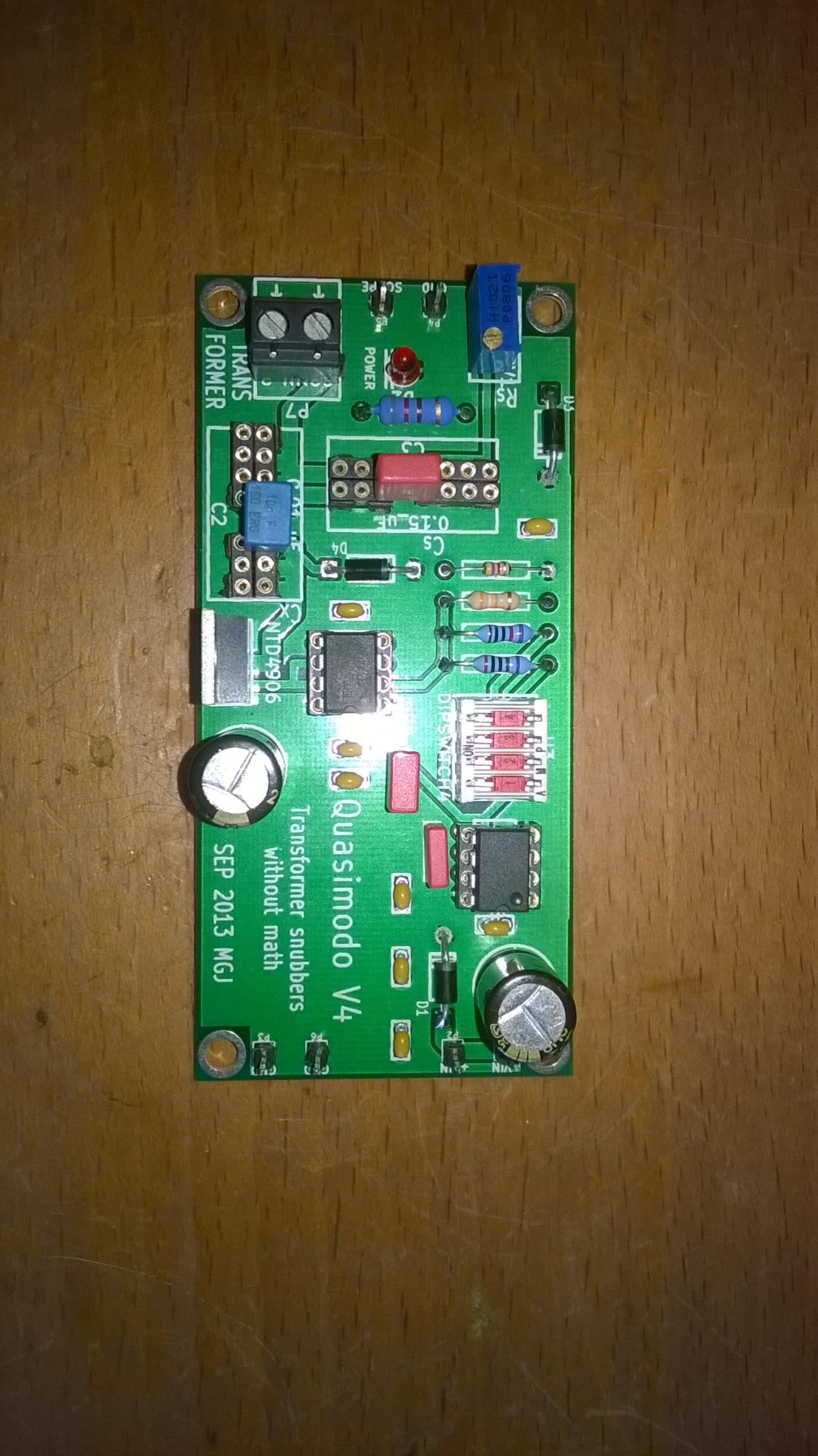

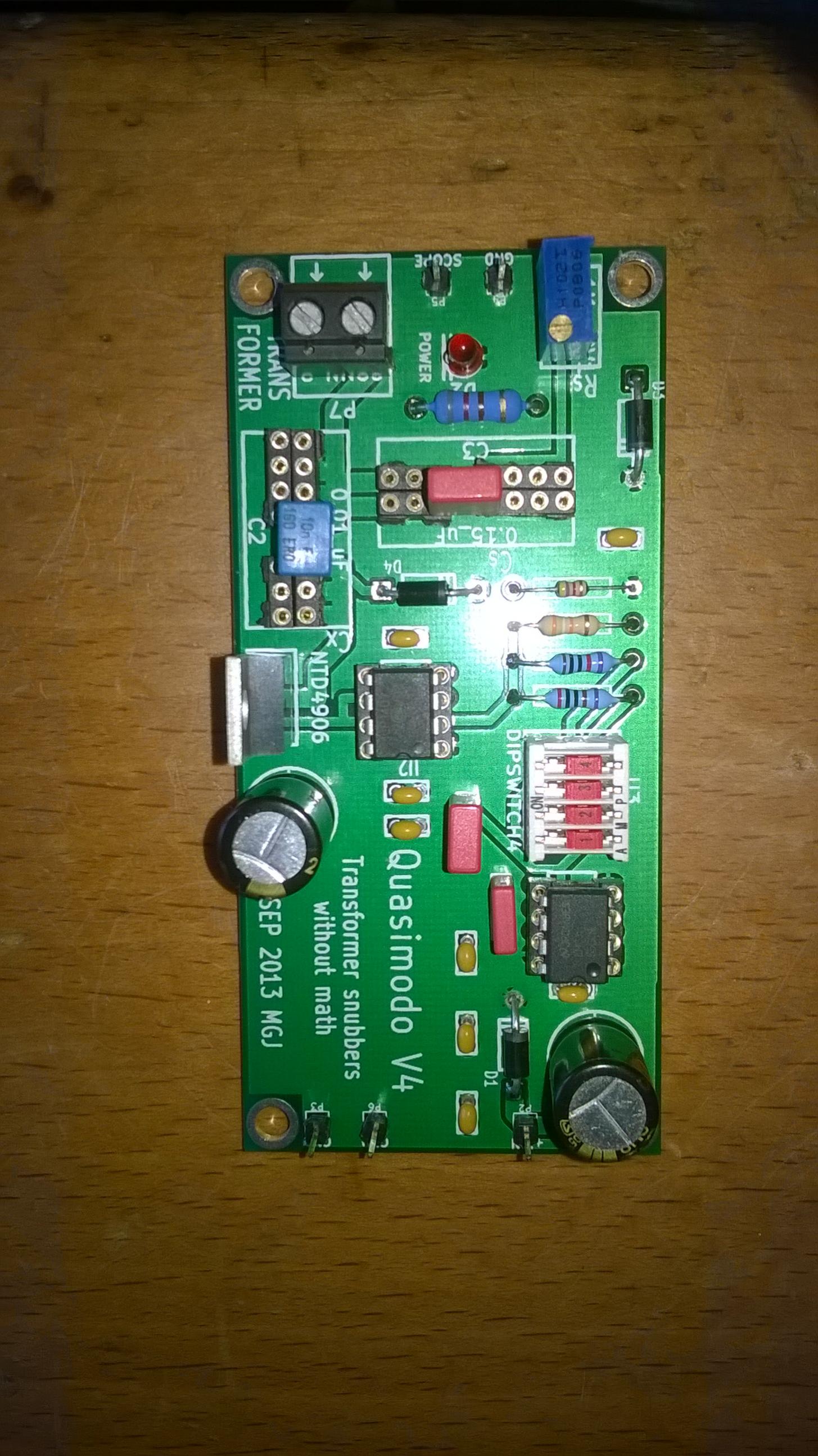

  1. Insert and solder all resistors, Schottky diodes, and 0.1uF ceramic bypass caps (photo 1)
  2. Insert and solder the two 8-pin ICs, the DIPswitch, and the power-on LED (photo 2)
  3. Insert and solder the MOSFET, the film capacitors, and the electrolytic caps (photo 3)
  4. Insert and solder the green terminal block, the 3-pin socket for RV1, the (4x2 + 3x2) sockets for C2 and C3, and the six 1-pin headers for +VIN, SCOPE, and GND (photo 4)

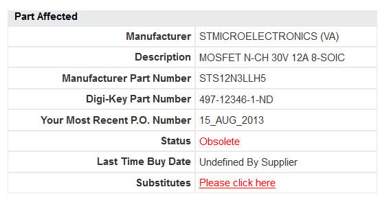

I received an email from DigiKey this morning (attached), warning me that the SO8 surface mounted MOSFET used in Quasimodo v3, is now considered Obsolete.
DigiKey USA says they still have 1900 of them in stock (part number 497-12346-1-ND), priced at USD 0.75 for qty=1, or USD 0.294 per piece if you buy qty=1000.
I checked the other two SO8 MOSFETs, listed as acceptable substitutes on the Quasimodo v3 Bill Of Materials, and both are in stock at DigiKey. I also checked the manufacturer's website, both of these parts' listings say: "Status: Active and Preferred".
