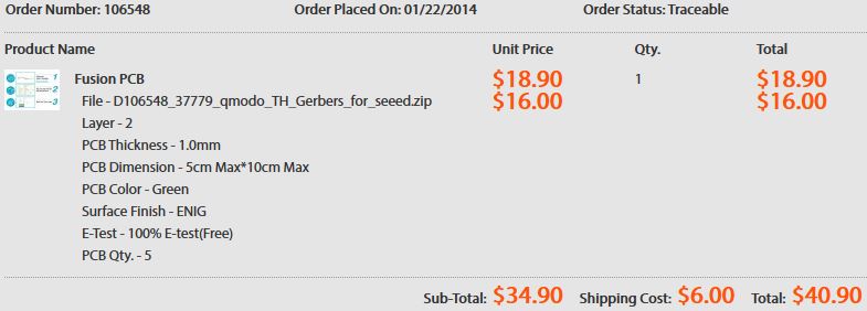

Mark: I guess when one orders 20 or so PCBs and part sets price drops quite a bit as your original post implies.
Here is the math. OSH Park charges 34.90USD for 3 boards. USPS charges 3.22USD for shipment of 8oz in a padded envelope, which costs itself as well. PayPal charges 3.75%.
As for the full kit, the BOM on Mouser rang up 26.32USD with 4 0.1% resistors and the test per Borse's BOM update. I am not going to split headers to ship several pins with each board. USPS priority mail small box is 5.95.
Thank you again for sharing the expertise.
For those who don't mind if the PCB boards are made in China, I also have some V4 boards with ENIG (gold plated surface finishing) from Seeed Studio, and will be happy to part with them at USD9 + shipping. They cost me USD40.9 for 5 boards, so at cost for me is USD9, taking into account the protective envelope and Paypal charges.
I don't have full kits on offer though.

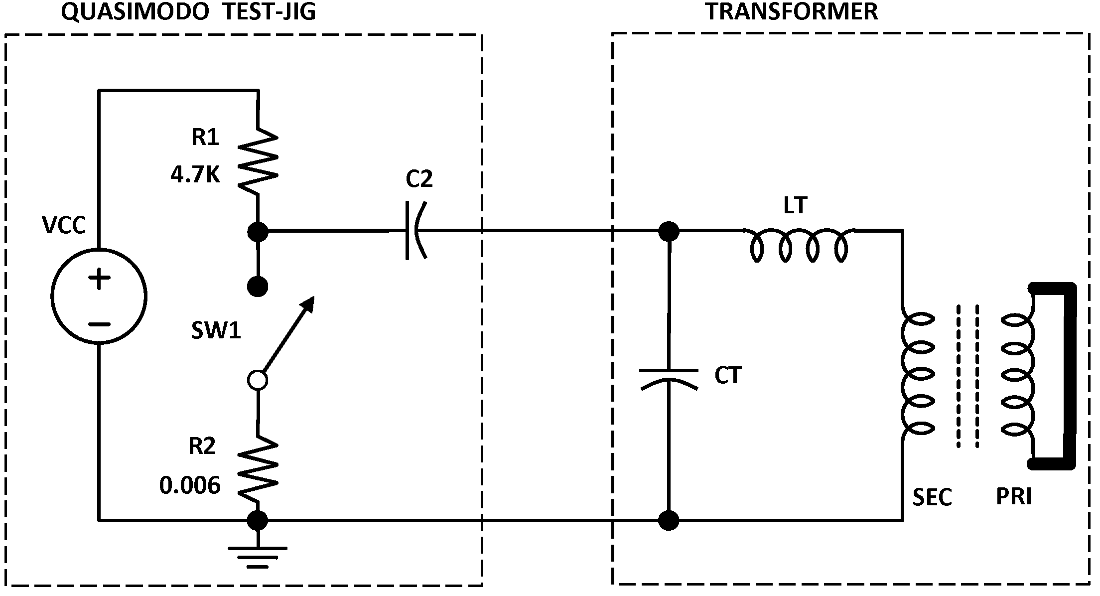

Does it matter if I use 4.97k instead of 4.7k for R2?
Perform a bit of circuit analysis on Figure 2 of the design note (p.3), reproduced below.
Assuming that the switch opens and closes 120 times per second with 50% duty cycle, what is the maximum pullup resistance Rmax that gives acceptable performance? What is the minimum pullup resistance Rmin that gives acceptable performance? Does 4.7k fall between Rmax and Rmin? Does 4.97k?
... figure 2 of ... http://cds.linear.com/docs/en/application-note/an104f.pdf
It seems to me that the Quasimodo and the LTC-1693-1 + FET are doing the same thing. Right?
Please take a look at the first paragraph on page 3 of the Quasimodo design note. It includes these remarks
Capacitor C2 injects a high-to-low voltage step into the resonant circuit. ... Please note that Quasimodo is AC coupled to the transformer, there is no DC current path ...

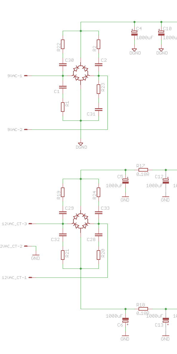

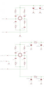

Great and very clear guide! I've done this technique on audio transformers before (optimising square wave response at 10kHz, much smaller values mind) but for some reason didn't apply it to mains transformers!
Perhaps unfortunately, what I did do was expect to calculate snubbers of this (Zobel) style:
http://www.diyaudio.com/forums/solid-state/112453-nap-140-clone-amp-kit-ebay-38.html#post3556518
so my schematic shows and my PCB has pads for these parts:
attachment.php
Today I have measured my transformers (24VA each) in accordance with the data presented in the Qausimodo PDF. I built a quick 120Hz square wave oscillator driving the transformer with an N-Mos. The effect of the snubbers was clear, and I obtained the best response using 10nF CX, 100nF CS, 430R RS (9V) and 450R RS (12V CT).
So, what I wonder now is how/if I can apply this to the snubber arrangement I've left on the PCB, or if I'm simply better off applying it directly on the transformer outputs (they're on their own little board, of course the AC connection lead will be short) as shown in the PDF. Or, perhaps a combination with CX capacitor on the transformer output and the Zobel snubbers adjusted in value to suit a full bridge and applied to the PCB?
Thanks for the great work on this topic and any input appreciated!
