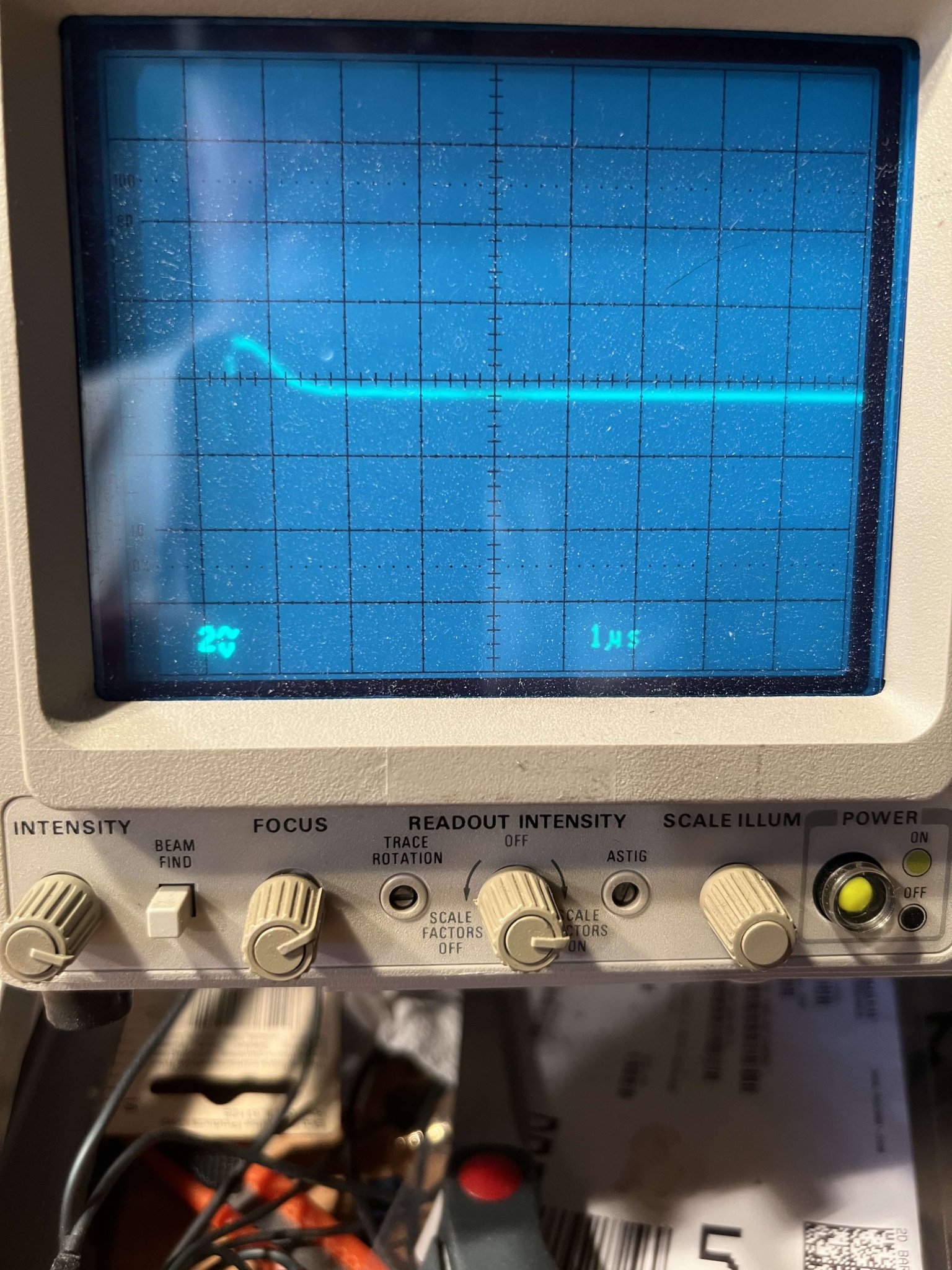

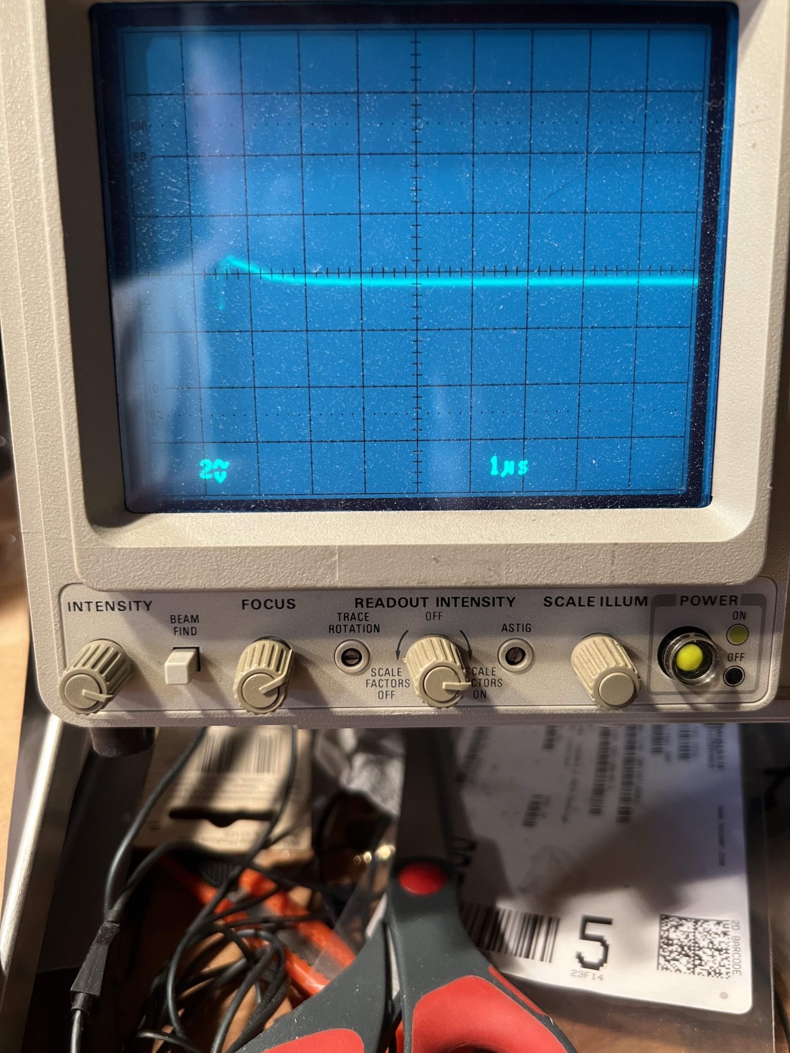

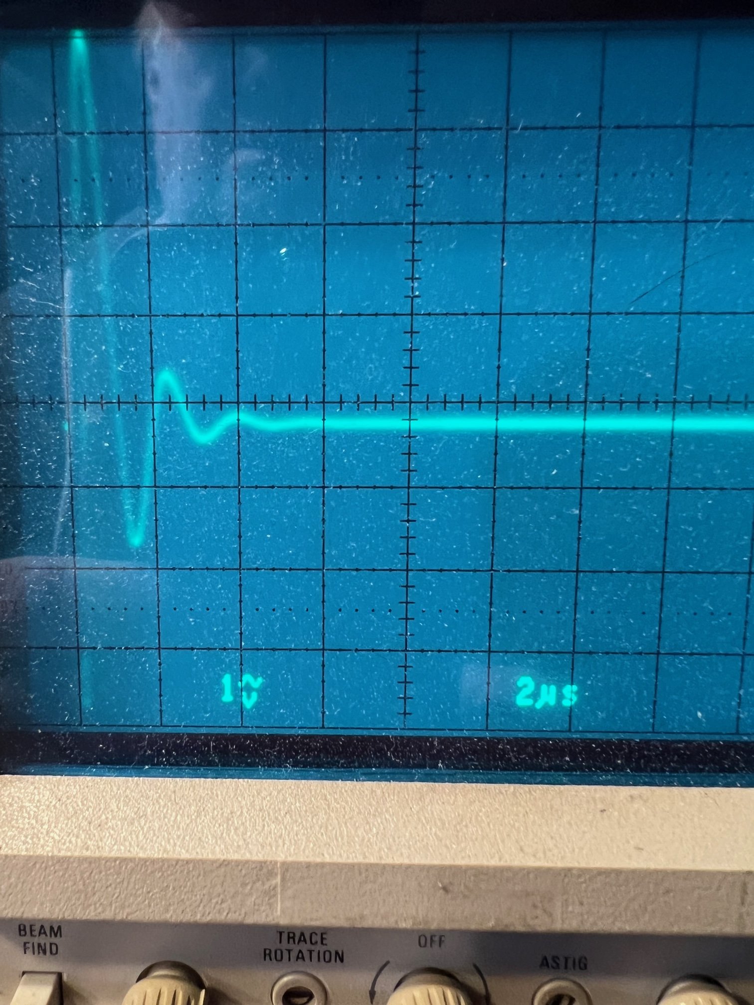

Getting back to using this on a 6 secondary Toroidy Audio Supreme power transformer. Took awhile to get back to using an analog scope, and can't quite get the trigger held off as much as I would like. The first shot is with 100R and the second shot is 12.5R. I think (?) this is in the ballpark (10 ohms or so). This is one of the 24V windings, primary shorted as 120V (parallel). I'll try it with the primary configured for 240V and see if it makes much difference.
And as a reply to Mikey70, above, I don't think there is any value to the old 100nf across each rectifier diode method. I could be wrong however.
Perhaps. I raised it to 20 ohms. Changing to 240V primary configuration didn't change much. All of this is using the std. C configuration (10nf / 150nf). I'll go with that. The 8V windings were more or less the same, slightly higher, so I'll go with 27.4 ohms for those.

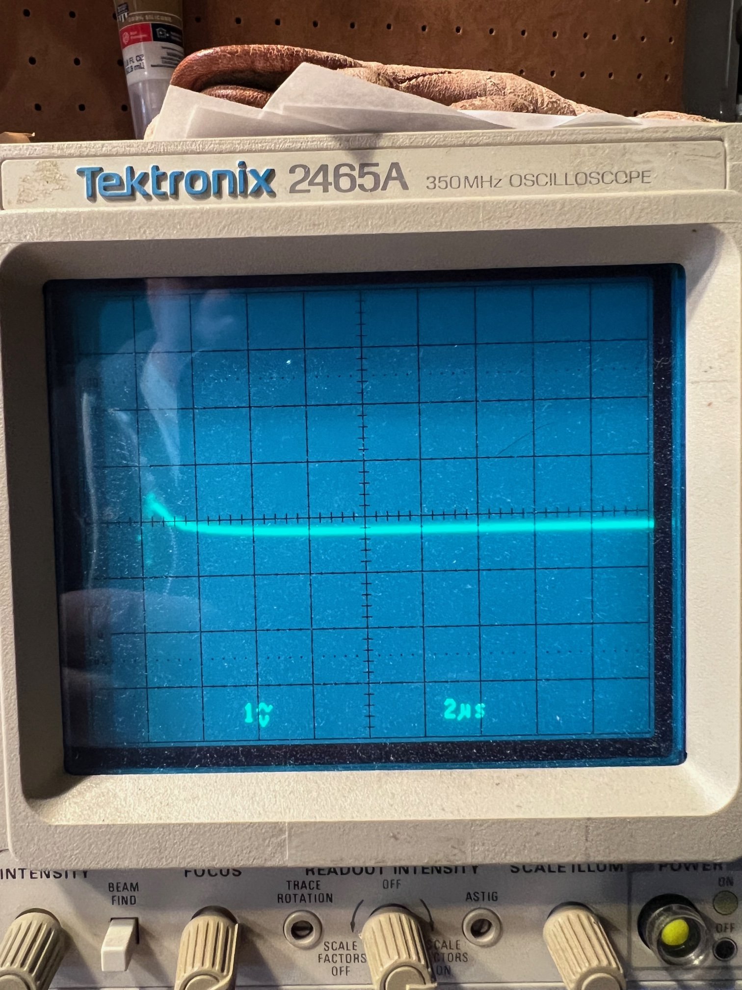

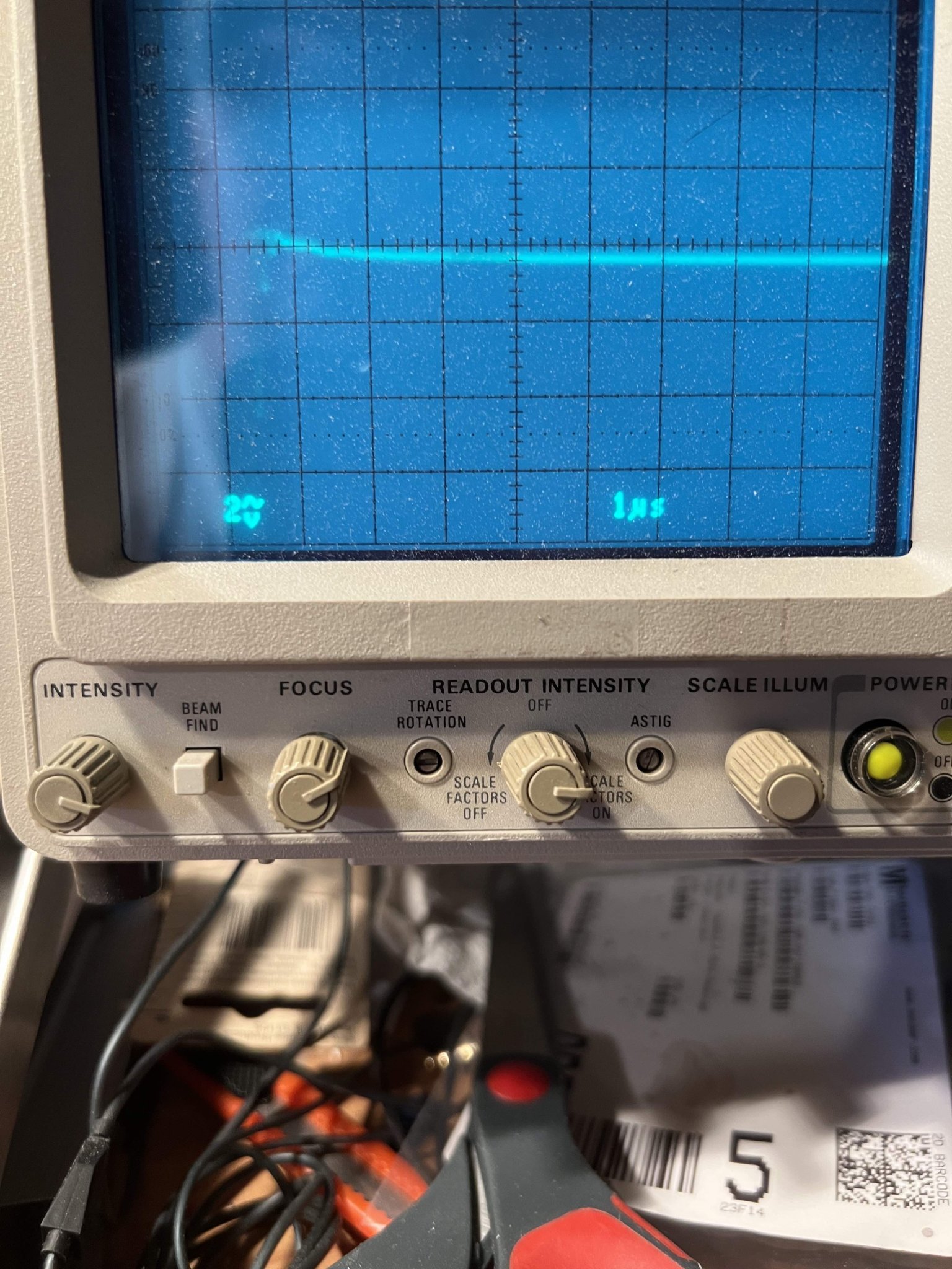

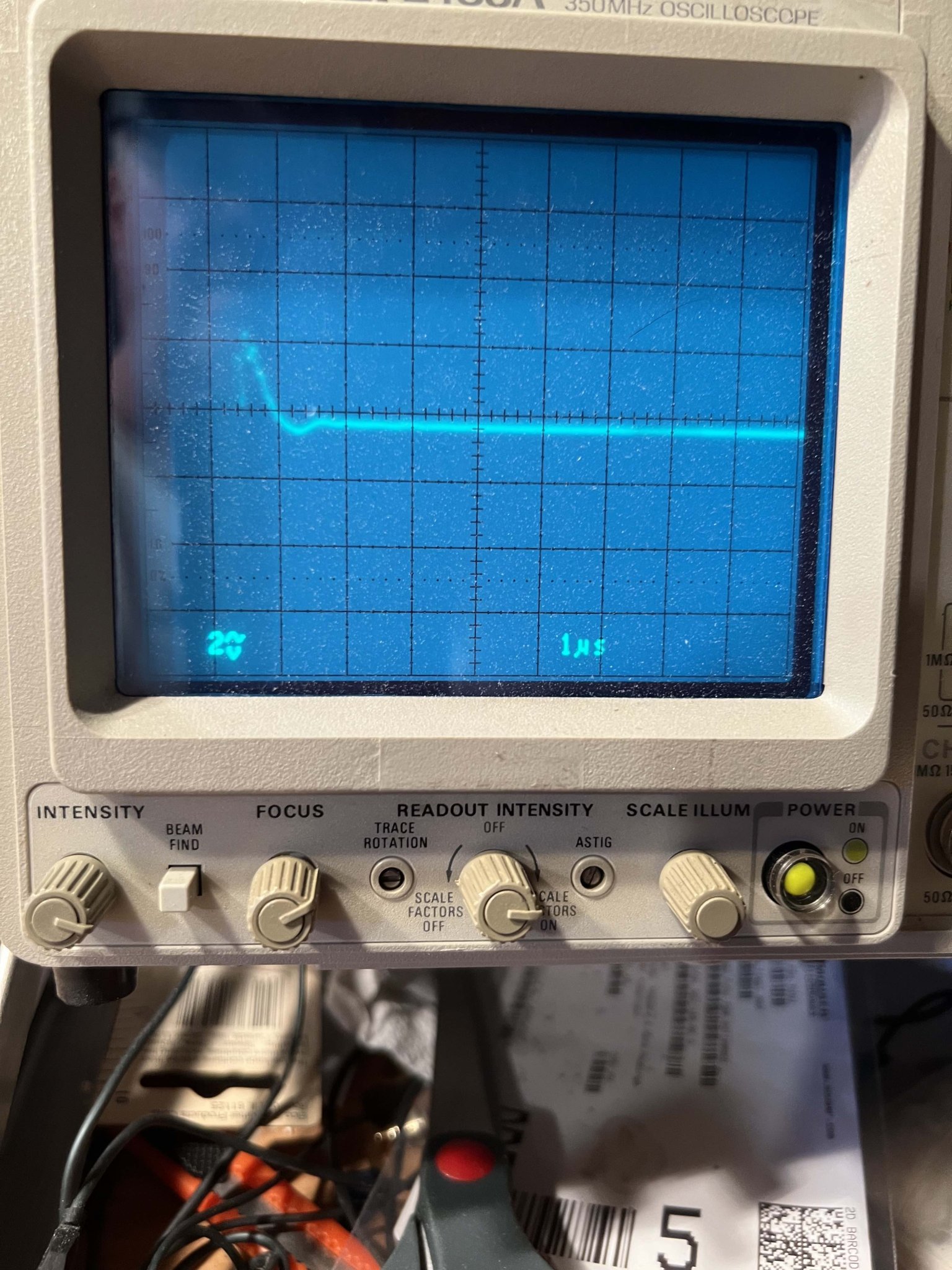

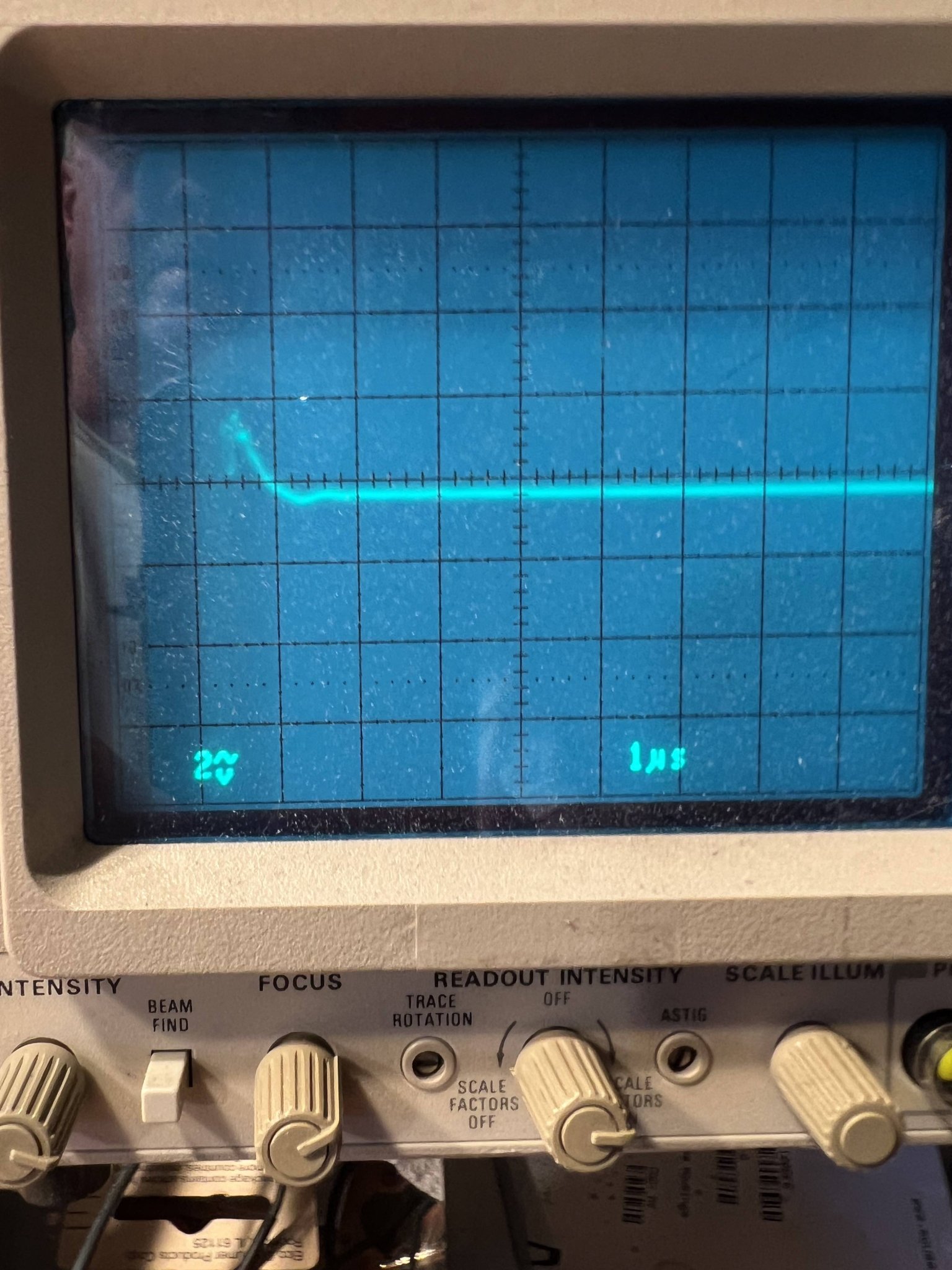

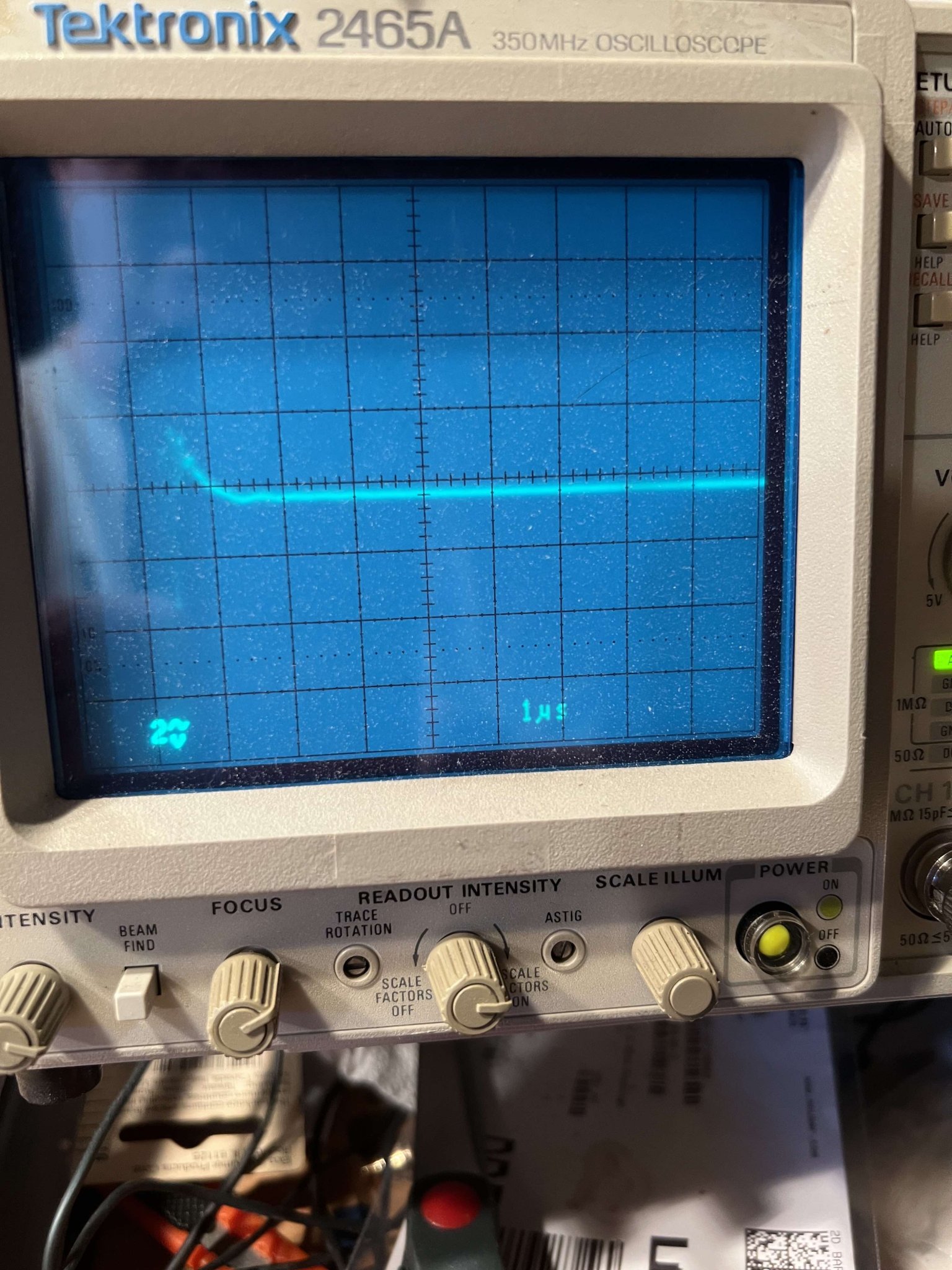

Back to running a few more tests. The first set of 3 pics is an 8V secondary, using 12R, 15R and 20R. The 2nd set of 3 is one of the 24V secondaries at the same resistances.
I think I will use 15R for the 8V secondaries, and 20R for the 24V secondaries.

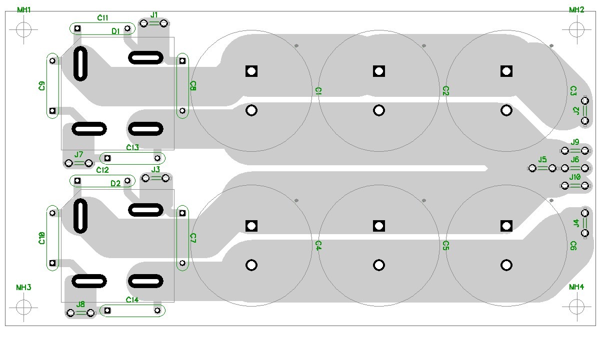

I have a question please, how is snubbing affected by the practice of putting "snubbing" capacitors across the diodes of the bridge rectifier?
In the PCB below the conventional arrangement, found in any number of power amps I have looked in, of a capacitor across each diode of the bridge.
For the purposes of adding a proper snubber, do I remove these and proceed as per figure 13 on Mark Johnson's paper in the OP or do one add a snubber on top of those caps?
If the latter, does the value of those individual diode caps add to the Crectifier for the purposes of sizing the other caps?
My personal preference would be to leave them out. Or if they are present, to remove them. If you decide to include and not remove those four capacitors, notice that each capacitor is in parallel with a rectifier. So you can calculate Crectifier_effective = (Crectifier + C_parallel) and then apply the Quasimodo design note, page 7, paragraph 3.
Thank you Mark, I thought that was case and hence can see why you would recommend removing the rectifier capacitors entirely.

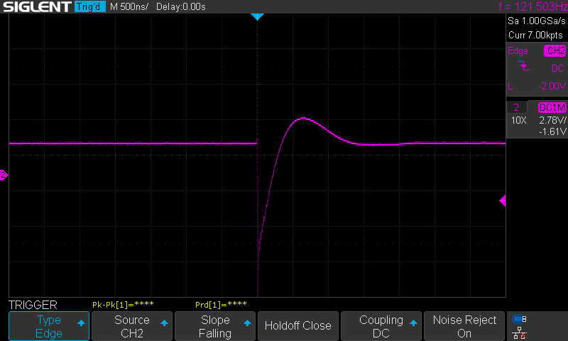

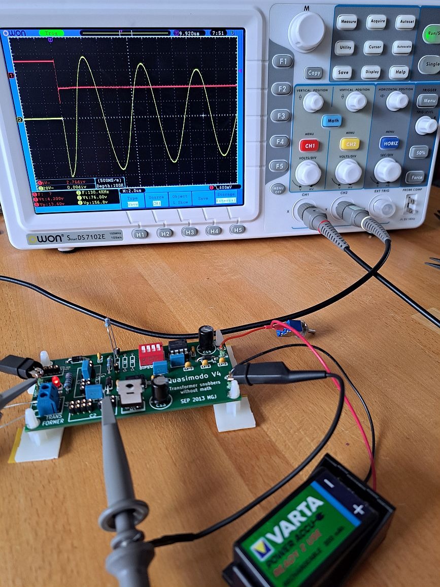

So, another Quasimodo has seen the light of day. Tested with a 150 uH inductor the measured oscillation frequency was about spot-on with the predicted frequency: 130.4 kHz. The measured resistance to dampen it was somewhat higher than predicted: 78R in stead of 61R. But some wiggle room in what exactly is the right Zeta=1 waveform, so I trust mine is working as it should.

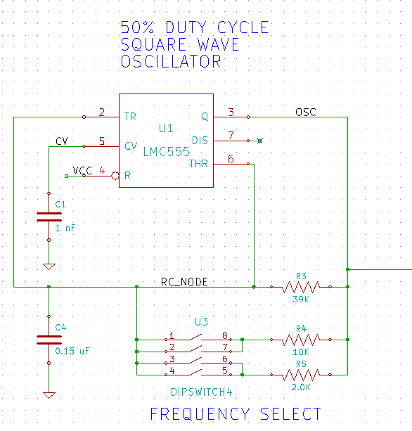

The next thing I wanted to test was if it matters whether the output signal is set for 50Hz mains frequency or 60Hz. From previous discussions about this topic I thought I already knew the answer (no, it doesn't matter) but I thought it was fun to test it anyway. So I started with the default R3= 39k and measured a transformer and dialed in a Zeta=1 waveform. Then I changed R3 for 47k5 (50Hz), 8k25 (about 5x) and 2k (about 25x) resistors and observed the waveform with the same Rs still in place. And it stayed exactly the same. So, the frequency of striking the bell does not influence the outcome for the snubber resistor needed to dampen the transformer ringing. I then chose R3, 4 and 5 values for 50Hz mains frequency and soldered them in. But I could have gone for the stock values just as well.

Quasimodo gives the same answer whether the bell ringing repetition rate is 17 times per second, 50 times per second, 60 times per second, 87 times per second, or 1138 times per second. You can verify this yourself by trying all four of the different frequencies which the DIPswitch on V4 Quasimodo selects.
(assuming perfectly accurate resistors and capacitors, the V4 DIPswitch offers: 122 Hz , 598 Hz , 2500 Hz , 2980 Hz)
This 24-to-1 frequency range allows DIYers to use old, analog, CRT scopes with Quasimodo and still get a reasonable (electron beam-on versus beam-off) duty cycle, so the trace is visible on the CRT face without needing to extinguish the room lights.
Changing resistors and/or capacitors to achieve exactly 50 Hertz for the bell ringing repetition rate, certainly does no harm. It also offers no benefit.
