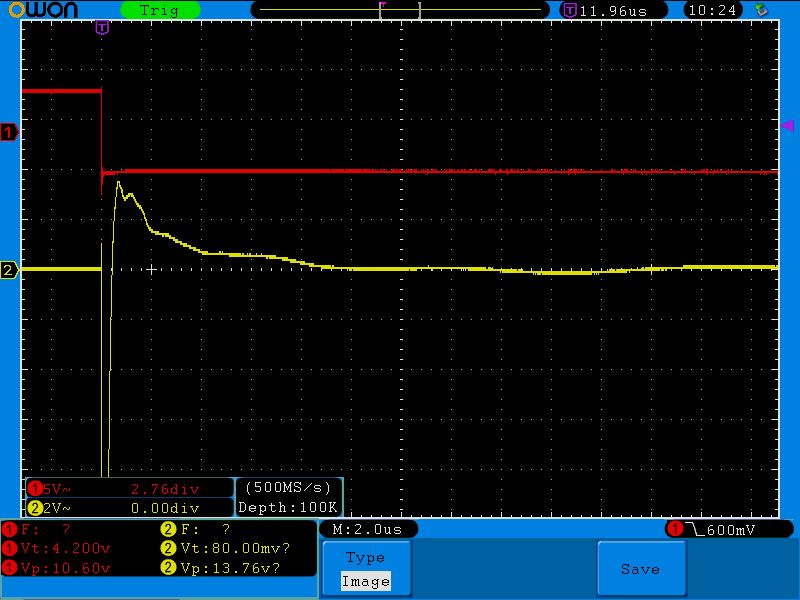

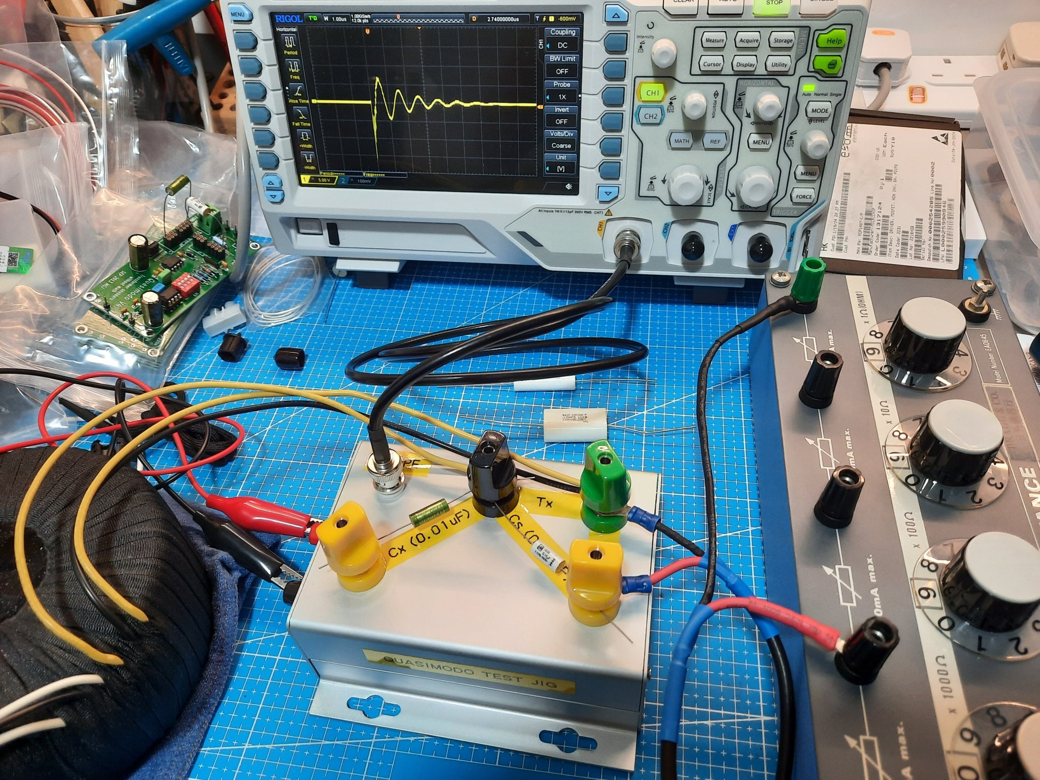

Today I measured another transformer (Block RTE40 230V, 2x15V 40VA). Question to the experts: which of the following 2 inmages looks more like a Zeta=1 damped waveform? The first one is with Rs = 33R5, the second one with Rs = 15R4. Unfortunately the vertical scale is different (should mind that the next time), first one is 5V/div, second one 2V/div.
33R5
15R4
33R5 has just a tiny dip/hump left (30R will probably make that go away). Second one takes some time to settle down and looks more irregular.
33R5
15R4
Anyway, you can redo your testing with both scales set the same for easier examination?

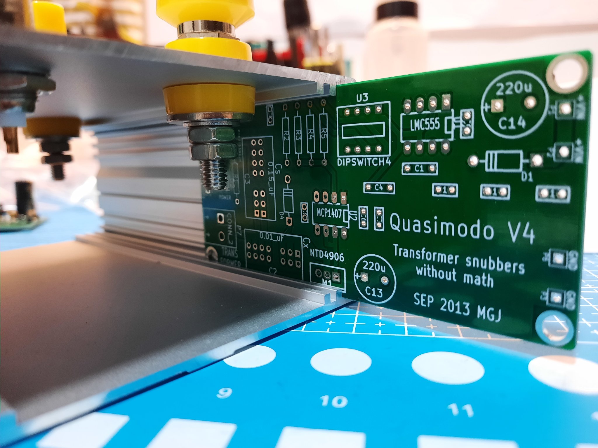

Glad I built 2 of these - my first one decided to produce strange signals resulting in gibberish. Second one to the rescue!
Search thread titles for Cheapomodo ; it's a reduced parts count version that goes together in an hour on a piece of veroboard / stripboard . Very inexpensive backup unit, and/or a loaner for audio buddies too lazy to build a Quasimodo of their own.

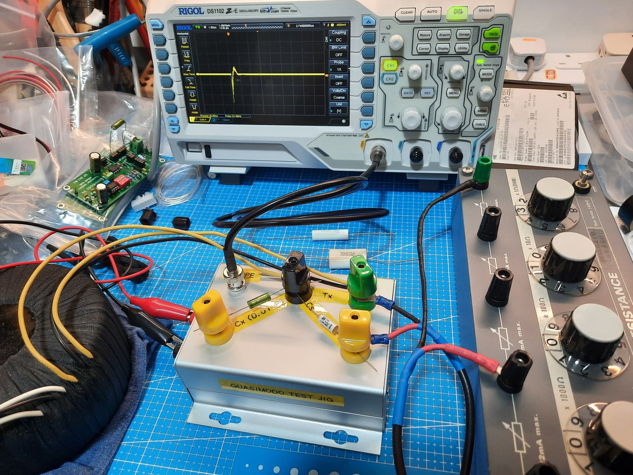

Finally completed this “Quasimodo”. Though there were some problems during the building stage but were solved and now in service condition.
I would like to say thank you to Mark Johnson for the contribution so that I can have this tool for my on-going DIY projects.
