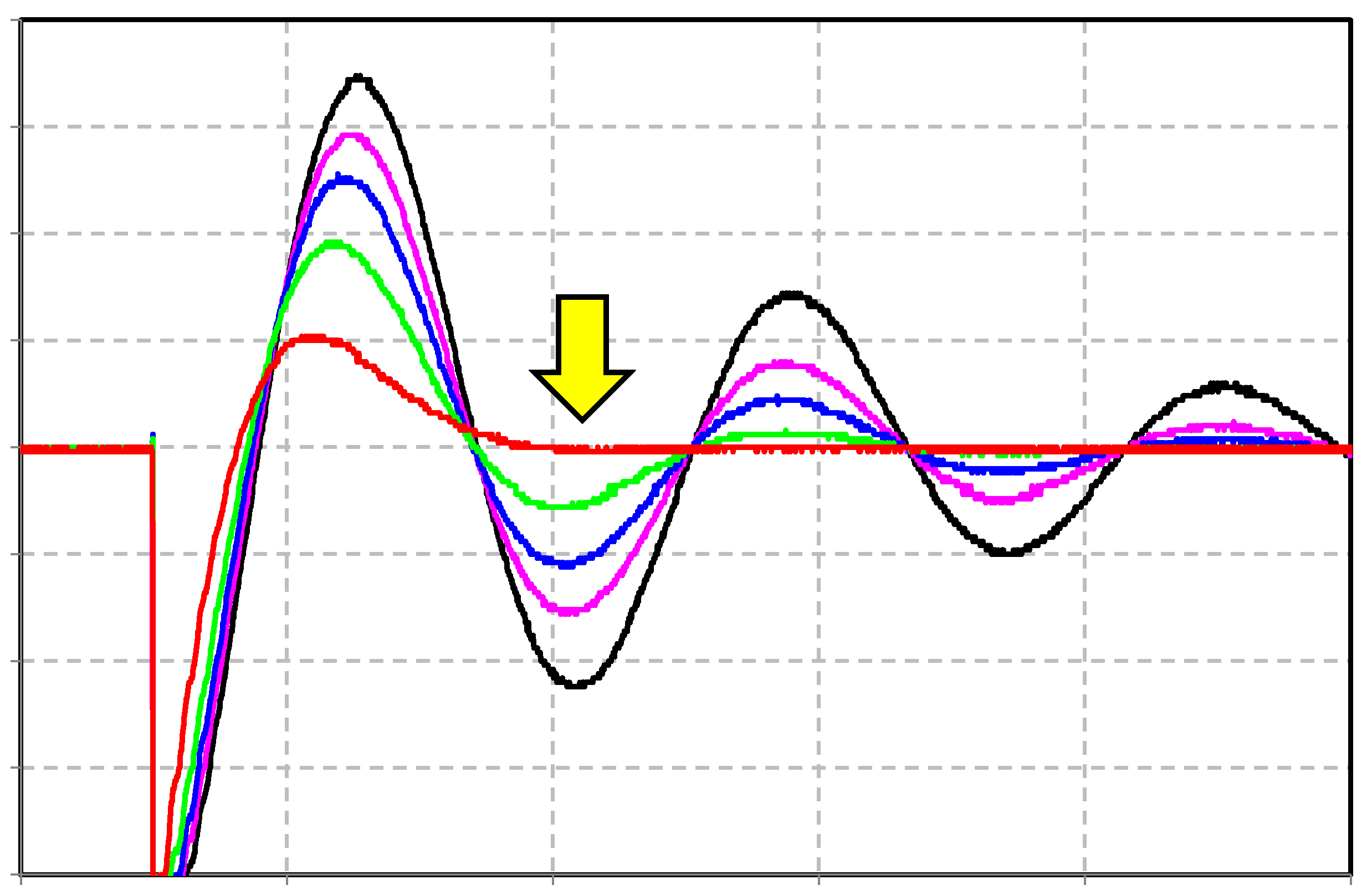

I feel like I must be doing something wrong which is entirely possible as this is first use of my new and first scope. For a 160Va Triad Magnetics transformer, dual primary configured for 230V operation, 2 x 15V wired in parallel (10.66A @ 15V) I am getting a Rs figure of 13.5 Ohms.
I'm getting the right looking wave forms on both channel 1 and 2. Trigger settings are edge and trailing (down arrow). Everything looks right except the answer is nothing like anyone's that I've seen posted here.

Move your #2 trace down on the screen and the #1trace up and you will see things better.
The blue trace looks very much like a teeny-bit damped result. You can adjust the pot and make it show whatever you like - ringing, damped, overdamped, etc...
Hi. I actually turn channel 1 display off when tuning the resistor. So it's easy to see the blue ch 2 trace. I'm just surprised my Rs values are in the order of a 10th of everything I've seen posted here.

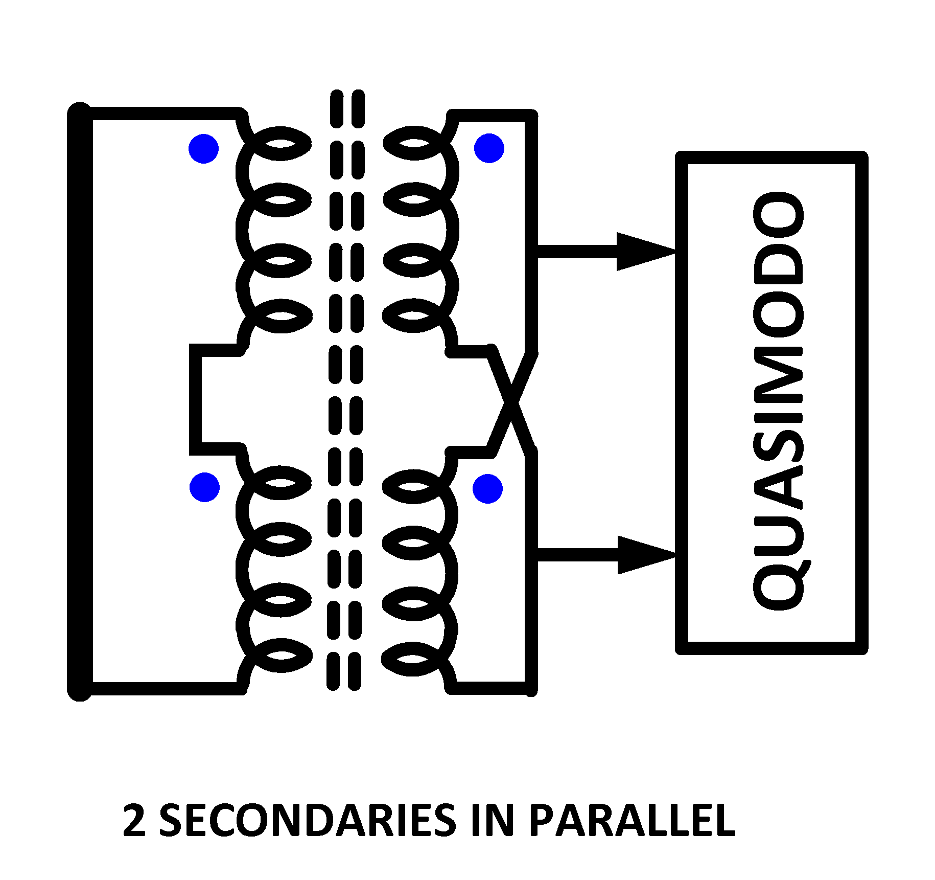

Connecting two secondaries in parallel will reduce inductance by a factor of 2, compared to operating the secondaries independently. As Quasimodo equation A.11 reminds you, the optimum snubber resistance is proportional to sqrt(Lsec); so the parallel connection reduces Rs by a factor of sqrt(2) = 1.414.I feel like I must be doing something wrong which is entirely possible as this is first use of my new and first scope. For a 160Va Triad Magnetics transformer, dual primary configured for 230V operation, 2 x 15V wired in parallel (10.66A @ 15V) I am getting a Rs figure of 13.5 Ohms.
But I suspect a more likely explanation is: operator error. I think you have accidentally zoomed-in WAAAY too closely and are failing to see the big picture. I suggest that you snap a series of screen capture images just like the ones in (Post #143), showing your progress as you gradually dial the resistance down, and as you gradually sneak up on zeta=1.00.
Carefully note: the horizontal scale of the scope pictures in post 143 is 10 usec/division. Your scope photo seems to have been snapped at 1 usec/division ... i.e. your sweep was 10X too fast!
Remove Rs from its socket and adjust the horizontal sweep until you see 2.5 to 5.0 full sinusoidal periods of oscillation. You are trying to duplicate the first image in post 143. Snap photo #1. Now leave the sweep rate alone! Set Rs for its maximum possible resistance (~1K), put it in its socket, and snap photo#2. Keep dialling Rs down and taking photos, until the waveform's first sinusoidal trough flat-lines (yellow arrow in attachment). Leave the sweep rate alone! Check to see if you still read 13.5 ohms; I'm guessing you won't.
While you're checking for operator error, make sure you've actually plugged Cx=0.01uF and Cs=0.15uF into their sockets. Also make sure you have NOT accidentally selected "Bandwidth Limit" on either scope channel. Make sure you've switched the little switch on your probes to 10X, and make sure to tell your vertical channels the probes are 10X. An easy way to check this is with the probe calibrator on the lower right of the scope front panel. It ought to be about 2 volts, not 0.2v and not 20v.
User error could be a distinct possibility!
Ok i was using the scope and probes on 1x and, yes, I had zoomed in but I had not missed the bigger picture. Here's infinity, 134R, 34.2R, 23.5R and 12.2R.
If the transformer with dual secondaries is wired as a centre tapped, does a single R+C snubber across the ~~ of the single bridge rectifier work as well as the snubbed dual secondaries?
I have not yet tested a C.T. transformer, but I will, and report back with my findings. It's worth reading Mark's documentation, where he points out that a C.T transformer still needs two snubbers;
(from the manual)The center tapped transformer (5th row) connects to the downstream power supply at three circuit nodes. It needs two snubbers: a first snubber between the top winding and the center-tap; and a second snubber between the bottom winding and the center tap.

Kudos for taking the measurements again and showing the results. They still look and feel wrong to me, severely wrong; so perhaps this will be a learning experience that gives me a Eureka Moment. Meanwhile would you please post the exact model number of the Triad 160VA transformer; I think I may want to purchase one that exactly matches yours, and duplicate your QM results that look and feel so severely wrong.User error could be a distinct possibility!
Please don't be insulted when I ask: did you verify the transformer's phase dots (Quasimodo design note Appendix D)? If you accidentally connected the primaries OR the secondaries with the phase dots wrong, the measured results will be unreliable. For a transformer with primaries in series (230VAC) and secondaries in parallel, the proper connection is shown below.
