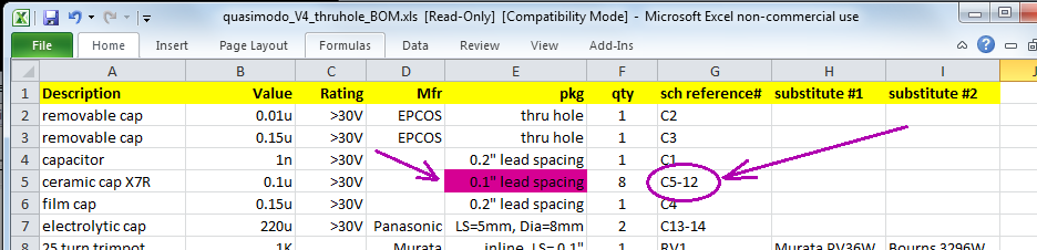

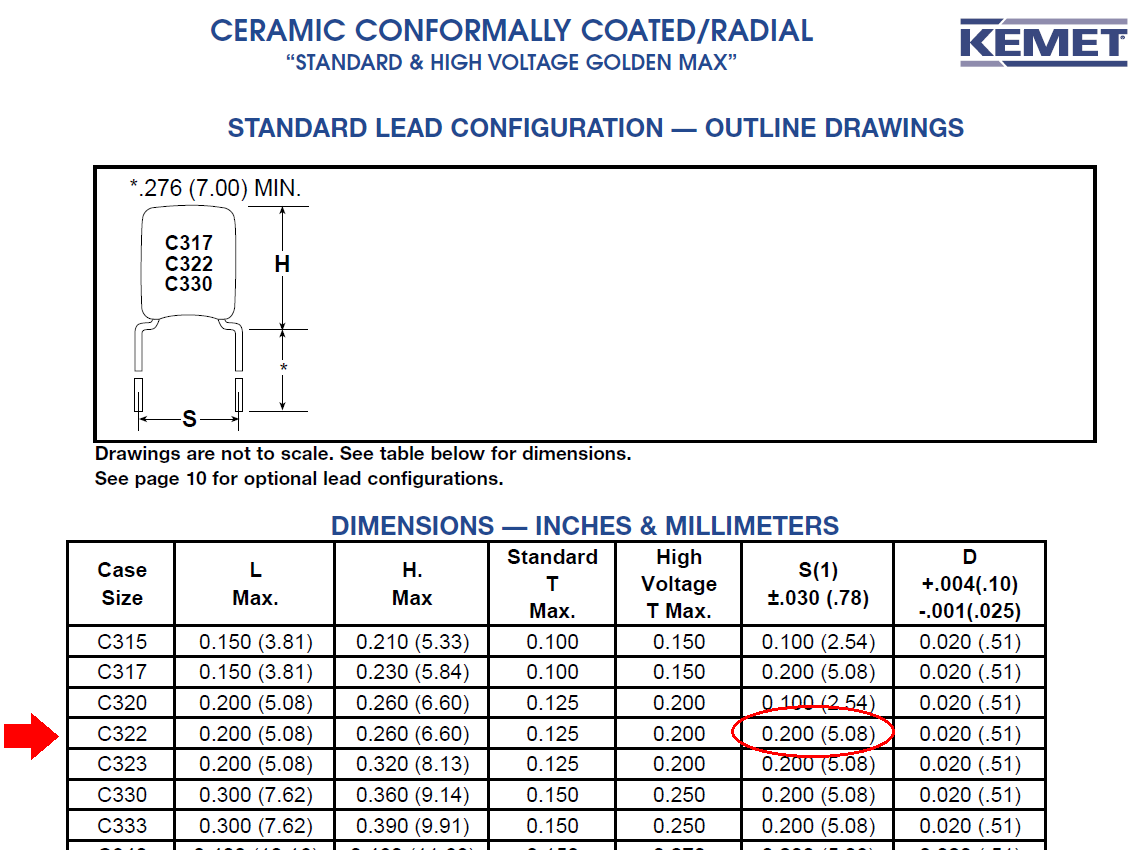

The first item of your Bill of Materials appears to be incorrect:
I didn't look at any of the others.
You will need to double-check your BOM against the Quasimodo V4 BOM. Since you also have a PCB in your possession, you can check your BOM against the board itself, for component size and pinout verification.
This one is OK Compre Condensadores Cermicos Multicapa Radial Capacitor X7R 100V 100nF 0% Murata RPER72A104K3S1C07A en RS Online y lo recibir en 24 horas.?
The rest of BOM is OK?
