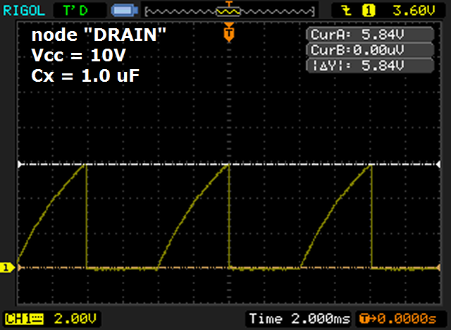

For what it is worth I also came up with a relatively low impedance value also.
It was 25 ohms. Details, a 1KVA plitron 55-0-55 with dual primaries. The bridge rectifiers had 0.1uF across all four diodes so I used a 1uF capacitor in the snubber. Sorry no photos, my scope is an old CRT unit and barely visible to the naked eye!!! Time to bite the bullet and buy a new scope.
... so I used a 1uF capacitor in the snubber.
Yikes! If your injection capacitor Cx = 1 uF then the 4.7k drain pullup resistor "R2" won't be able to charge Cx all the way up to VCC. The available time is half of a 120Hz period, namely 4.16 milliseconds. Your RC timeconstant is 4.7 milliseconds, so your bellringer won't drive full amplitude bings and bongs into your bell (secondary). The damping will be correct and Quasimodo will still give you an optimum Rsnub, but you'll be using runt pulses. Eeeww.
You also won't be able to take advantage of the special feature I put into V4, just to help out folks whose analog scopes produce dim traces in Quasimodo experiments. It's a darn shame.

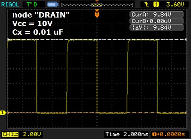

... what do you mean by a "runt pulse"? I'll assume you mean the lack of full charge, or in another words a Quasimodo who is too small to pull the bell rope all the way down. More like a ding-a-ling than a ding-dong Said it before, but I love your approach, extremely helpful.

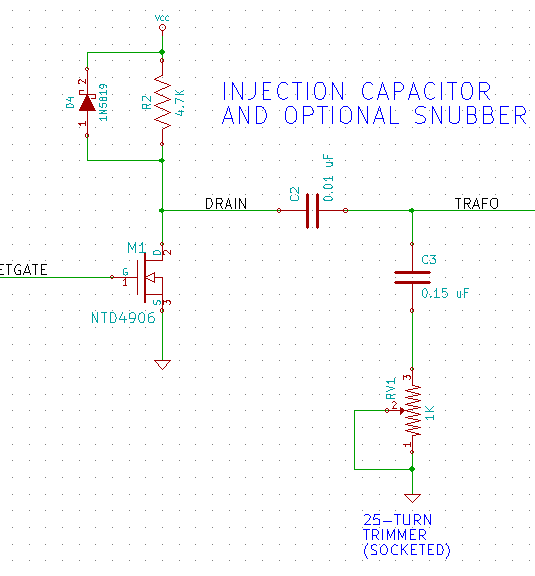

Mike, put the Quasimodo pulse generator's output (node "DRAIN" in the schematic attached to post #1) on your oscilloscope. When Cx = 0.01 microfarads, the 4.7K pullup resistor has plenty of time to pull node DRAIN all the way to Vcc. When Cx = 1.0 microfarads, node DRAIN doesn't get all the way to Vcc and your pulses, they are runts. Photos below.
A quick and ugly kludge workaround is to reduce the pullup resistance, by temporarily tack-soldering a 1K resistor in parallel with the 4.7K R2. Leave this temporary resistor's leads at least 2cm long, so you'll have an easy time removing it later. OF COURSE reducing this resistance increases the power consumption of Quasimodo --- so if you're running Quasimodo off a 9V battery, be 5X more careful than before. You may find it easier to attach this resistor to diode D4 instead of R2. Consult the schematic; both are equally good.

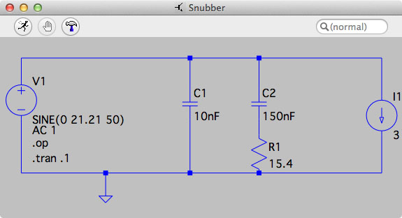

Apologies for all the basic questions. Does my Spice modelling make sense (regardless of the optimal resister value)? I'm still trying to get my head around why so little current passes through the resister.
The impedance of the {capacitor + resistor} is what the Source Voltage tries to send current through.
Calculate the impedance of the capacitor at your oscillation frequency.
Add the ESR and the resistor to find the real resistance.
Combined impedance = sqrt[ (cap Z)^2 + (ESR+R)^2 ]

I see no Member has corrected my calculation in post271.
Does that mean I finally got a bit of AC understanding right?
Hihi, too complicated formula 😛
ESR for 10nF film cap is few miliOhms, capacitive reactance is 159,155 KiloOhms @ 100Hz, therefore ESR can be left out for simplification.
Actually I owe Andrew a lot more. This little sub-discussion led to one of these classic "penny-drop" moments where suddenly my understanding of basic Ohm's law, generalised Ohms law, capacitor reactance, frequency filtering via capacitors and more suddenly suddenly took a big leap forward with a big "ah".
But, can I check the following? For a simple RC component, isn't the capacitor's reactance in series with its ESR and the resistance of the resistor and so the total impedance is simply their sum(Z= Zc + ESRc + R)? With Zc = 1/(j.2.Pi.f.C) a very small cap (0.15uF) means the reactance of the cap dominates total Z at 50Hz which is large and I=V/Z implies very little current. Is this correct? If the ESR=0 and R=0, the current across the cap (ignoring phase) would be V/Zc = 2.Pi.f.C.V = 1mA in amplitude (2x3.14x50x0.15nx15x1.414). This matches the Spice model. I need to refresh my memory on how to add the complex Zc to ESRc and R.
The (complex) current through a (complex) impedance is the (complex) voltage, divided by the (complex) impedance. Ohm's Law in complex variables.
In this case (resistor in series with nonideal capacitor), the impedance's real_part is the resistance of the snubber resistor plus the real_part of the ESR of the capacitor. The impedance's imaginary_part is (1 / (2 * pi * freq * Capacitance_in_farads)).
So it's a complex division: I = V / Z where the boldface vectors I, V, and Z are all complex numbers. The imaginary_part of the numerator is zero but the imaginary_part of the denominator is not zero. It's your decision whether to perform the calculation in polar coordinates, or in Cartesian coordinates. In this problem the polar representation requires 2 coordinate_transforms but the division is trivial. In this problem the Cartesian representation requires 1 coordinate transform but the division is quite messy. Take your choice.

Or, more simply, take the tip on pg 33 of Horowitz's The Art of Electronics and ignore phase in which case the division becomes easy.
Thanks for the references. I was just wanting to confirm that the total impedance components (cap reactance, ESR of cap and resistor) were indeed all in series and hence additive to get total impedance. I would have thought the addition of the three impedance components easier than the formula presented by Andrew but I will first go through the references posted by Mark.
(In any event, as Stormsonic noted, in this example the ESR of the cap and R are trivial and can be ignored for comprehension of the bigger picture.)
