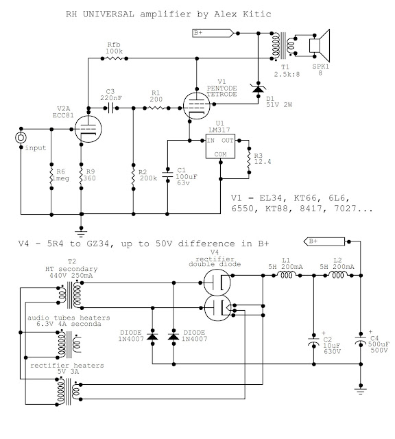

45.With reference to the Universal RH Amp.
Make V2a a pentode .......what would your math be? PS Ignore the ef182 suggestion and use your preferred. 🙂

@jhstewart9 , If the gain of the output tube hardly changes then its plate resistance hardly changes too. Hard to believe. In the original Schade paper the rp of the 6L6 becomes 2K. The driver tube has to supply the normal voltage drive + 10% of the output voltage and this means that the gain of the output tube has changed. Otherwise what would be the difference between 2 different betas? One could set beta at 1% and get all the benefits.....that seems quite unrealistic
@pl802, as originally intended that circuit can only work with those lower gain pentodes and I think that the beta, unlike Schade stated in his paper where it appears that any beta could be employed, must not exceed 10%. Not exceeding 10% will basically make the feedback factor smaller and the load on the driver tube acceptable. So, in order to get 10% or less beta, the plate resistance of the driver tube in parallel with the power tube grid resistor must be 1/9 or less respect to the feedback resistor. If one cannot get the 10% beta or less I don't think there will be a practical solution with available tubes. The value of the feedback resistor is limited by the voltage supply in the first place and the necessary anode voltage and current of the driver as well.
Millet's solutions indeed have 10% beta or slightly less but (like the RH84 as well) there is one more resistor in the mix.
The more I look at Schade feedback and the more I think that I saved A LOT of time and efforts by going down the route of cathode feedback. But in that case, the transformer has to be good. This is not a problem for me but it is in general because it will increase cost. But there are affordable solutions like Toroidys'....

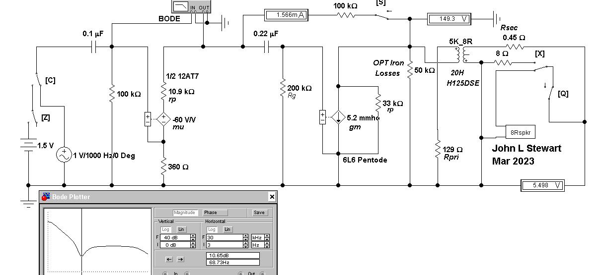

Bode Plot of the Driver Gain on an example of Alex Kitec's RH84.
Driving a Loudspeaker Simulator. The gain of the driver varies in response to the loudspeaker impedance variation.
That is not the RH84. The RH84 is like Millet's where the driver gets supply by means of standard anode resistor. Use the 6L6 with this circuit.
Besides, could you simulate the following, please?
1) disconnect the 100K fbk resistor
2) From the primary side where the plate of the output tube is connected put 27K + 27K in series across the primary.
3) Connect now the 100K resistor between the 2 resistors

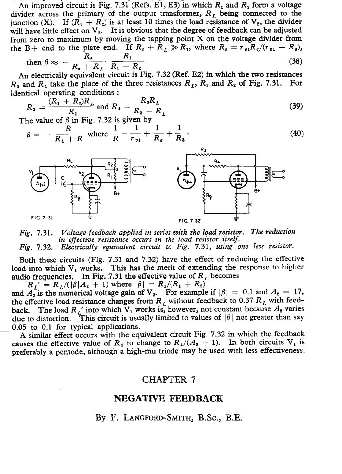

The reason why I ask is that I have just found the page below digging into this forum and it seems that my idea is that wrong about feedback ratios and effective value of feedback resistor.
So what I have just asked is what you see in 7.31. 27+27K is at least 10 times 5K and the feedback factor is lower.
The puzzling thing is that if first says that
beta= A*B
A = R/R+Rfbk (RL in the description) where R=ra//Rg
B=R1/R1+R2
Then the effective value of the feedback resistor is RL/(beta*A+1) where now beta has magically become R1/R1+R2.....
Then circuit you have just simulated in post #137 would be with R2=0 and R1>>5K, including infinite....
