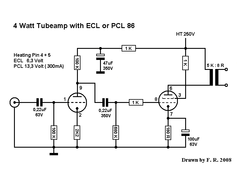

I am hoping to build a small SE valve amplifier as a project. It is my first time building an amp and I am looking for some help. I posted another thread on here relating to a similar project salvaging parts from an (sadly broken) old tape recorder. However, it turns out I have different valves than I originally though and so, I have started a fresh with a new thread. I hope this is ok. I have chosen the schematic bellow as a starting point. I have a few questions relating to the components. Non of the resistors on the diagram a wattage rating. I'm not sure how to work this out in order to order suitable resistors.
For the HT 250v I'm planning to use a boost converter and I have an LM317 Buck converter for the heater's 6.3v supply.
I understand that in order to use the DC HT supple from the boost converter with the schematic bellow, some more work be required before the 1k resistors to remove ripple.
I'm using this build which uses boost and buck converters in place of a proper mains transformer as reference
The video above it described a build which uses a boost converter for HT supply. However, he uses a different tube and so his schematic is different to the one bellow.
In his build, after the boost converter before R3 and R7 he uses 2 x 100uf 400v caps and a 390 3W resistor (for smoothing?). I am unsure whether I would need to change the values here to suit the rest of my ECL86 schematic?
I'd be really greatful for any help figuring out how to adapt this to make it work with the schematic I've posted.

The video you referenced does use the PCL82 tube; you want to use the ECL86 tube. They are very similar. The power supply section is the same, you still need the same CRC filter cell after the HT converter module to attenuate the audio frequency ripple that is common on those modules. If you want to follow that video, the only difference on the power supply section will be the filament supply. PCL82 tubes needs 16V on the filament, so they are connected in parallel. ECL86 need 6,3V so you need to connect them in series. You will then change the resistor value on the LM317 reference pin to ouptut 12.6V instead of 16V, and you need to increase the size of the heatsink because heat dissipation would be higher.

Thanks, Pcan. With regards to the resistors in the ECL86 schematic I posted, the designer didn't stipulate the wattage rating. I don't know whether the wattage rating is even relevant for this purpose and if it was, my understanding of the theory isn't good enough to work it out. Will resistors of a certain wattage be required?

I use 1W resistor on my point to point Hi-Fi builds, because they are easier to solder and I don't need to check the dissipation and the voltage rating. I like TE connectivity ROX1 Flame-Proof Power Metal Oxide Film Resistors, rated a 350V max working voltage (600V peak overload). But 0.25w are technically ok on most situations.
A primary load of 7K would be better than 5K.
The gain of this amplifier will be high so you could apply some global negative feedback (from secondary to first stage).
I'm just getting my head around negative feedback abd biasing etc. I thought I'd build it as per the schematic to start with. If I can get that working I'll feel like I've achieved something. Then I'll look at negative feedback abd maybe some tone controls etc.

A 7k output xfmr might be better than a 5k output xfmr.
True, but the amplifier certainly will not put out 4 Watts, as was proposed in Post # 1.
But not so fast . . .
If the plate swings all the way to the cathode (it can not) . . .
250V B+, and at least 5V drop in the primary
Cathode bias ~ 7V
250V - 5V -7V = 238V
((238V) squared/7000 Ohms)/2 = rms power for a sine wave (but the amp will be clipped at this signal level).
Well, for a sine wave, that would be just over 4 Watts, and the clipping would make the rms power more than 4 Watts, but it would be hard to listen to music that way.
And, I estimate that the plate might be able to swing to within 50V of the cathode, not to 0V from the cathode.
250V - 5V -7V - 50V = 188V
((188V squared)/7000/2) = 2.52 Watts
Take a typical inexpensive 7000 Ohm output transformer that has 350 Ohms primary DCR, and 8 Ohm tap that has 0.4 Ohms DCR.
That output transformer's insertion loss is 1dB (0.79 x the power that the output tube sends to the transformer primary, will come out the secondary).
2.52 Watts x 0.79 = 1.99 Watts.
2 Watt amplifier

ruffrecords,
Power supply +250V before any DC voltage drop in the output transformer DCR, and before the DC voltage drop of the self bias cathode network.
Even with no drop of B+ and self bias voltage; -250V to + 250V swing = 500V peak to peak
500V peak to peak / 2.828 = 176.8V rms.
((176.8V rms)squared)/7000 Ohms = 4.47 Watts, not a sine wave, but instead an extremely clipped waveform.
4.47Watts on a perfect day, but wait . . .
1. The tube plate voltage can not pull all the way down to the cathode voltage. Look at the zero volt grid line, and the plate to cathode voltage is not 0 volts. You will end up driving the grid very positive, have grid current, charge the coupling cap, etc.
2. The output transformer drops the 250V supply to less than 250V.
3. For a simple inexpensive amplifier, an inexpensive output transformer often has about 1 dB insertion loss; 4.47W x 0.794 = 3.55W
4. If, in spite of all the above, you could get a 4.47W sine wave, and used an output transformer that has a 0.5dB insertion loss,
4.47Watts x 0.891 = 3.98 Watts.
Purchase a Monolith Magnetics $$$ output transformer for the amplifier proposed by the original poster.
That just might push him about 10X over budget.
5. For a sine wave, 500V peak to peak is exactly the same as 250V peak. They are both 176.8Vrms.
No, I did not forget that the plate swings both up and down.

I would not dispute any of the above and i apologise for missing the fact you used peak instead of peak to peak which means of course you did not forget the plate swings above B+.
However, the originally posted design has a 5K load which gives a best case power output of 6.25W. I can believe that with a low cost output transformer and the practical swing of the output pentode that 4W might well be achievable. What the distortion would be, especially open loop as in this design, I would hesitate to say, but the typical application of an ECL86 back in the day was most likely aiming for loudness rather than quality.
Edit: However, I have fallen into my own trap of assuming the plate can swing as far as it likes when what more often than not limits output power is the available current swing. The ECL86 data sheet shows a nominal quiescent current of 36mA which is therefore the maximum peak current swing. Interestingly 7K at 250V implies a current of 35.7mA so clearly 7K is the best load to use. The (Phlips) ECL86 data sheet actually shows figures for a class A output stage operating from a 250V supply into 7K and gives the maximum output as 4W with 10% distortion. Bottom line, I agree with you.

ruffrecords,
I apologize, I am often very critical and impolite.
Thanks for your response.
An interesting detail about Post # 1 is that the Video shows a circuit that is using Schade plate to plate negative feedback.
Whereas, the original poster's own schematic on Post # 1 has no negative feedback.

Is the resistor "180 R" supposed to be 180K or is it just 180 ohms?
