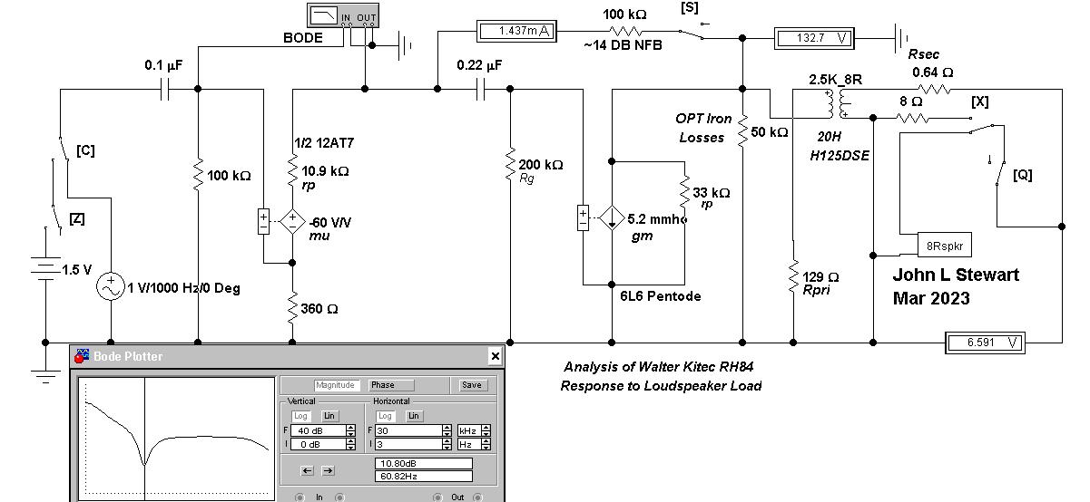

I've corrected the 6L6 load to 2.5K this time. The bottom line is still the same, the triode gain varies as the load changes.
OTOH the pentode output varies as Gm*Rl so follows the loudspeaker impedance curve.
Bode then for the pentode would be the reciprocal of the triode driver response.
A pentode as a driver is definitionally the way to go. Or drive with SS. Either way the Transimpedance Amplifier results.

An amplifier where the load changes the gain of the driver tube is a no no. Although pentode driver or transimpedance in general can works ok I will continue using my time with something better, possibly without sand....

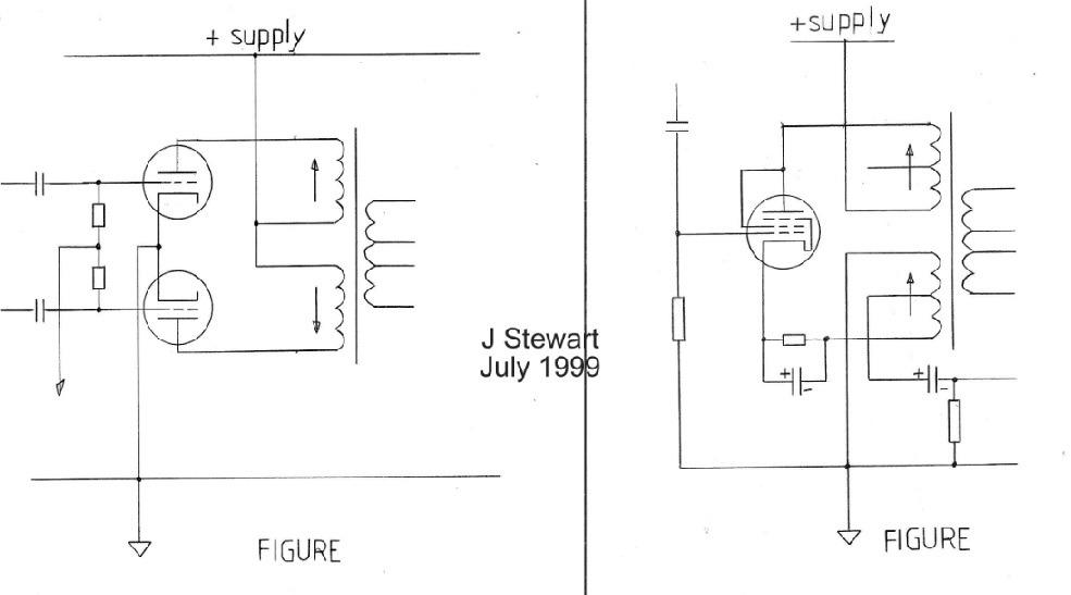

The Split Load Transformer Coupled Amplifier
In Summer of 1999 I put this experimental contraption together, a triode connected 6K6GT driving into a PP OPT with unconnected primary windings. It really needs a gapped core but I made the measurements at One KHz to get around that problem.
Later I stuffed a mu follower in front of it to get some gain. Then took some measurements & wrote a report. I sent that to ED Dell at AudioXpress magazine, the article got published June 2001.
The output lead is taken off the UL tap. With a 600 Ohm load the 6K6GT sees 12K, a very easy load for the tube. Soon after the OPT found its way into a PP 33 Amp.
