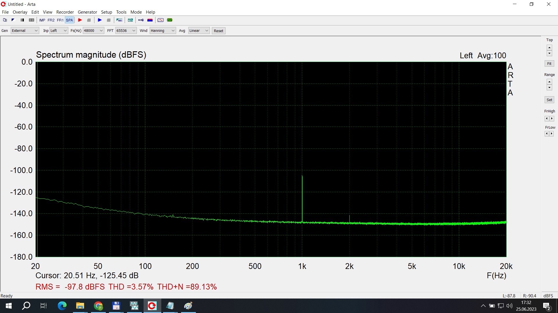

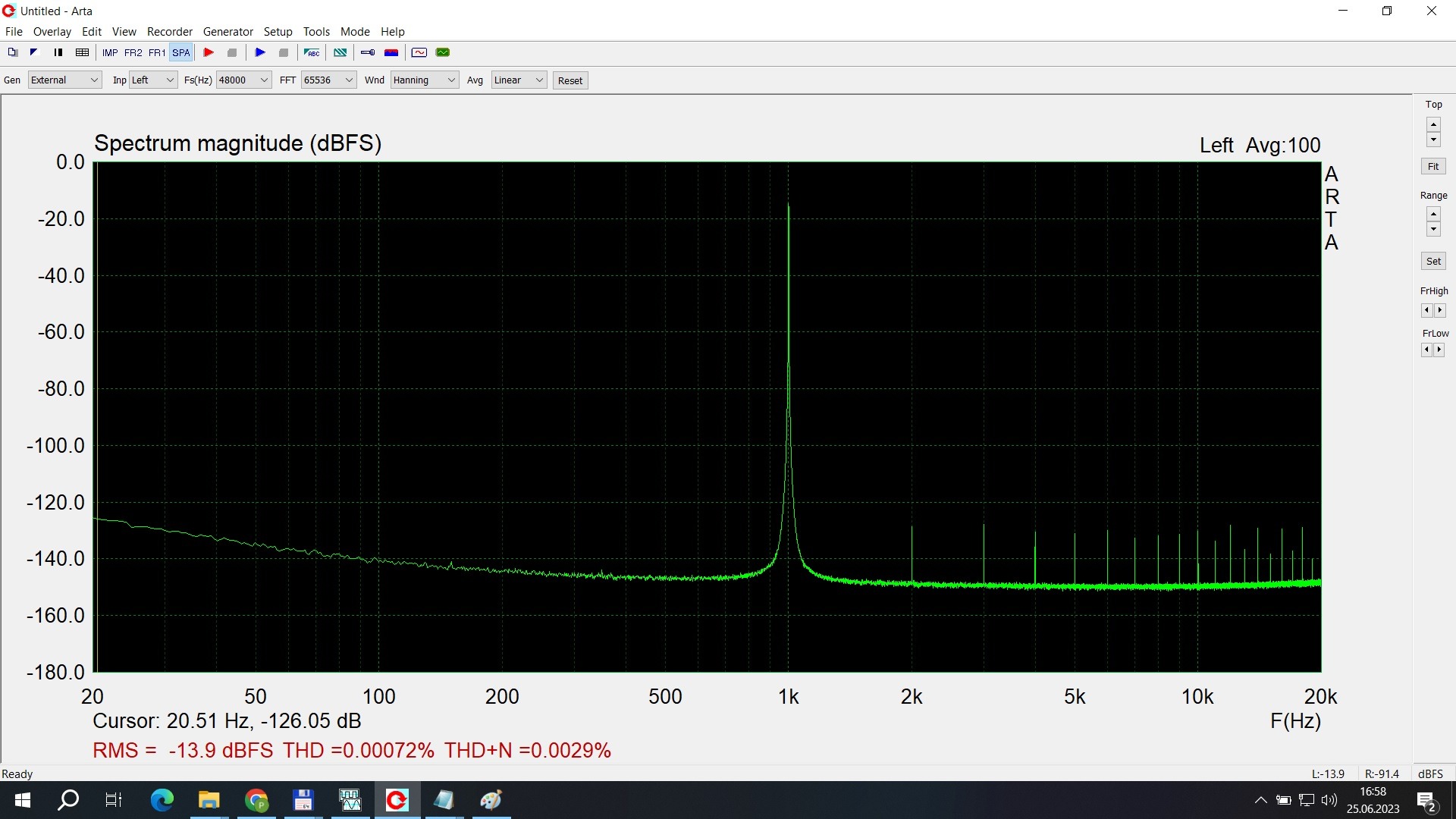

It's nice to present the new firmware.
First of all, I'd like to thank Markw4 for your help!
The entire software is practically completely new.
The first FIR filter now has x8 fixed interpolation (fs 44.1kHz - 192kHz), has 2048 taps, 32 bit coefficients and 100dB stopband attenuation.
Then it's a two-stage CIC filter and it's oversampled to the final x256. Oversampling depends on the rate of incoming data.
Then we have a 5-order sigma delta modulator, which has classical CRFB structure, with noise shaping and dithering.
And as before, at the end the dsd streams are time aligned using ODDR2 primitives.
We made tens of different firmware configurations and finally chose this version after listening sessions.
DIY use only!

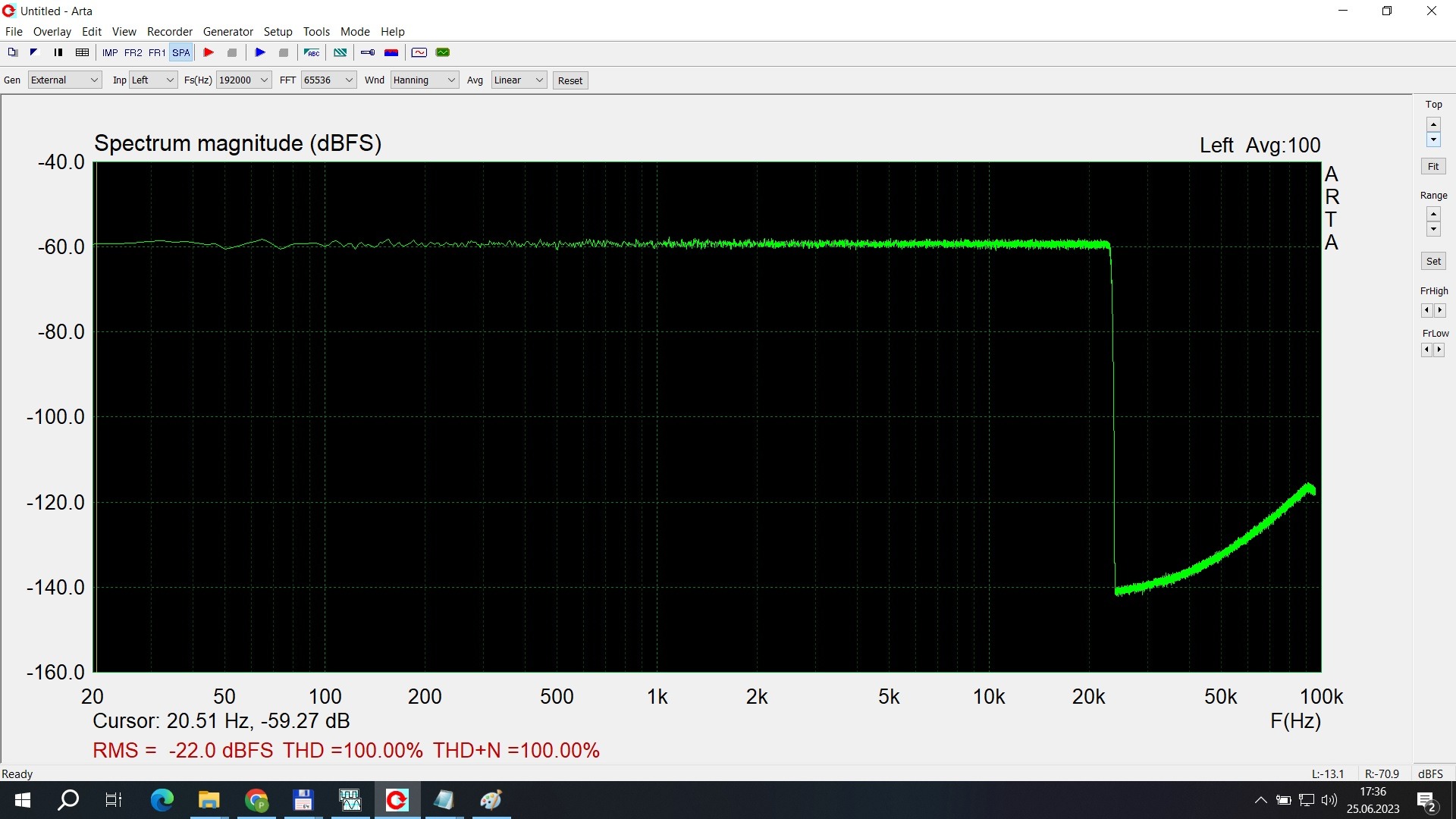

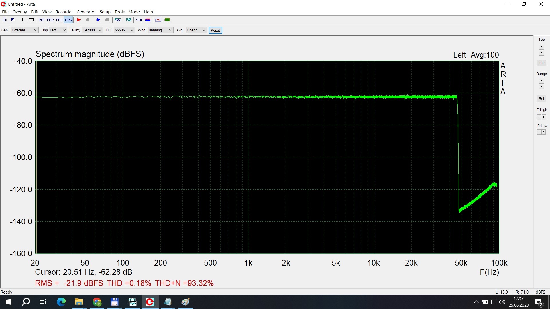

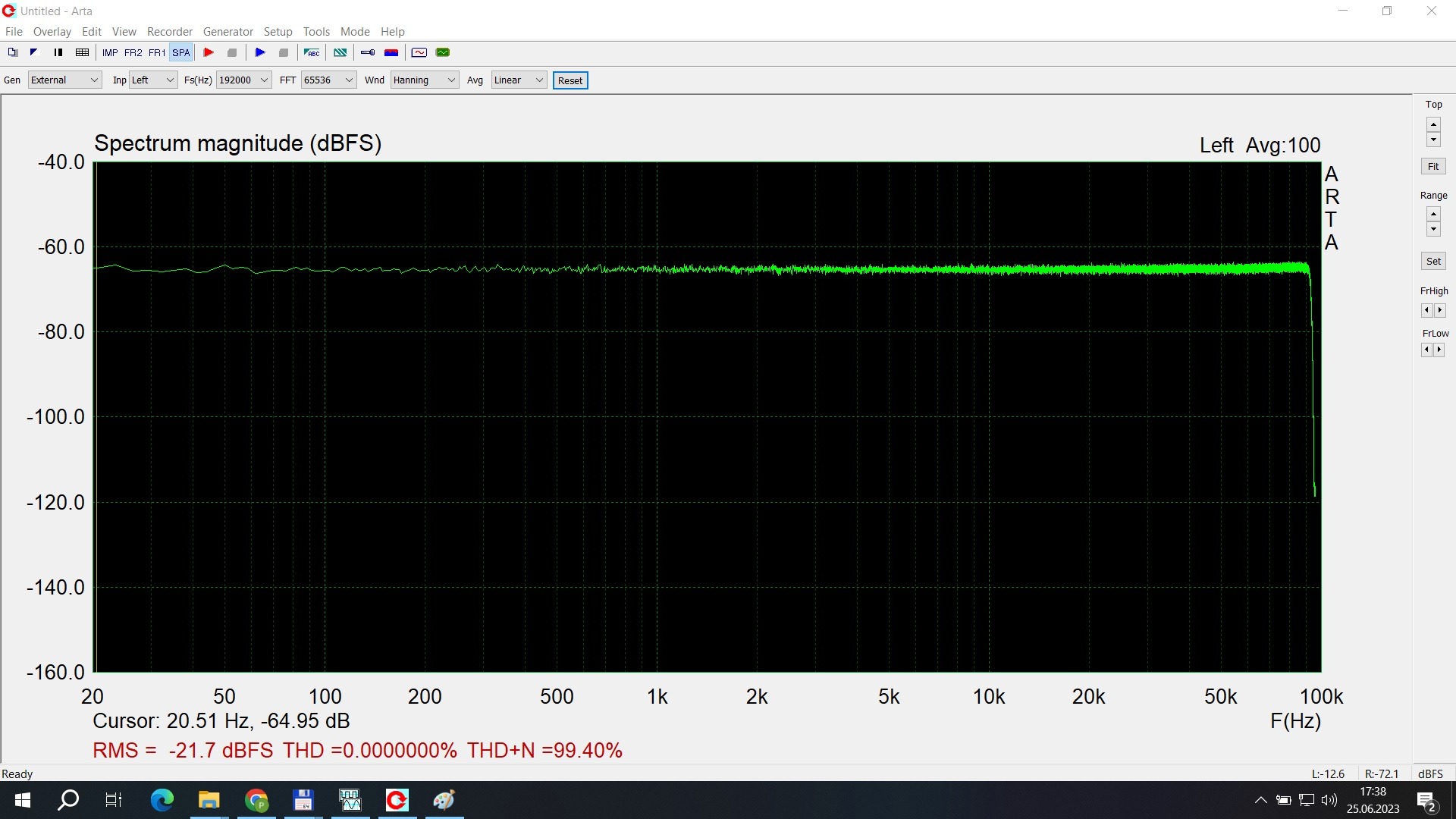

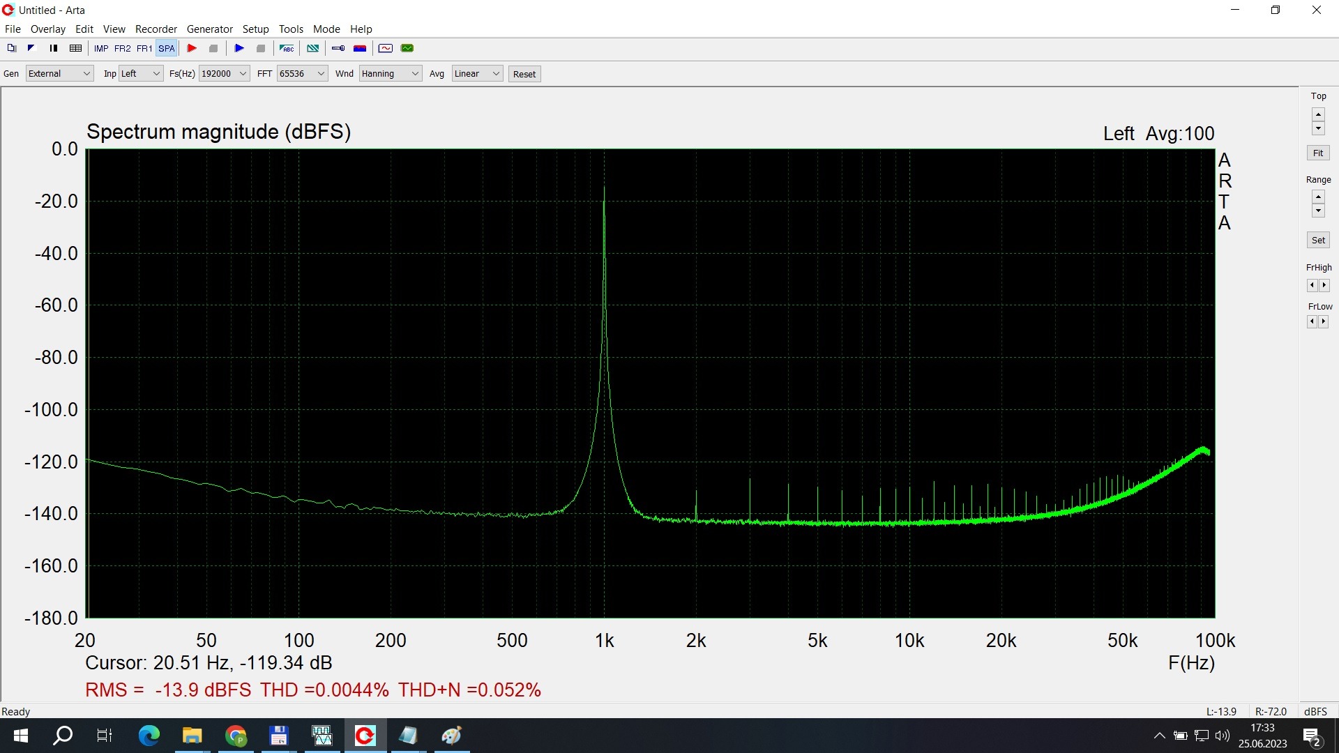

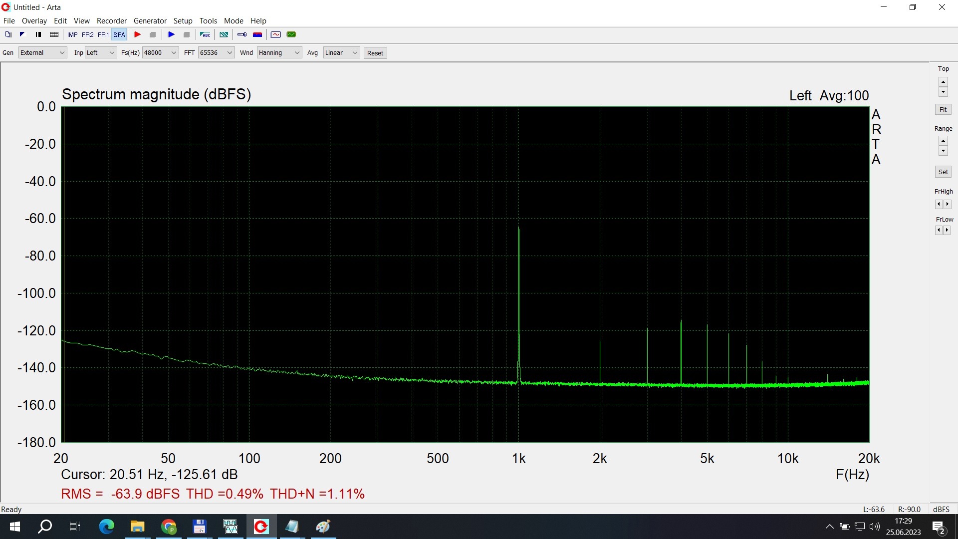

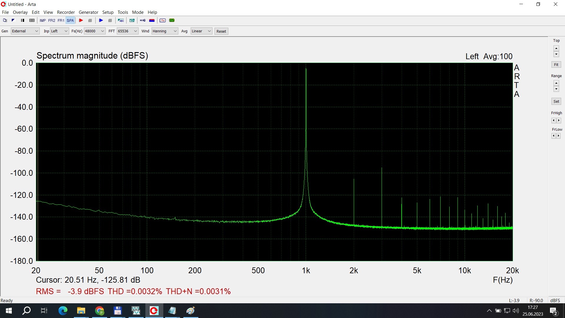

And now some measurements.
These measurements are with DSC 2.5.2
A number of prospective FPGA firmware versions were auditioned over multiple listening session. The new release version 3 was deemed overall best so far. We feel SQ is good enough that it could likely be used in a moderately high end commercial dac. Quite an accomplishment fitting it into a low-cost FPGA of that size.
When using the FPGA converter it does help to keep the PCM volume level in the computer up for best SQ (but maybe not so high as cause intersample overs). There are modern perceptual VU meters which be used to find reconstructed peak levels of wav files in order to check for intersample overs, if desired. Rather than use digital volume control, we have been using an analog line amp with volume control after the dac. Keeps the DSD converter working at its best SNR/DNR.
As always, minimizing conducted and radiated EMI/RFI, including avoiding ground loops wherever possible can make a substantial difference in terms of final SQ.
