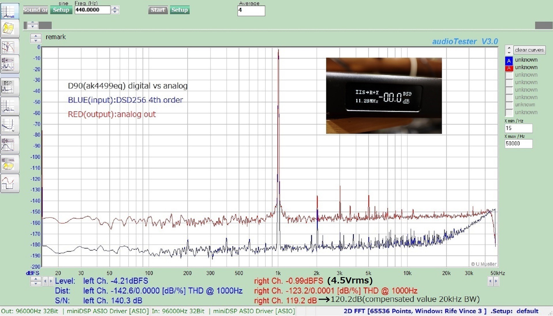

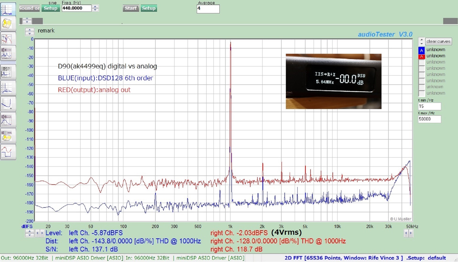

Do you consider adding HDMI output to the board for easy connection with various DACs? There are plenty of inexpensive HDMI connectors available. Since xc6slx09 has several LVDS outputs, connecting it with just a connector is possible. I am currently connecting my D90 (ak4499eq) through HDMI to verify the analog output. As DACs with HDMI inputs are becoming more common, I believe it would be a worthwhile investment.
