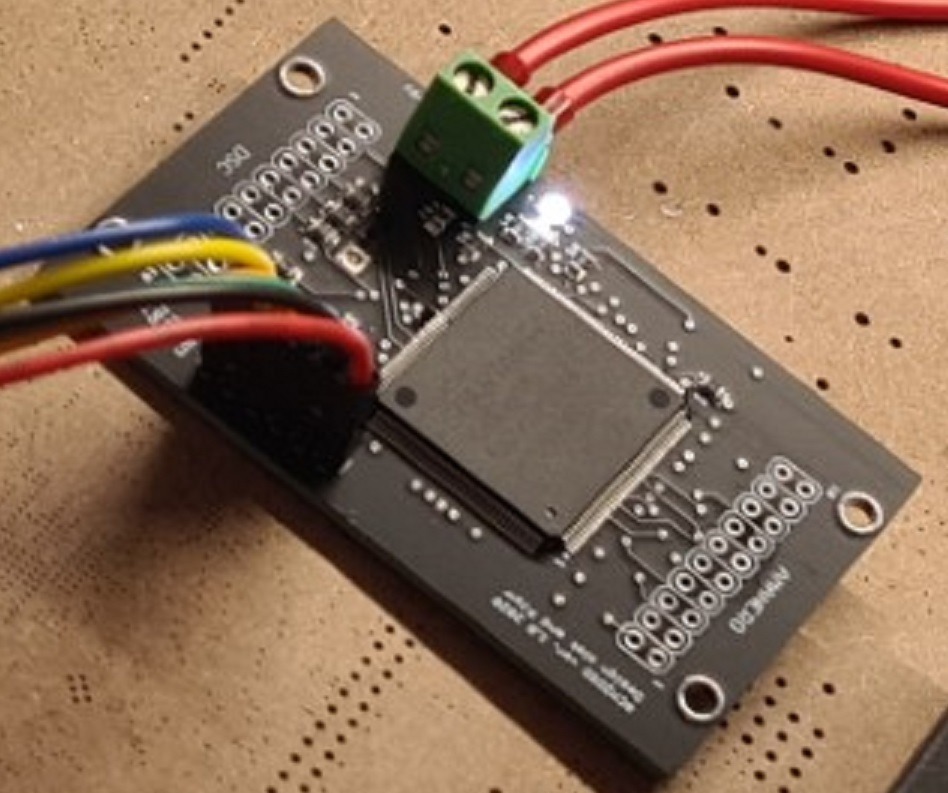

Ok but note that the LED down by the large two way connector is connected to the done pin. If it isn't on the device isn't configured. led_on.jpg
So where are we at right now, still troubleshooting?
Seems to me we were last trying to verify if PCM I2S signals were making it to the simple DSD converter board. Basically, we wanted to verify incoming LRCK, BCLK, DATA, and also MCLK. If they are good then we need to see if DSD_ON and MUTE are both working. That still in the works?

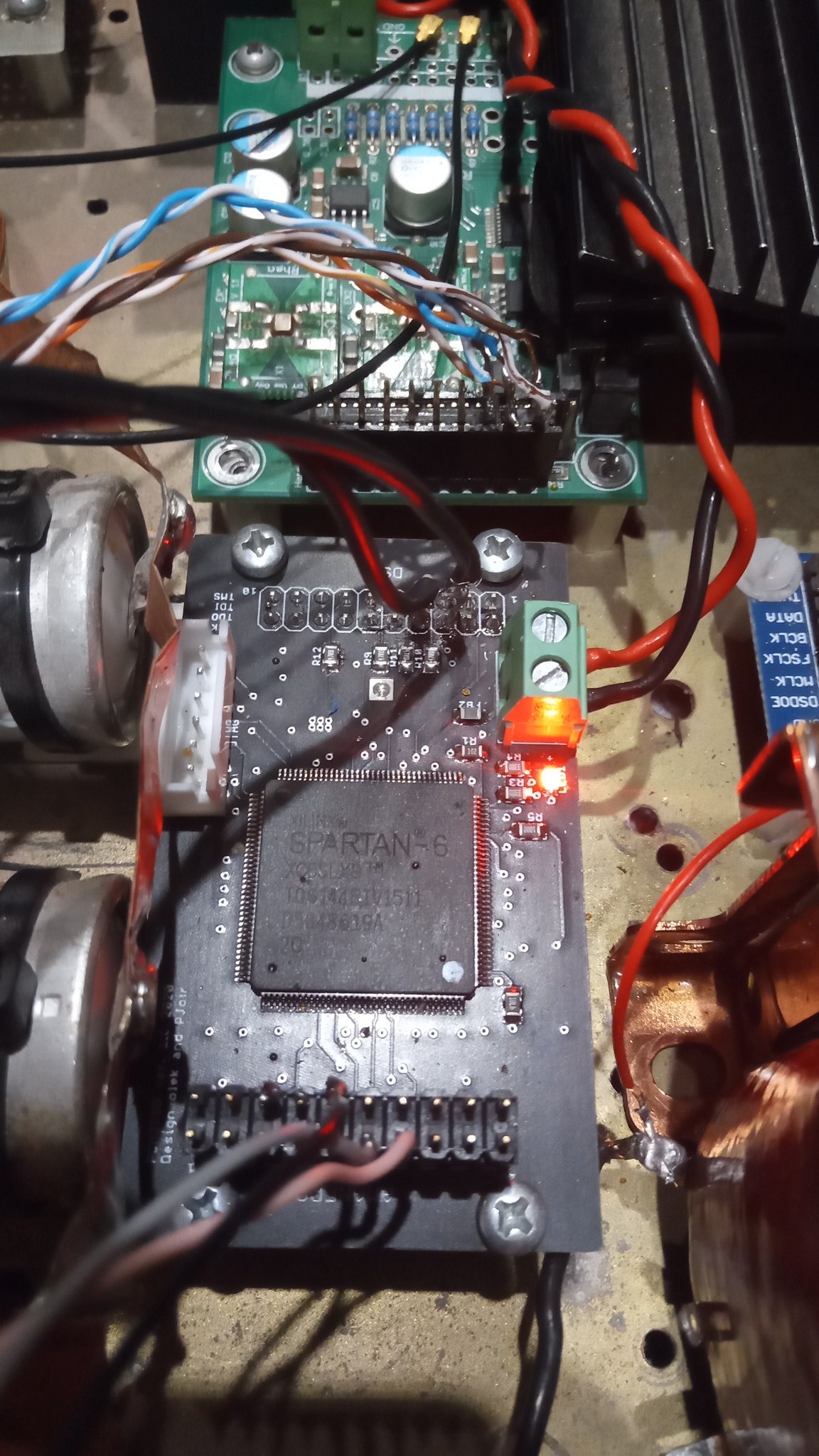

Well time passed and flashed the Amanero USB-I2S for "no slave" to feed directly the pcm2dsd without the Cronus, now I listen music without the Cronus so only the Amanero & the low pass filter. I guess If I use pcm2dsd that will be not necessary the LPF right?
