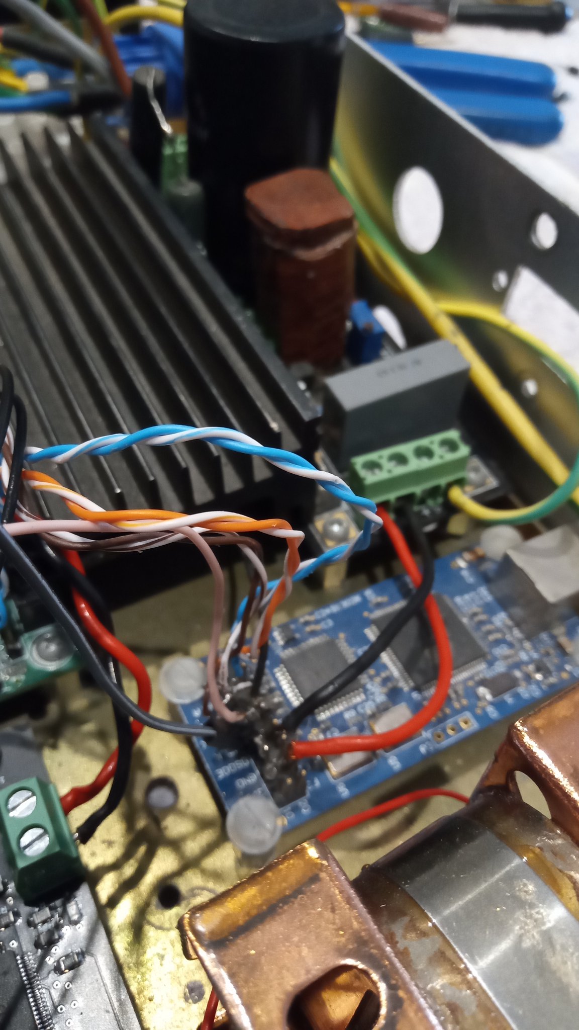

It's OK DSDON measurements?Attached pics, it seems OK

In the photo I can see that the wire is only inserted into the socket, you don't have a good connection.Isn't possible software not well loaded? How to check it?
You need to solder the wires to the PCB or to the connector.

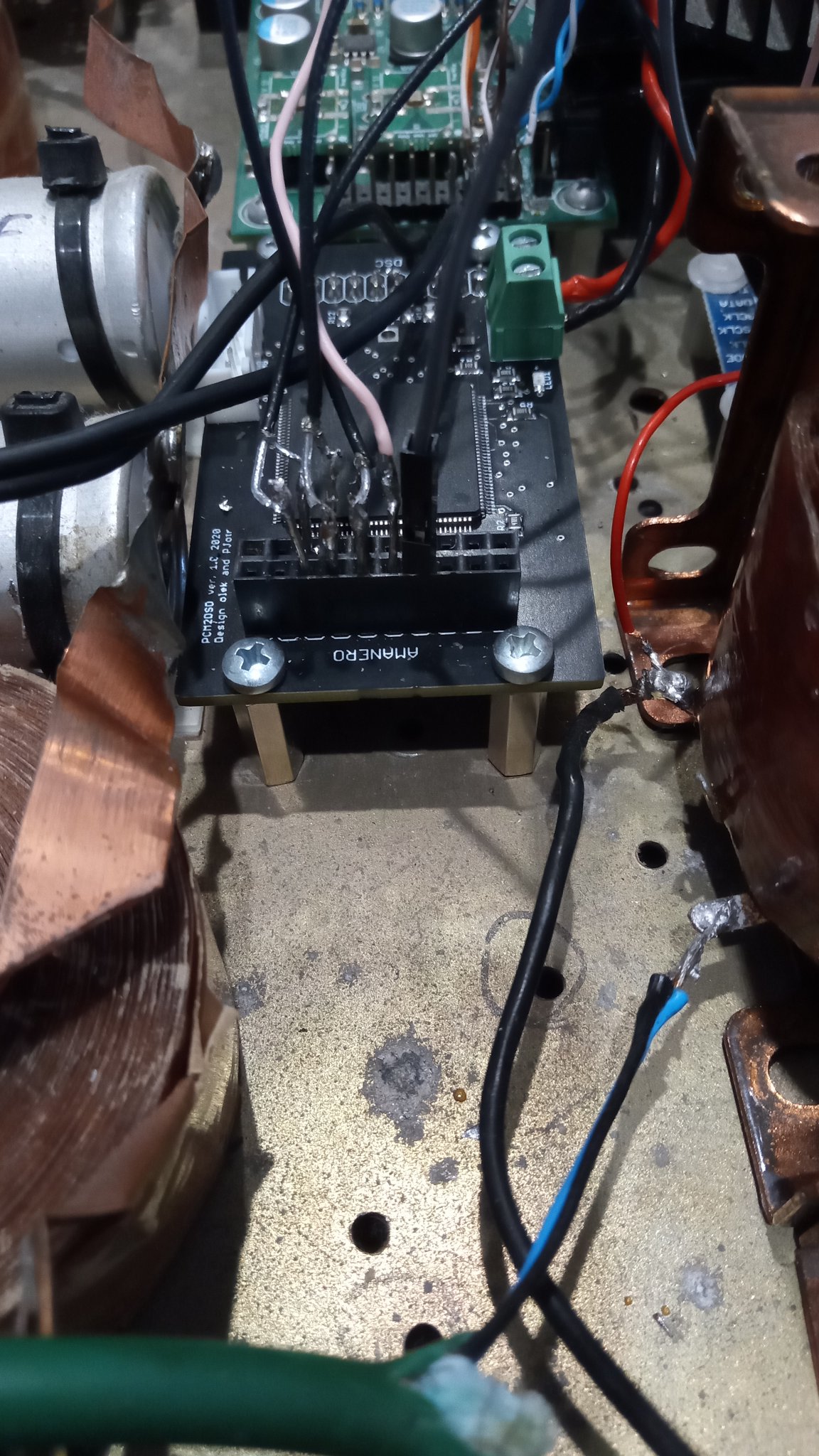

Still doesn't convert DSDIn the photo I can see that the wire is only inserted into the socket, you don't have a good connection.

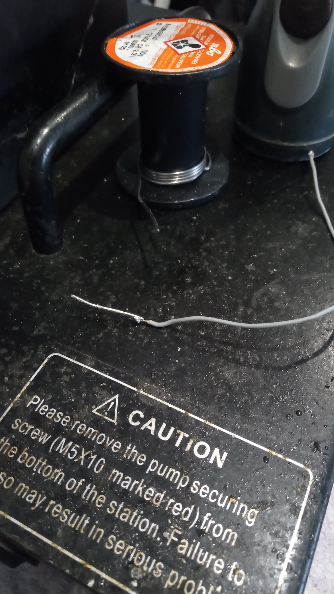

Have replied your PM, also if you are using reclock or other DSC board that is not DSC 2.5.2 or 2.6.2, you will need to check if the pin are all correct.As you can see I changed the DSDON wire with wire with 2 connectors but still doesn't work.
I think I soldered 2 additional wire and use the original amanero usb to make this work correctly on my setup.
Maybe time to check signals with the scope? If so, might want to solder a ground test point onto the board to connect the probe ground clip. Check incoming clock, data, mute, and DSD_ON signals during PCM playback. Do they all look good? If so, check DSD output BCLK, DSD_L, and DSD_R signals. Do they look good? If so, check them coming into the DAC. Somewhere you will probably find something wrong. If not, maybe we will ask you to post scope screenshots so we can double check for anything suspicious.
