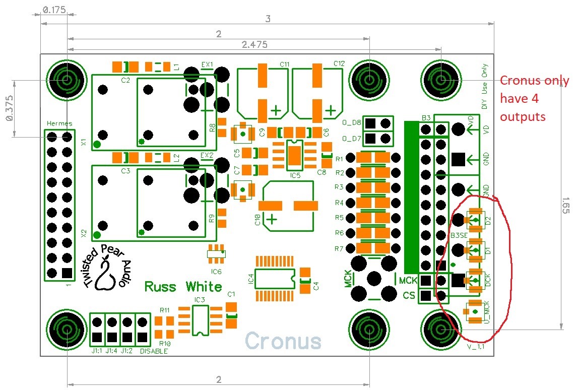

Cronus DSDON output is DCK output?

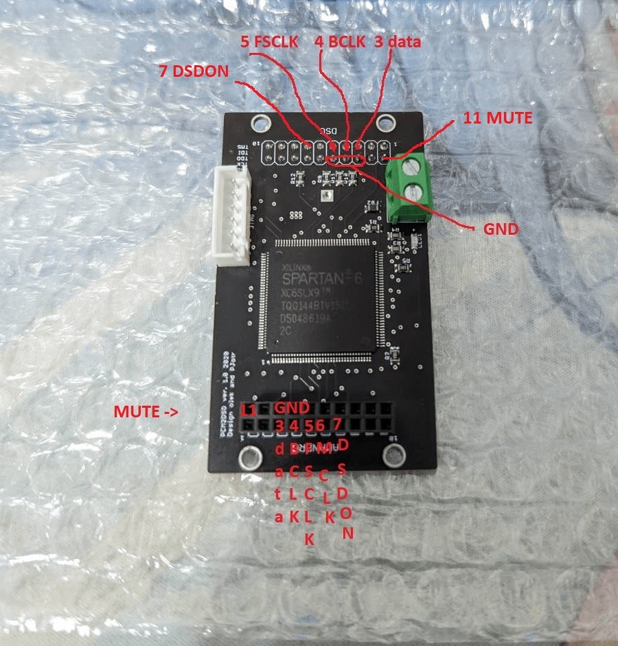

Pin DSDOn on Amanero it is "1" if play DSD, "0" if play PCM.
Pin DSDOn on Pcm2dsd always it is "1". It is signal for run dac DSC.
OK I do Amanero in slave mode => Cronus => pcm2dsd.

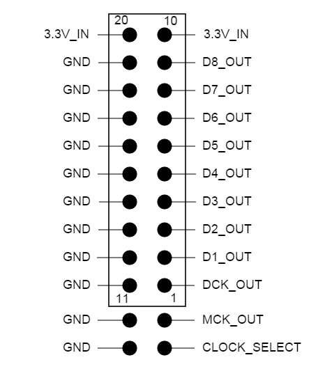

Not clear how to connect Cronus to pcm2dsd?
Pcm2dsd output analog left channel pin 9 LRCKOUT & analog right channel pin 5 DATAOUT + of course pin 6 & 10 both GND?

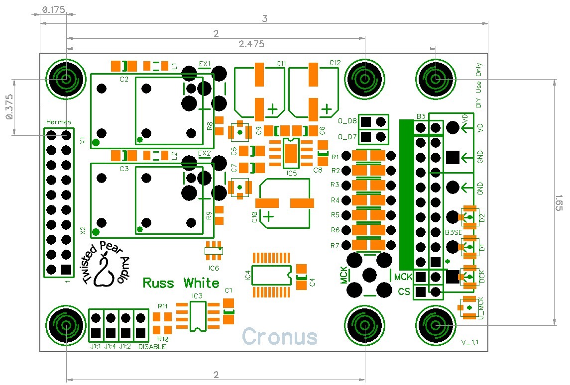

IIRC Chronus DCK is BCLK (data-clock / bit-clock). Easy to check clock frequency with a scope to make sure. D1 and D1 would be either LRCK and DATA for PCM, or else DSD_L and DSD_R for DSD mode. Check with scope if not sure which one (D1 or D2) is LRCK.
EDIT: I would still recommend to clean up layout and wiring. Its way too disorganized for RF. Transformers/inductors are too close to RF, etc. Think of a clean layout in terms of signal flow, keep I2S wires as SHORT AS POSSIBLE. Move boards around to make I2S and MCLK wire lengths very short and direct. Also, twisted pair wires have high characteristic impedance than 50-ohms. Probably closer to 100-ohms. You may need to add some damping resistors (maybe try 50R metal film) in the I2S lines where the impedance in changing to achieve best waveform fidelity. Ground scope probes carefully with short ground leads and use a fast enough scope. Otherwise the scope and probes will distort the waveforms you see so what you see will not be accurate.
