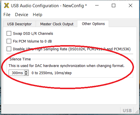

Is anyone using Xing U30 with dsc2 and hqplayer?
I bought the xing u30, but pin 11 mute is always "on" (3.3v)
I use it with Hqplayer, the xing is recognized and hqplayer works, but there is no sound on the dac because pin 11 mute is always "on" (3.3v)
Can someone who has the xing u30 with hqplayer if is playing check if pin 11 mute goes "off" (0v)?
I have other dsc2 work with amanero, and the pin 11 of the amanero goes "off" (0v) when hqplayer is playing.

Mute should change state briefly when switching from 44kHz family sample rates to 48kHz family or vice versa. Also Mute should be briefly asserted when switching between PCM and DSD. Things like that. You might need a scope set to trigger on a state change to see it.
Other than that, some Mute signals are active high and some are active low. Depends on the USB board and its firmware.
Here I am getting ready to test the Simple DSD Modulator using I2SoverUSB rather than Amanero. I had to add an inverter on I2SoverUSB Mute signal since its the opposite from Amanero.
