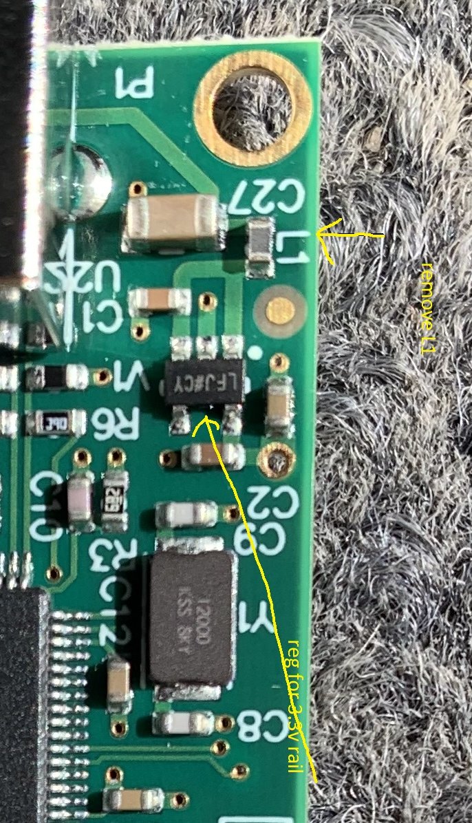

JL Sounds I2SoverUSB has better clocks than Amanero, but even I2SoverUSB can benefit from a higher quality external clocking arrangement.
That said, the biggest problem with Amanero SQ is that by default it runs on USB +5v power. Modifying it to run on clean +5 power helps a lot. If you haven't tried that yet, maybe wise to start there. Attached below is a pic showing where to modify the board. Remove L1 and apply clean +5v power at its lower pad, as shown in the pic. The +5v power ground should connect to the ground plane on the back side of the Amanero board. Its also possible to remove the 3.3v on board regulator shown by the lower yellow arrow. In that case +3.3v would need to be introduced at the output pin pad of the removed regulator. However IME its not really necessary to remove the regulator.
EDIT: the same +5v power mod is equally helpful for xing U30.

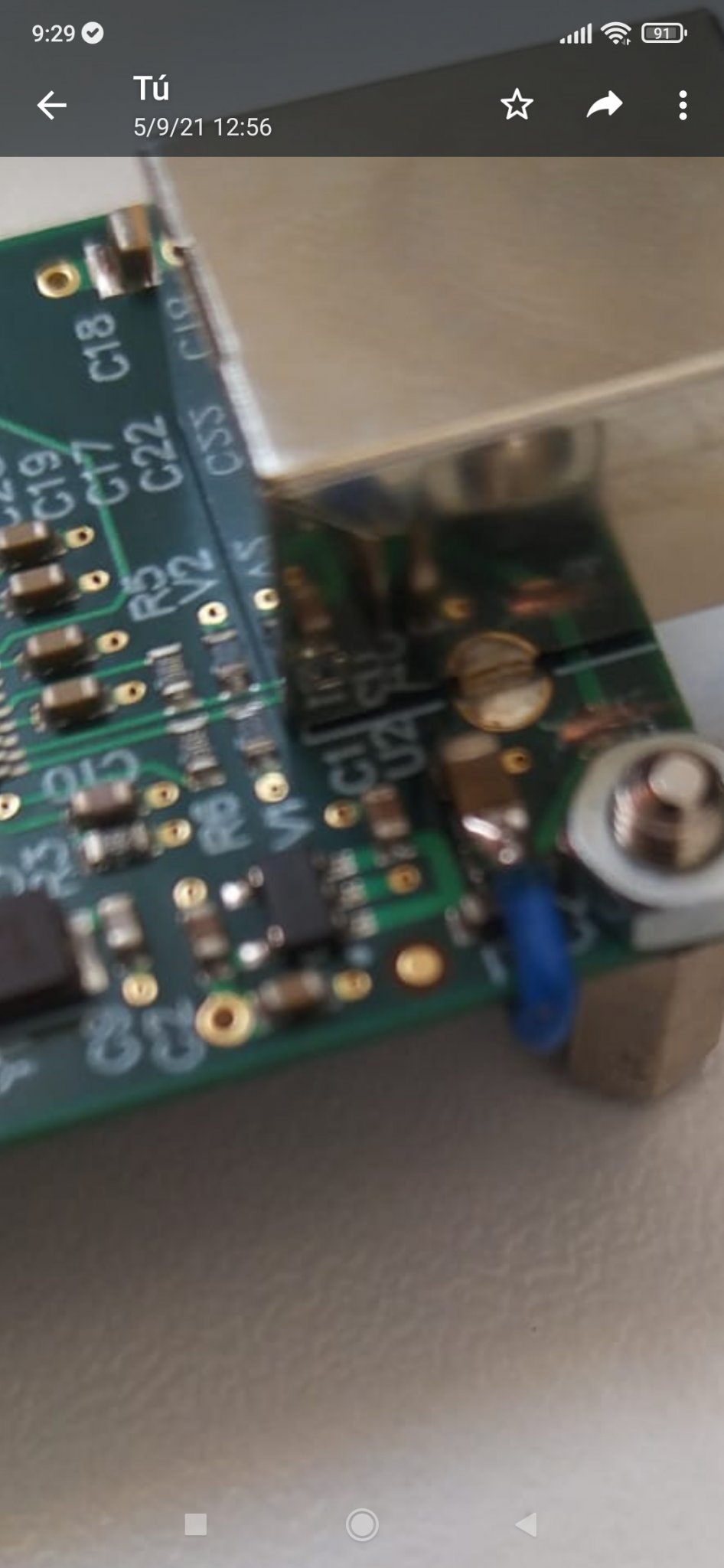

Yes, I always did that. Always connect clean ext 5v to the amanero pcb. In my case I cut the track where it says P1 and pay a cable with +5v in L1 and C27.
But I'm interested in knowing if it's worth it (because it sounds better) xing u30 would be a direct replacement, or JLsounds making pin modifications, and if its output is 5v pulses I don't know if it will be compatible with the dsc2 inputs.
