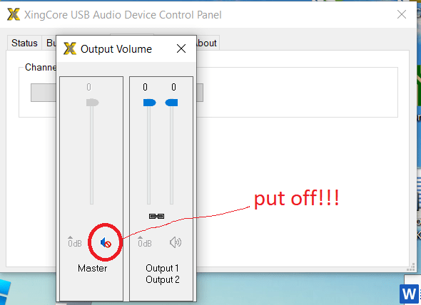

Uffff!!!!! What a fool I have been!!!
I have already discovered and fixed the problem. The problem was only that you had to disable the mute in the software tool: (image)
But every time I close and reopen hqplayer I have to go to disable it every time. But at least it works.

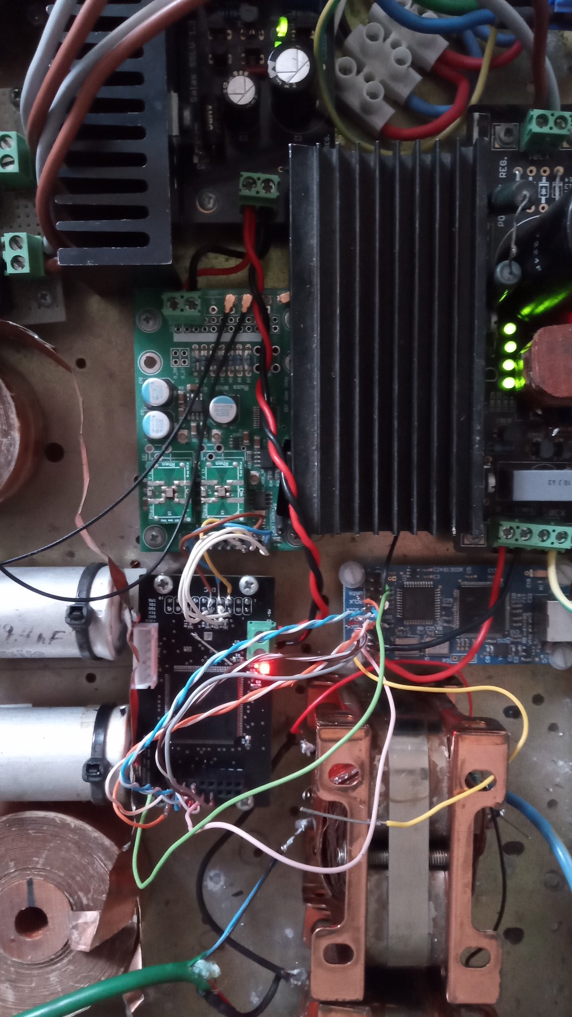

I connected as the attached picture but doesn't sound. Obviously Amanero to Amanero & DSC to Chronus & powered with 5V.

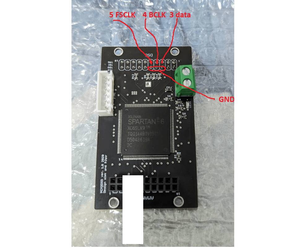

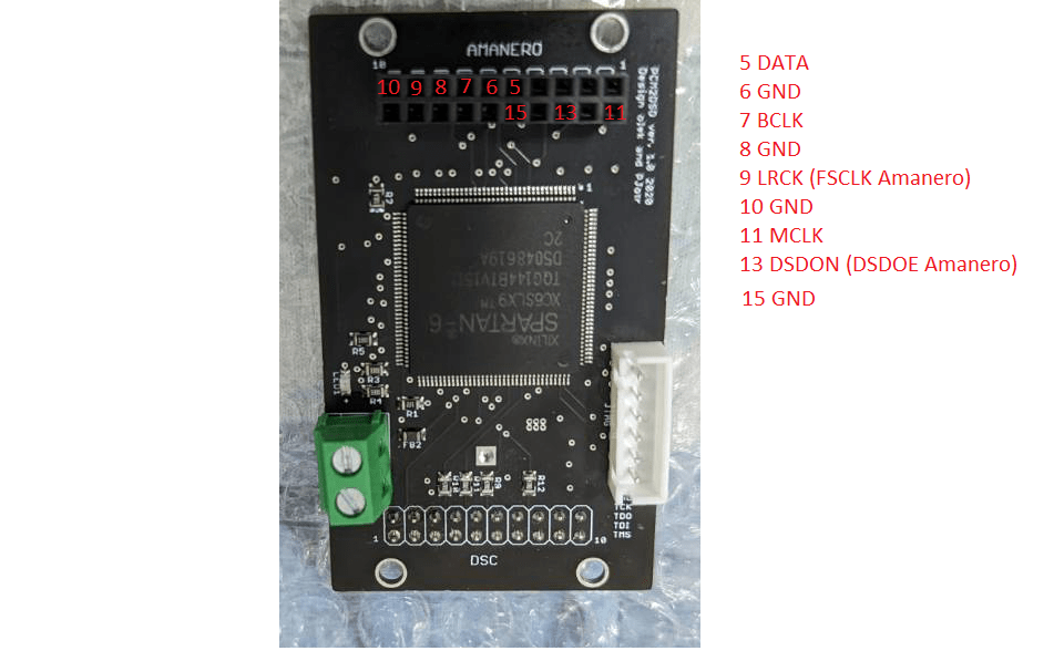

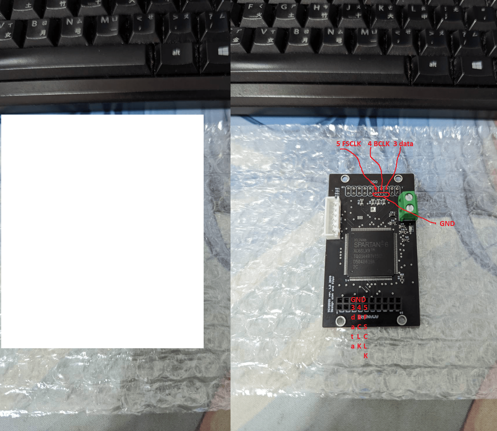

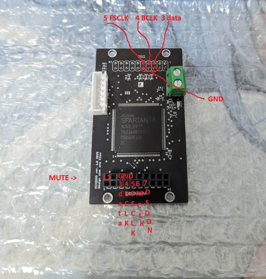

PCM2DSD to work needs from Amanero: Data, Bclk, LRck, Mclk, DSDOn, GND. And Mute it is pass from input to output. Look in post #68.I connected as the attached picture but doesn't sound. Obviously Amanero to Amanero & DSC to Chronus.
Input and output it is Amanero standard. See on pcb you have marked pins 1 and 10. Pin 3-data, 4-bclk, 5-lrck, 6-mclk, 7-dsdon, 11-mute.It's this input OK?

I will try, thanks.Input and output it is Amanero standard. See on pcb you have marked pins 1 and 10. Pin 3-data, 4-bclk, 5-lrck, 6-mclk, 7-dsdon, 11-mute.
Works thanks, a lot of more noise than converting DSD from Daphile.Input and output it is Amanero standard. See on pcb you have marked pins 1 and 10. Pin 3-data, 4-bclk, 5-lrck, 6-mclk, 7-dsdon, 11-mute.

Looks like the connections go in the order of: USB board -> Simple DSD board -> Chronus board -> DAC. Is that right?
Other than the pic shows various things there may be some reason to be concerned about. Long wiring lengths, possible stray coupling between different parts of the circuitry, possibly mixed clock domains, etc.
As i can see there are two domains, one amanero + pcm2dsd and second Cronus + dac.
For me better connect: Amanero in slave mode (mclk from cronus if cronus have clock 22/24MHz) -> cronus -> pcm2dsd -> dac.
Remember that pcm2dsd requires mclk from the 22/24MHz family.
Yes.Looks like the connections go in the order of: USB board -> Simple DSD board -> Chronus board -> DAC. Is that right?
