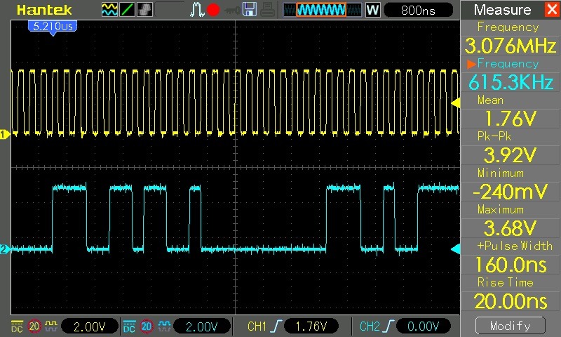

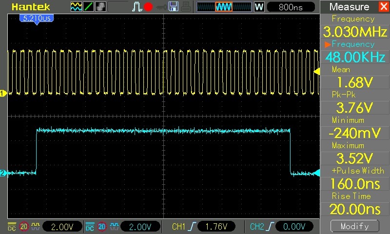

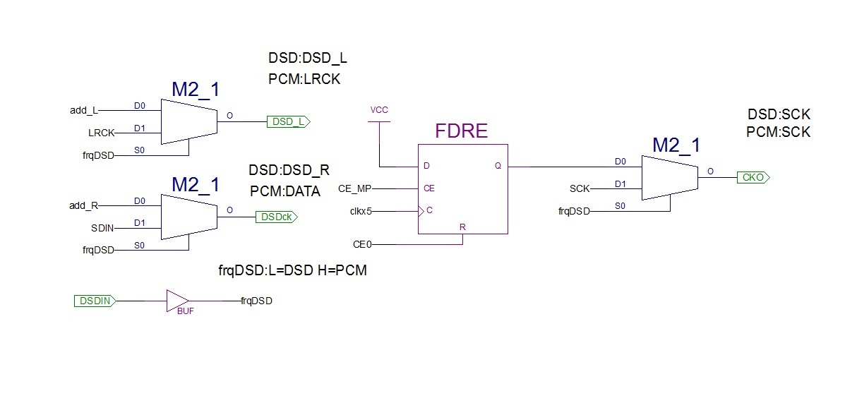

In the meantime wanted to see if I could spoof the DSD converter into passing PCM if I asserted DSD_ON manually. Seems like that should in principle pass through the USB board output, but it doesn't quite work as I had hoped. A couple of scope shots attached below show the DSD converter in normal operation, and then with DSD_ON asserted. In the latter case it can be seen that BCLK duty cycle is not close enough to 50%. Not sure if the other two PCM signals are also distorted since that would require a different measurement. For now its enough to know BCLK has a problem.

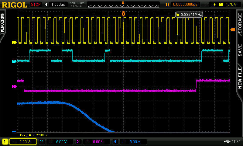

Normal conversion to DSD:
PCM Pass through not working as hoped:
Note:
Yellow trace is BCLK
Light blue is DATA
Violet is LRCK
Dark Blue is analog audio, which should look pretty much flat at this scope sweep frequency

Passthru works fine for me. Although the passthru was made to pass external DSD, you can pass PCM, it's just a switch.In the meantime wanted to see if I could spoof the DSD converter into passing PCM if I asserted DSD_ON manually. Seems like that should in principle pass through the USB board output, but it doesn't quite work as I had hoped.

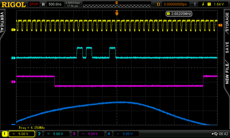

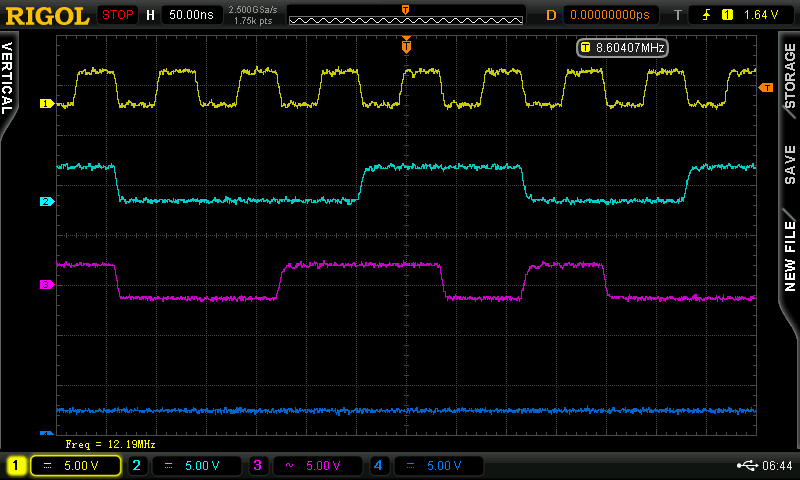

I did this for PCM:
Note:
Light blue is LRCK
Note:
Light blue is DATA
But note that the fpga needs a clock to work, in our case this clock it is the input mclk. So remember to always connect mclk. In addition, it is good to keep the order of switching on: first as the first device that provides mclk, e.g. USB_to_i2s.
Well, I'm very happy with youThanks. This morning its working for me too:

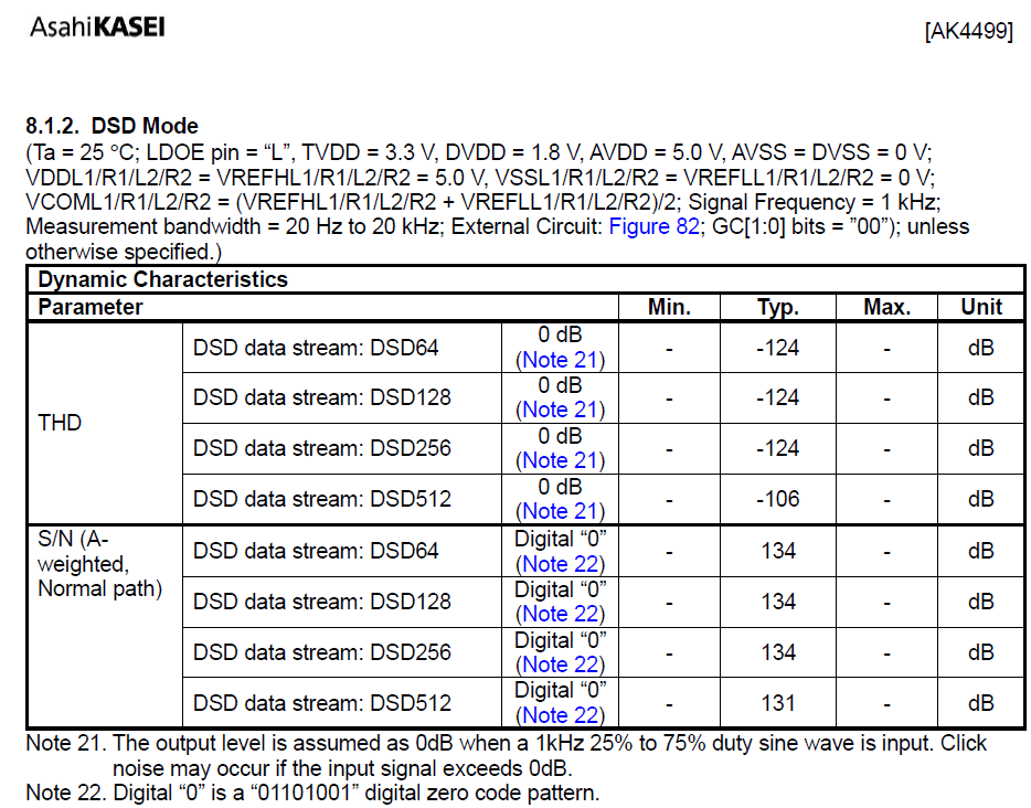

One of the disadvantages of 1 bit DSM is small-level performance. Quantization error caused by 1bit is too large to control that subtle amplitude. From -30dBFS to -60dBFS is usually fragile, IMO. Even in the digital domain, you can find some degradation in THD, which appears in the analog domain, something like ESS hump. How much of the amount hump seems to depend on the architecture of modulation you use. Multibit DSM(more than 2-bit) usually doesn't have such an issue. Some measures could be possible but drastic effect is unachievable in my experience. I think AK4137(up to 7 bits?) is dedicated to something other than 1 bit DSM. There is a chance 1 bit isn't their strong area.

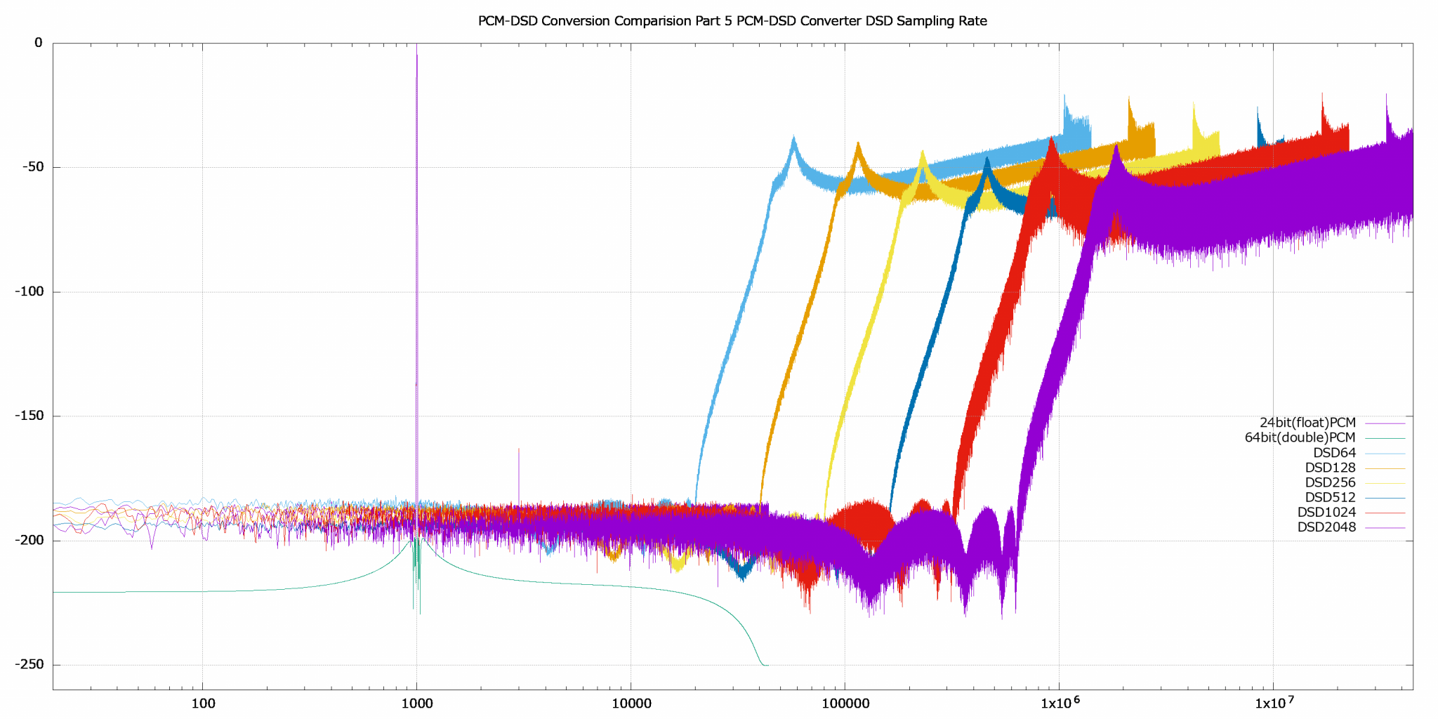

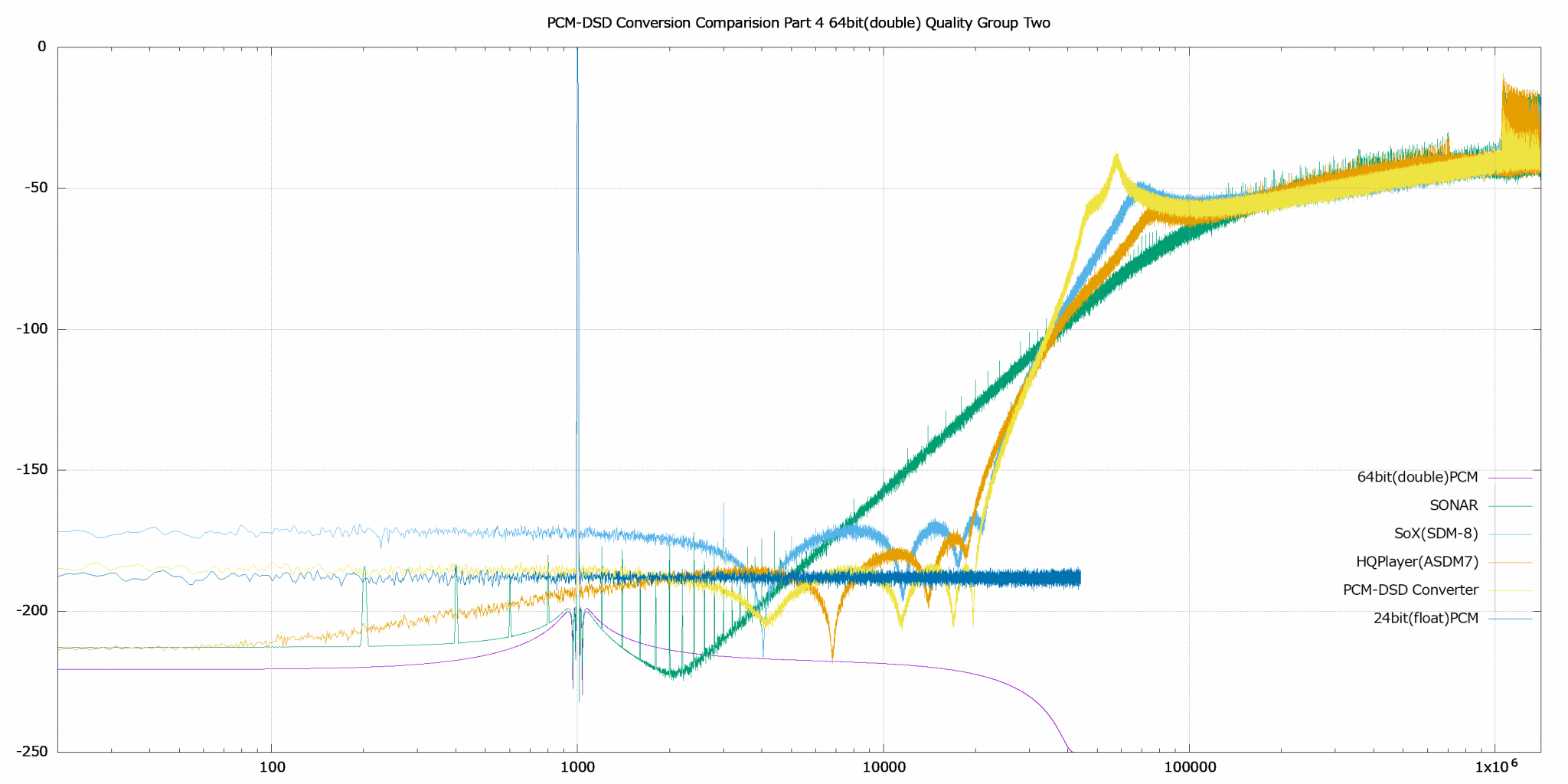

There can be quite a bit of difference in noise in different PCM->DSD conversion scenarios. Some example plots from PCMDSD.com (google chrome translation recommended):

Hi, happy new year.Therefore if trying to pass through PCM, LRCK and DATA signals are swapped.
Thank you for your opinion.
It's not a problem, we can swap channels. I will post the code when I have time.
We only set the channels for the internal and external DSD to match, and for PCM it turned out wrong...

I'm surprised by the orange plot for ASDM7. It's a quasi-multibit modulator as far as I know, but still, you see an FM-like spectrum on the right hand side of the graph. That makes me wonder if it has a big idle tone there at low volumes.There can be quite a bit of difference in noise in different PCM->DSD conversion scenarios. Some example plots from PCMDSD.com (google chrome translation recommended):

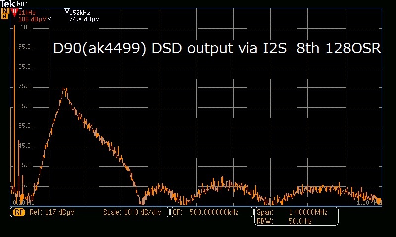

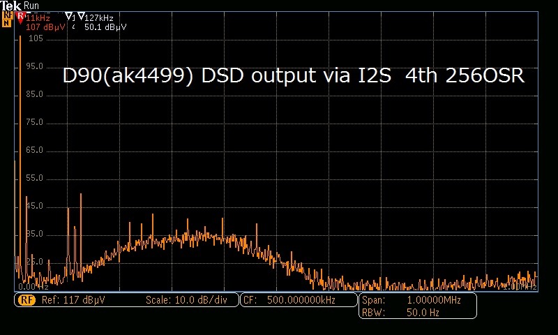

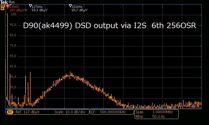

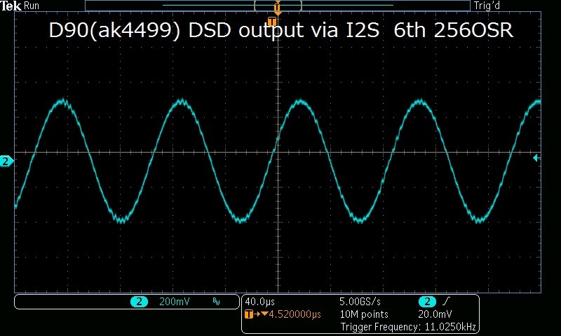

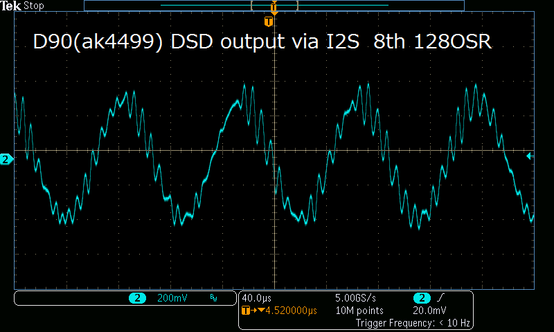

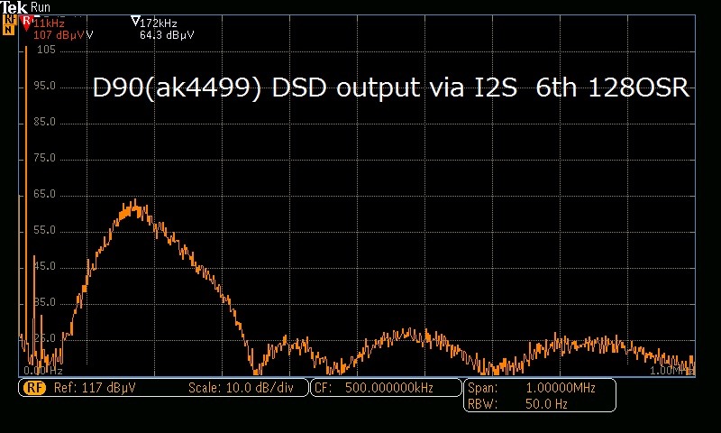

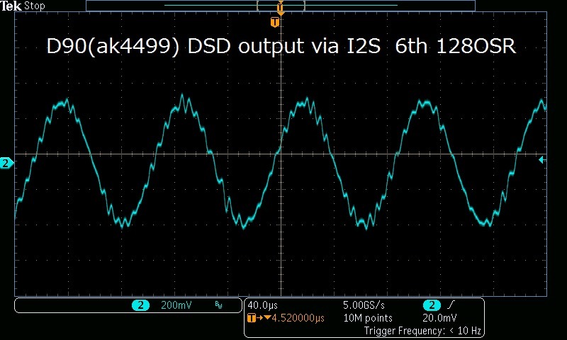

My 5th order 1bit DSM(#182) is 160OSR or 80OSR. 5th order 1bit DSM with 64OSR has a bit large RF noise though it's less than SACDs(probably 7th order 64OSR). You can have more than 120dB SNR(20kHz bandwidth) with 80OSR. There is much difference between 64OSR and 80OSR. That's why an odd OSR is used for 5th order 1bit DSM. D90(Topping) doesn't accept an odd OSR, even 48kHz family. But I'm sure AK4499 or DIYed 1bit DAC has no problem with that.
The best combination between the order of DSM and OSR depends on how much RF noise is acceptable, IMO. If your criteria are the less, the better, you want the 4th order with 256OSR. 4th with 256OSR is the cleanest because the higher the order of DSM, the larger the RF noise. The attached pics are various combinations measured with D90(ak4499 version), analog waveforms, and RF spectrum. High-order DSM can decrease the audio band noise in the digital domain, but you can't make the most of it in the analog domain. In the real world, with high-order(8th) DSM, you can have considerable RF noise and the same performance as low-order(4th) DSM. That's why I prefer 4th with 256OSR. But 256OSR is a bit difficult for a DIYed DAC. I usually end up 6th and 128OSR.
