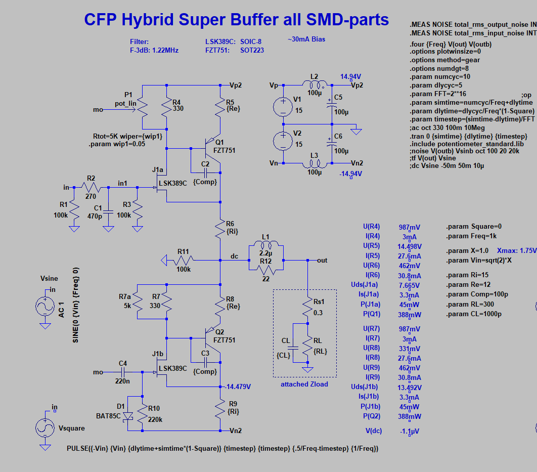

a hybrid Sziklai pair (or hybrid CFP) is a way to very low distortion and considerable drive capability.
The lower half is used as constant current load (trace ´mo´ open) or as a modulated current source (trace ´mo´shorted), ideally allowing for up to twice the load current.
It can be used as SE circuit with a single supply (adding dc-blocking caps) or dc-coupled with symmetrical supply lines.
The Sziklai pair is by far more linear and can drive heavier loads than a typical single small signal transistor.
Adding JFET cascode transistors to the input JFETs will give You a Calvin-Buffer .... a search will give You a lot to read about that little guy´s qualities 😉
the simpler Hybrid CFP variant shown above is not worse compared to the cascoded Calvin Buffer but easier to build.
The cascode just shows very slightly better THD at very low load impedance levels.
Both have to be biased in class-A, because both are singleended in nature.
The output LR-network may be advantageous when driving capacitive loads like long cables, but a resistor alone (with a higher value, say 47Ohms) should suffice in most cases.

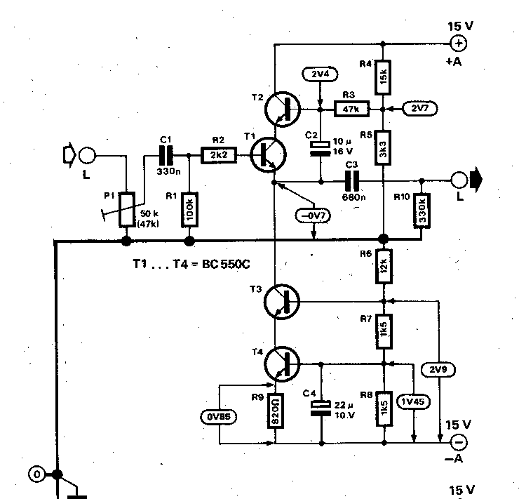

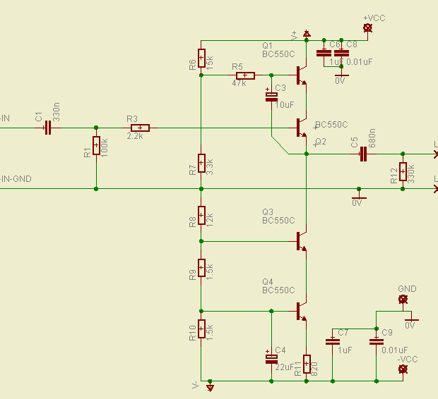

Calvin, i just really like the sound of the buffer 128. it's very musical which i suspect is because of bootstrap feedback. because of this i'd like to explore the circuit more. no doubt your circuit sounds supreme but positive feedback always holds a magical appeal to me.

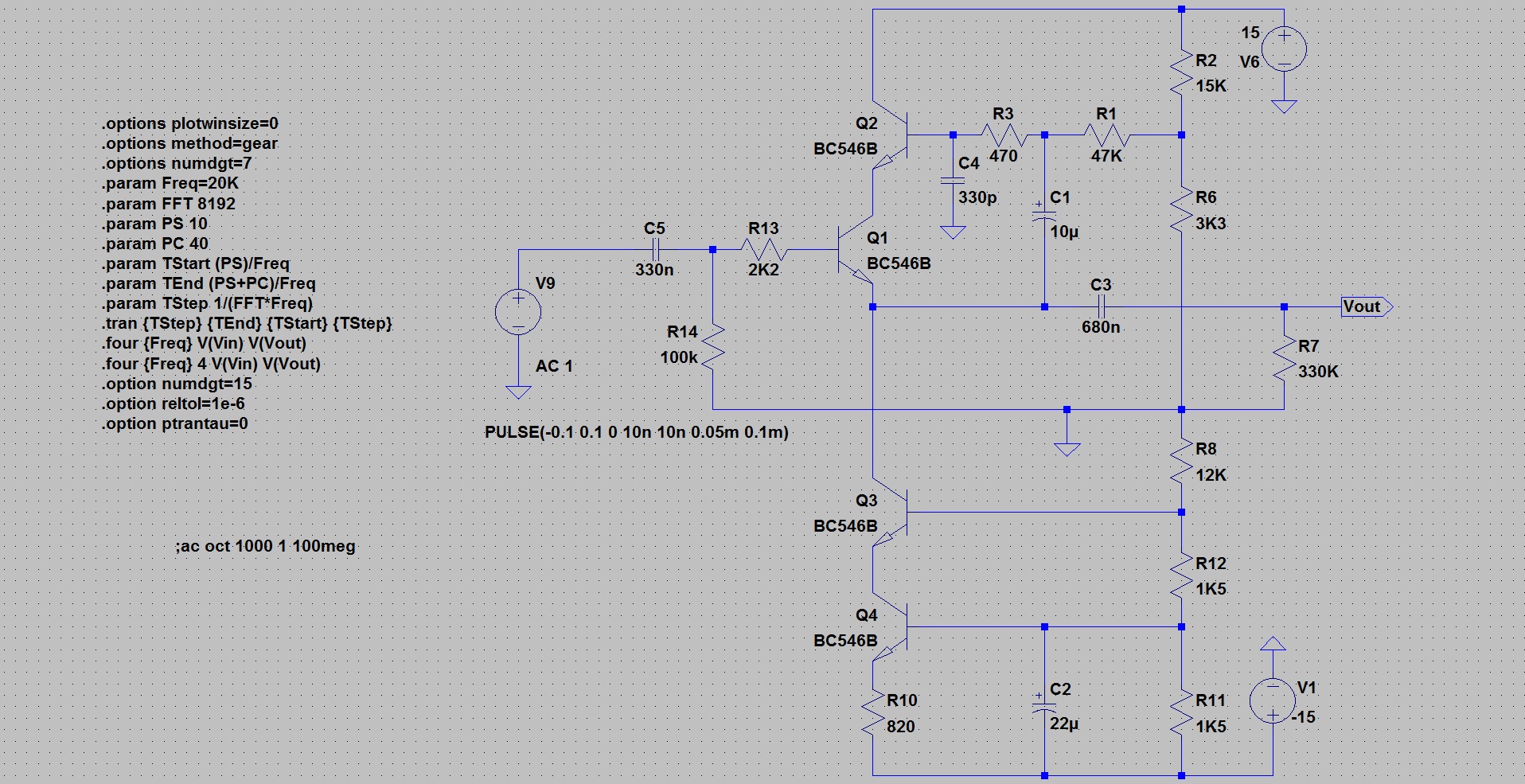

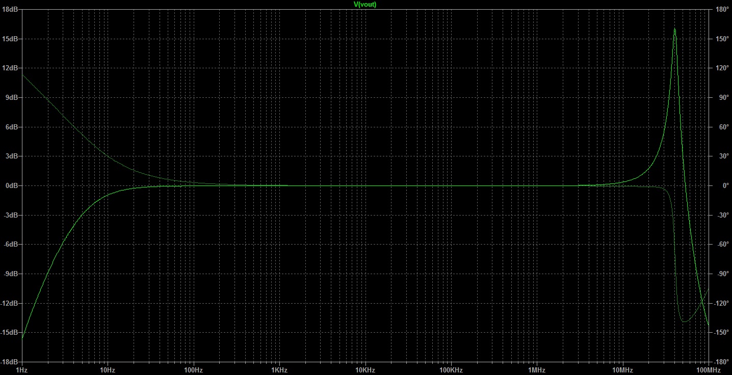

I did an ac analysis for the elector buffer in LTSpice and there is a huge peak in the transfer function.how can this be cured?
