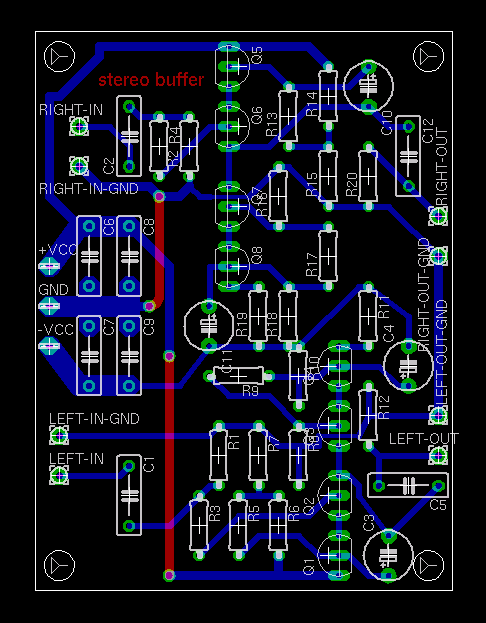

I guess that this design of PCB is not good and will bring problems with hum, 'cos ground loop is closed. It must be interrupted and ground of both channels must lead to the middle of PS separately.
Is this better?
tcpip said:
Is this better?
Great layout Tarun, you are a pro already. There are just these 2 things I would do.
1. Put the powersupply ground jumper directly at the output gnd instead of Right input gnd as you have done.
2. Avoid taking tracks from inbetween TO92 pads, use a jumper, or you can reorient R4. It will give you much less problems later.
Aapki kripa, Gurudev.
Done
Done again. How does this one look? Are the jumpers okay?

Originally posted by Upupa Epops Hi tcpip : This is better, but try it redesign - if you get PS to the oposite side of PCB ( between outputs ), result will be much more elegant and " electricaly " correct 🙂 .
