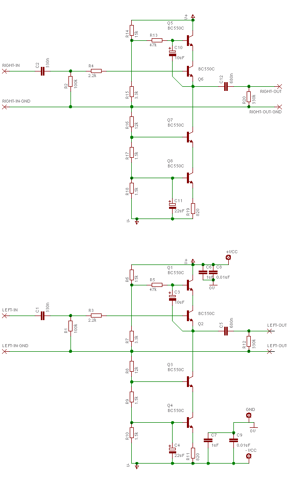

Did the schematic of the Elektor buffer
Wanted to proceed from schematic to PCB, and thence to Enlightenment.
Is this schematic okay? One newbie question: with discrete circuits like this with less-than-opamp level PSRR, does crosstalk increase because of supply rails-based coupling of channels? And therefore is there any concept of "decoupling" each channel of the buffer, like we do with opamps (though there it's to stop oscillations, I think).
I've put two pairs of caps at the point where the supply lines enter the PCB.
Once you comment on the schematic, I'll pass it to the PCB stage. I've already done the PCB layout based on the current schematic.

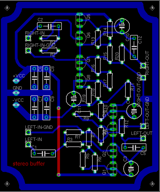

And here's the PCB... couldn't wait
The PCB is supposed to be single-sided. The single top-surface track will actually be implemented as a jumper wire. Other than that, there's nothing very revolutionary. Sorry if my total lack of PCB layout skills is showing up. It was done using the free version of Eagle, with manual place and route.

Can you attach the Eagle files please ? The board looks OK and for once I see someone making room for standoffs for mounting the board. A big hurray for that. I would cut the ground track however so that only one track will be the ground instead of a ring-ground. Swapping C10 and R13 might be a good idea, C12 can be mounted horizontally that way.

Resistors used for the cascoding transistor biasing have generally too low values. Use the higher values thus the cap can be smaller, say 1uF. Shown biasing scheme will, btw, provide not much more than the minimal necessary swing (usage of the JFET without biasing resistors, be it high Vgs or not, will btw have the same problem), try to tune cascoding transistor’s voltage (base and emitter) somewhere in the middle of the Vcc. With BJT as cascoding device, one might use exclusively its base current and relatively high value resistor and reference it to the positive supply only.
At the other hand, base stopper is probably too high and as such reduces the effect of the cascoding. However, some base stopper still should be used, and especially should be used to prevent peaking/oscillations caused by the non-zero signal source impedances.

Will you please make the changes you suggest, and then attach a picture of the PCB layout in a reply post, so that I can see what you're suggesting? And at a more conceptual level, what's the problem with the ring ground? (Warning: newbie here.) I thought rings for earth tracks are okay for low-current circuits like this one?

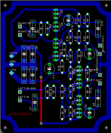

You asked for it, pardner. 😀jean-paul said:Can you attach the Eagle files please ? The board looks OK and for once I see someone making room for standoffs for mounting the board. A big hurray for that. I would cut the ground track however so that only one track will be the ground instead of a ring-ground.

Hi Pedja, All,
Don't know about the other points raised, but circuit as shown can swing +-12V. Putting the upper cascode higher will reduce swing.
Data for JFET mod is comparable, and you get higher swing for lower VTO.
Peter Jacobi
Pedja said:[...]Shown biasing scheme will, btw, provide not much more than the minimal necessary swing (usage of the JFET without biasing resistors, be it high Vgs or not, will btw have the same problem), try to tune cascoding transistor’s voltage (base and emitter) somewhere in the middle of the Vcc.[...]

I don't have the time right now but I'll put a stereo potentiometer at the left side and I'll put the power connectors to the right side hoping to avoid the jumper wire...

I guess that this design of PCB is not good and will bring problems with hum, 'cos ground loop is closed. It must be interrupted and ground of both channels must lead to the middle of PS separately.

Seems like I must correct myself here, you are right. Actually that 47k is not the base stopper… 🙄 (I put it now into the spice and have seen the negative half clipping at about 8.5V.) And JFET applied directly without biasing network did not limit the swing (as I expected).
However, I would rather like to see a higher Vce, even if it is supposed to be held constant.
tcpip said:I find your comments interesting, and want to see what you mean, but I can't follow the terms you use... I have almost no knowledge of circuit design. Can you please repeat your comments and include actual references to things like R9 and C10 in my schematic? Please? Just repeat it all for just one channel, and I'll follow your suggestions to see what you're talking about.
According to the things just said, here is the slightly corrected idea.
Principally, if you raise the impedance seen by C10, you might reduce its value which enables possibility to use a better cap. In this concrete situation this impedance is mainly formed by R13+(R14//R15), so you could raise it raising R13’s value. This resistance, seen by the Q5’s base current (which is equal to Ic/hFE of the used piece), will however, when raised, develop more voltage across it and this will additionally alter the DC points of the cascode set by the resistor network (R14/R15), namely the voltages of the cascoding device will go lower thus further reducing Vce of the pass transistor, so this must be taken into account.
Another way is to leave that R13 as it is, and to raise the values of R14 and R15.
And another way is to go only with one resistor (R13) referred to the positive supply. Here you should really know Q5’s base current.
Note also that too high impedance seen by the base is often considered as not very welcome.
Hope this helps rather than confuses.

jean-paul said:I don't have the time right now but I'll put a stereo potentiometer at the left side and I'll put the power connectors to the right side hoping to avoid the jumper wire...
I thought about the avoiding of the jumper, but I can't see how I'll achieve that, because wherever I put the supply terminals, the positive line has to reach both upper and lower extremes of the board. Now I'm wondering whether it would have been a better idea to make a broad and short board with the left and right channels one beside the other instead of one below the other. That way, the supply lines could have been long horizontal tracks moving from left to right on the upper and lower edges of the board. Maybe someday I'll do another board like that. 🙂
I thought about it, but I felt that I'll often need more than one buffer in a chassis, so I might as well keep the two separate.Maybe integrating a regulated power supply is a good idea ??

Thanks for the trouble. I haven't yet sat down with your comments and the circuit; I'll do it soon. I won't understand the deeper reasoning behind your suggestions, but I'll at least understand the current flow changes you've described. Thanks again. 🙂Pedja said:Note also that too high impedance seen by the base is often considered as not very welcome.

This was my comment too on the original board and I will change that. In real life it will not give too much problems I think. Nevertheless it can be done better and it will be changed.
But what about downloading the files and making a perfect PCB ?? Show us you're the masta !
A ground loop has enough with a few mV, even a regulated supply can't help. Star grounds are preferred.
