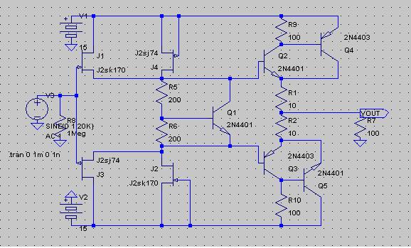

Simple discrete unity gain buffer
figure out how to direct couple, reduce parts and reduce distortion.
Well, if you can accept a slightly higher output Z (like an extra hundred ohms or so), you can do that with two fets and two resistors- but they have to be well-matched fets with tight thermal coupling. And well-matched resistors, but that's easier.

Per-Anders, will you please try to give me some inputs about my diamond buffer vs ultra-linear VAS circuit question? I'm going round and round in circles on that one, ever since I saw those (very interesting) threads on diamond buffers. Even any vague pointers, suspicions, hints, will do.
Tarun
tcpip said:
But if I can get similar figures, together with very low Zout and good current driving ability, using opamp chips, then why bother with those discrete buffers?
One very good reason is: It's more fun with discrete electronics! (not neccessarily better).
Tarun, sit down take a deep breath. Then start to explore the alternatives. The first suggestion of a simple emitter follower isn't bad, remember that.
I suggest also that you fool around with LTSpice which is a freeware. Since a couple of us use this software (including myself!) we can discuss things both at simulation level and in real life circuits.

BDP said:
Take a look at http://www.borbelyaudio.com/index15.htm. I think he even has an example of one of John Curls followers. Very simple, low parts count. I'm going to build some of these and have a listen. I want to use some of these as followers for active crossovers. I tried a constant current source version and the output impedance was about 40 ohms and the JFET was biased at about 10 mA.
BDP
You added a period "." to end your sentence and it glitched your link but yes, John Curl is mentioned in Borbely's article here:
http://www.borbelyaudio.com/ae699bor.pdf (bottom of the fourth page, numbered 19).
This is in regards to using complementary JFETs (2sk170/2sj74) for a source follower.

To come back to the topic of my simple buffer... I will try listening to this circuit, and compare it with an NE5532-based buffer, and actually see what I can hear, within the limits of my ears, brain, and music system. Since the components are inexpensive, it should be fun trying. 🙂 I know my friend Angshu tried replacing TL072 with OPA2134 in a lovely little phono preamp he built, and heard no difference. I guess people like Angshu and me are simply the audiophile-equivalent of tone-deaf (can I invent a new term? "component-deaf"??), but it's always interesting to experiment. 🙂
And then, if my PCB-making skills prove adequate, I'll probably make a PCB of Randy Slone's super-duper input+VAS circuit, and listen to that too. 🙂
I keep remembering SL's Website, where he takes all this trouble to design and build the Phoenix and Orion, and then says you can drive them with an array of LM3886 poweramps. I wonder whether he can hear the difference between OPA627 and AD797? 😀
Bottom line: "whatever floats your boat." 🙂

tcpip said:
I will certainly try this. Do any of you know whether there's anything on Linux?
Serch the net for "Linux" and "Spice" and you will find a lot. The
official Spice from Berkeley runs on Unix AFAIK, so I suspect the
Linux versions are based on this original core.
BTW, maybe I shouldn't give you more options to choose from, but
it seems to me that so far the discussion has only been about
either using an op amp as buffer or using a discrete buffer of
one type or another. There is also the common solution of using
an op amp plus a discrete buffer, with the buffer within the feedback
loop. That is even more complex, of course, so it counts as a variant
on the op amp solution.

Christer said:
Serch the net for "Linux" and "Spice" and you will find a lot. The official Spice from Berkeley runs on Unix AFAIK, so I suspect the Linux versions are based on this original core.
Thanks for the pointer, but I was hoping for an easy way out, asking. 🙂 I know Spice, like a lot of American university developments, was first done on Unix, usually resulting in good, portable C code. Since I'm a product of an academic environment where we used Unix heavily, and I continue to use Unix at my workplace, I love this class of software. However, often such stuff is weak on interactive GUI, so I was wondering whether the GUI schematic capture tools of the Unix versions would be as powerful as the newer Windows-based stuff.
...There is also the common solution of using an op amp plus a discrete buffer, with the buffer within the feedback loop. That is even more complex, of course, so it counts as a variant on the op amp solution.
Join the Confusion-For-Fun-and-Profit Club. 😀
I'll add some more... Randy Slone says that his input+VAS circuits are essentially opamps, with two inputs and one output. So his circuits, which I was referring to as examples of discrete buffers earlier, are actually opamps. 🙂 In fact, I've been tempted to build a preamp and tone controls using his "opamp" circuits. Maybe I will, someday. 18 transistors for a mono tone control circuit... that will be something. 😀
And then Walt Jung's buffer is actually a sort of output stage grafted on to an opamp, to get specially low Zout. And there are a lot of power amp designs which have an opamp acting as input+VAS, with discrete power transistors as OPS, the whole thing tied together with GNFB. I guess that would be a beefed-up version of your buffer?
