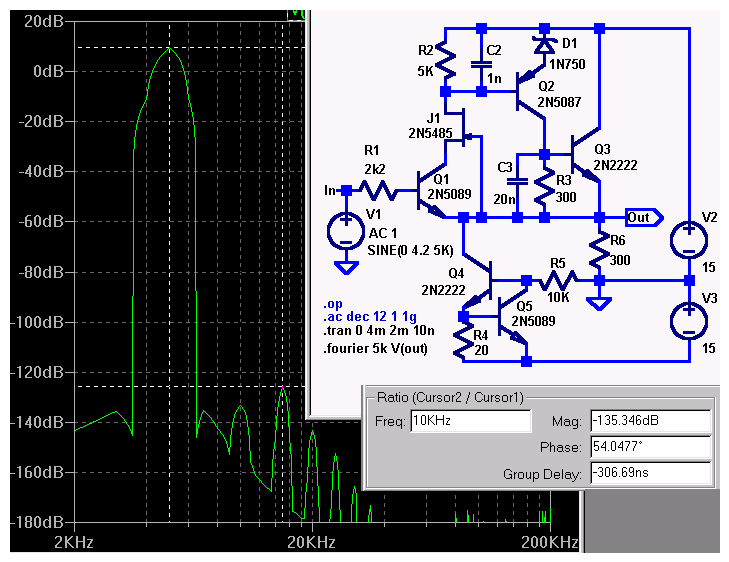

With regards to the fet subsitutions in the Elector buffer, cascoding the current source with a fet is fine, but pretty irrelevant to distortion performance when driving any load that requires buffering – the Ic modulation of the pass transistor Vbe will dominate
Replacing the bjt cascode of the pass transistor with a fet is less likely to improve distortion – the fet will have a much larger source impedance than the bjt cascode and any pass transistor current variation from driving a real load will give more variation at the pass transistor Vcb than the bjt approach
As long as we’re talking simple buffers, a simple way to reduce Vbe modulation (after increasing bias current to the max) is to use the compound feedback pair structure
Below I show a “simple” elaboration of the single stage buffer using a compound feedback triple (Q1-3) biased with a feedback current sink (Q4,5)
(the circuit sims ok but is certainly too simple for the real world, compensation and cap load stability need some elaboration)

The idea for using Jfets for the upper transistor in the cascode was to use the gate to source voltage at the quiesent current to get rid of the
need for the bias network. Cascoding the current source is most likely for the increase in power supply rejection for noise on the negative supply rather than the than reducing the parallel load impedance the follower has to drive. Adding a compound circuit for Q1 seems to be a waste of parts if you add another follower Q3 driving 300 ohms! I don't quite understand why everyone seems to be allergic to capacitors when it comes to filtering the reference voltage. A cascode for the current source is pretty useless if the current is going to move around from noise in the reference voltage from noise in the negative power supply.

Yes the simple EF buffer can be improved but what's really wrong with it in the first place, what needs fixing? A tiny amount of low order distortion proportional to the input signal, don't see much to worry about there.
fred, put on your glasses
i thought it was pretty clear R6 = 300 Ohms is the load, seemed (somewhat) more useful than printing out distortion # for "improved" emitter followers with 330K "load" resistors - a buffer otta BUF, and 300 Ohms is a real test of a line level buffer, in fact i could probably shop the idea over at headfi as a discrete buffer for the Senn HD600
Q3 (and Q2) are inside the feedback loop formed by Q1 which is acting as the input stage of a "current feedback" amplifier, Q2 is also servoing Q3, the whole being used as single compound transistor "emitter follower" - i know you can recognize a "triple" output stage in a power amp
btw the Q4/5 current sink does provide a fair amount of psrr, splitting R5 and adding a bypass cap to V- wouldn't hurt though
i know the fet cascode is elegant and it works pretty good if the current is nearly constant (see J1 cascoding my input Q1), but in the pass transistor the collector current is going to vary and cause a dynamic V drop at the fet source, reducing the effectiveness of the cascode

"simple" certainly has a range of definitions, the intermediate step with the simple 2 transistor cfp can be seen in:
http://www.dself.dsl.pipex.com/ampins/discrete/cfp.htm
Yes, JCX, my very point, figure 11 in fact, in Self's site.
Figure 13 is the SS equivalent of a White Cathode Follower, and that appeals too, though the PSRR is poor. I have tried it and it definitely gives equivalent sonics and output for about half the quiescent.
RichardC from Nottingham made the reasonable point that a simple, SE follower's distortion would be essentially lower order harmonics anyway, and why improve on that, particularly as most of the distortions introduced by digital electronics are completely non-musical in nature......
