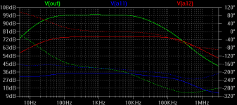

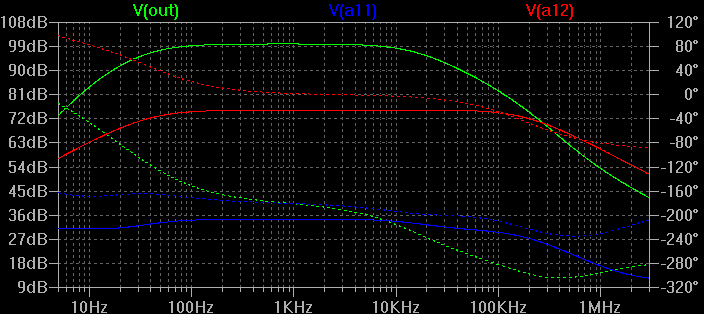

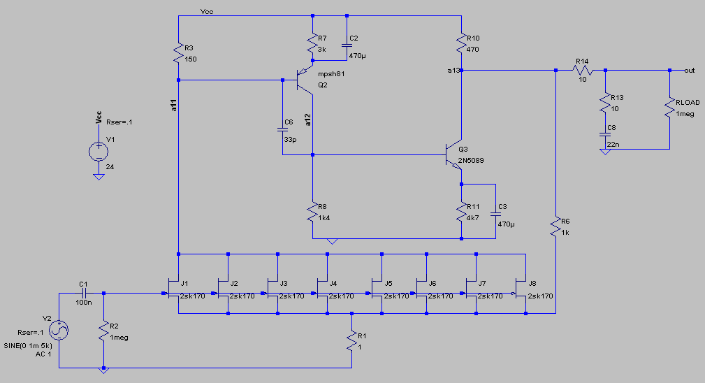

As for simple discrete, which I was still hoping for, I built the attached circuit last night. Without feedback the first and second stage behave almost identical to the simulation. But as soon as the third stage and feedback are attached, I get these square steps up to the rails. I don't really understand why; the simulation shows a good phase margin of more than 80 degrees.

Forgot to say, but I built syn08's circuit too (with k270v), and it didn't work for me, it oscillated wildly. Almost the same thing as this discrete example, without feedback the first stage worked fine, but as soon as the second stage plus feedback was added, boom! Built it three different times to make sure I didn't make a mistake in wiring.
