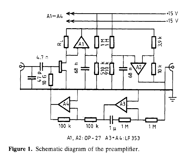

This does not qualify as simple, but still the lowest I can find (.065nV). The article has full disclosure of every detail so it could be duplicated.

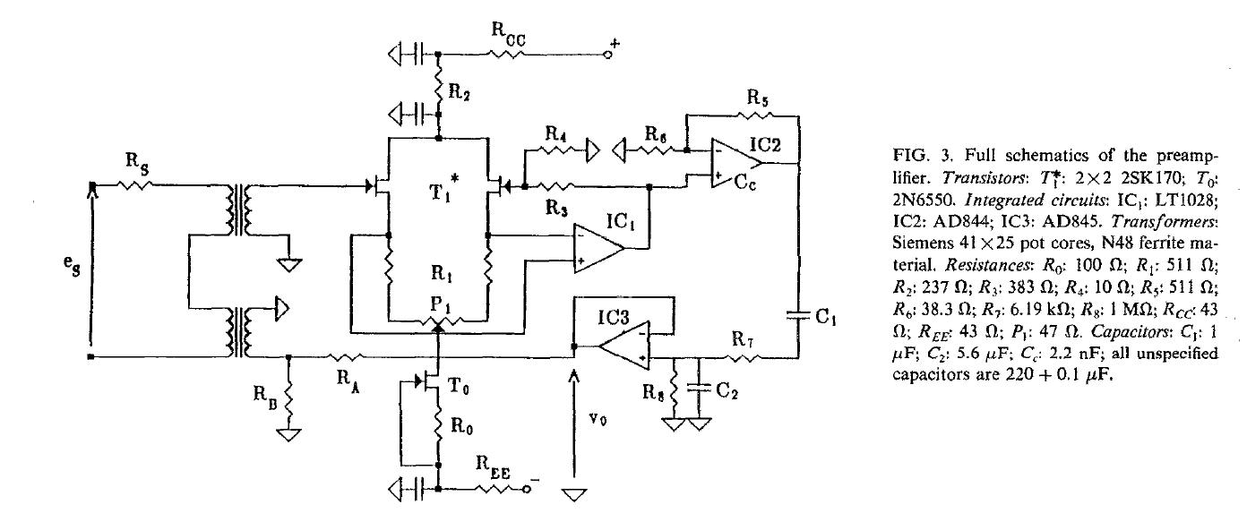

I read that article a little while ago and even would my own transformer 😀 Here's the whole article for those interested:
http://www.picovolt.com/win/elec/articles/Lepaisant_preamp-xfmrs_RSI.pdf
But, and this is a big BUT. Number one problem for many people would probably be the transformer. I looked up the 41x25 pot core of N48 ferrite material, and it's not easy to find. I could find only Epcos making it, and they don't have a distributer in Canada. A few in the US, but haven't contacted any of them for a price. They get down to 5Hz with only 10 turns in the primary... Then they also mention that they had to machine the cores to increase the
As I said I wound up my own transformer on a high mu toroidal ferrite core but below 500-600Hz the frequency response was bad.
Also, if I was to use this to measure the noise of a voltage regulator with 15V DC on its output?

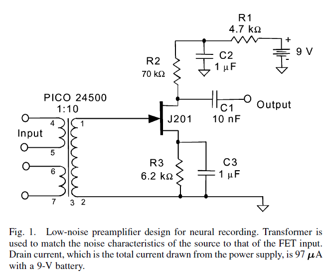

There's another neat little paper
http://web.njit.edu/~sahin/LowNoise2005.pdf
a simpler circuit using a microphone transformer. Several problems with that, including a max upper frequency somewhere between 40kHz and maybe 100kHz depending on how good the transformer is.
Edit: about the second paper, perhaps the idea of interest there is that of "noise matching" or matching the internal resistance of the signal source to that of the input jfet, which would be en/in. They use a J201 so they calculate en/in as
Rso = 6 nV/rtHz / 0.6fA/rtHz = 10Meg.
Then they calculate the optimum number of turns for the transformer as
n = sqrt (Rso / Rs)
where Rs is the internal resistance of the signal source.
In any case, the idea is that the closer the match, the lower the output noise of the amplifier will be, and the higher the SNR.

Material #77 looks close to N48 on some important specs and there are several places that let you buy in 1's or 2's quantity. I'll see if our transformer models can deal with this beast.
Good idea Scott, another material close to N48 seems to be N22, with even less loss at lower frequencies, and found a place which sells 47x29.8mm pot cores for about $10 a pair. Same place has 47x40mm E cores material 77 at $5.5 a pair. All of a sudden this seems doable, if they ship to Canada.
Ferrite: E Cores
Patrick, thanks for the suggestion, but let's see if we can find something that could do the trick and cost a bit less.
Actually if someone could redesign, there are many choices for EPCOS N48 cores available as stock items (no MOQ), such as :
RM4, 5, 6, 8, 10
P22x13, 26x16, 30x19, 36x22
No problem getting those....
I suppose if we use 36x22, either the wire size has to go down (increase R), or no of turns have to be reduced (reduce L).
Patrick
http://www.epcos.com/web/generator/...F/PDF__N48,property=Data__en.pdf;/PDF_N48.pdf
http://www.epcos.com/web/generator/...ls=none_21none_21_20_21_20_21_20,print=1.html
https://www.distrelec.de/ishopWebFr...Phrase=&keywordPhrase=epcos+n48&vendorPhrase=
Replace T0 (2N6550) by 2SK117 in post #126 ?
Patrick
Interfet is, indeed, hard to source.
I simmed it with my 2SK117 model -- it isn't going to be easy to tame. As the authors state, Rs is very important indeed. Would be nice to know what the starting values are for Ra and Rb.
Seems that the authors used a pair each k170 on the legs of the diff amp, or am I reading the article incorrectly?
T_0 (2n6550) is just a current sink. Why not use a k170v of two roughly matched k170bl in parallel?

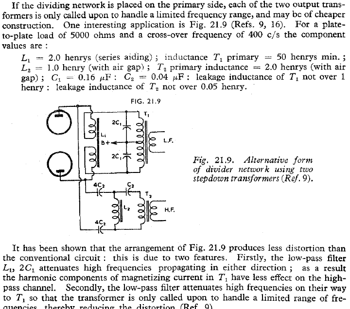

Back to the input transformer. Might be really tricky to get decent low frequency performance from any ferrite transformer. So why not use the series transformers trick from RDH page 888 (attached)?
The idea is to wind two difference transformers, one for high frequency, say, on a ferrite core, and the other on a mu-metal core, or maybe even a core from a power transformer. Then connect them in series but use a high pass and a low pass filter to each handle the range that it's meant for it.
I wonder if something like this would work better than the specialized transformer from the article.
