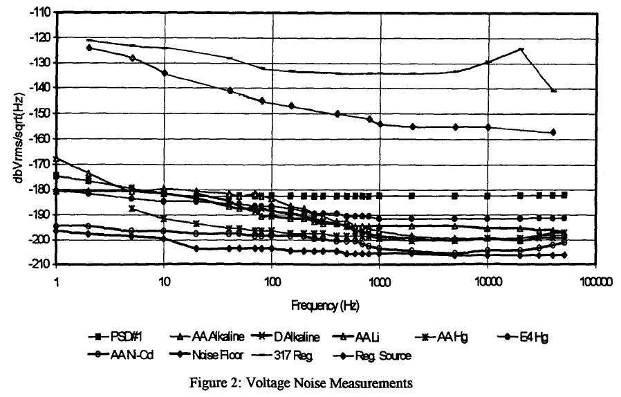

Samuel, I asked you this before, but the question got lost among others. A low noise measurement preamp like this is probably best powered by batteries; if you agree, then why do you insist on high PSRR?
Somewhat related to this issue, syn08 has a whole series of HPS phono stages, and I recall very clearly how, before HPS 5.0, he pointed out the inferiority of some other designs because of their poor PSRR, and how it's not good engineering to put all that effort in the power supply. It surprised me (pleasantly) when he came out with version 5.0 in which he explores a much simpler head amp design with lower PSRR, moving the complexity to the psu. I always thought it was more a matter of taste whether one gets rid of ripple in the psu, or in the preamp. For a home builder there are all kind of criteria which the designer might want to rather take into consideration, for instance, can the thing be built and tested with a minimum of measurement instrumentation? So perhaps the question is, are the specs well defined, do those specs make sense for the intended use (in reality), and does the design meet those specs?
Surely in the end overall performance matters. In general it is however much simpler to design an amplifier with good PSR than a low-noise/low output impedance supply, particularly if we insist on full (e.g. short-circuit and thermal) protection and low extra power consumption. As long as there is no significant disadvantage from optimising the amplifier for high PSR (usually a few simple tricks bring things up an order of magnitude) I see no reason to rely on PSU performance.
I've not yet investigated Battery noise in detail but as far as I know some types ain't that low noise at all; also they show considerably increased noise towards their end of life and there might be substantial differences from specimen to specimen.
Samuel
There is a slew of articles in the IEEE library regarding batteries noise, starting with the early 60's; I haven't followed closely the topic, but last time I've checked anything except the lead-acid cells was improper for anything well under 1nV/rtHz. Of course, adding a cap (or whatever R-L-C network) across the battery always helps, but this is, as usual, a tradeoff with the output impedance, etc... The common NiCd cells were among the worse offenders.
The idea to feed a pre from lead acid cells is to me a major turn off, to put it mildly, although I know some eccentric high end audio designers are placing their bets on such a solution.
A bit old, but it does give an idea.
1995 IEEE INTERNATIONAL FREQUENCY CONTROL SYMPOSIUM. MEASUREMENT OF VOLTAGE NOISE IN CHEMICAL BATTERIES. Chadwick K. Boggs, Alan D. Doak, F. L. Walls
http://tf.nist.gov/general/pdf/1133.pdf
For those in a hurry, attached Figure 2.
I would definitely not like batteries in a phono stage for instance, but the idea doesn't bother me for a lab measurement preamp which is only occasionally used. In fact many instruments have a battery option as well, but can't be sure if it's for portability reasons or low noise (or both).
