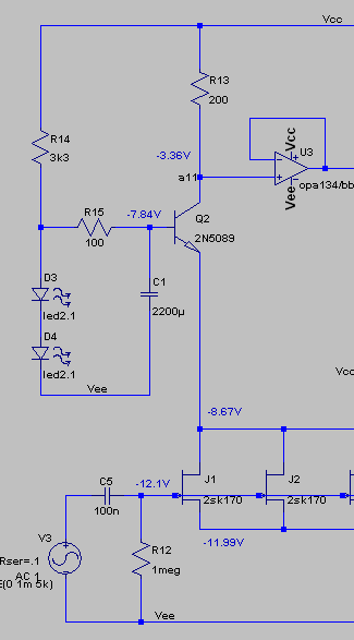

With that opamp follower you just spoiled the entire design (and the noise performance as well). The whole key is using the first low noise stage as a transconductance amp, and using the second stage very low input impedance (also shunting the opamp voltage noise!) the open loop gain is gm*R17, where gm~2*Id/Vt. The opamp current noise feeds R17 as well, but the noise voltage effect is very smal because a) it's a fet input opamp, noise currents are small and b) the equivalent resistor is divided by the opamp open loop gain.
That's too bad. I was hoping to use precision feedback resistors to trust the gain is as close as possible to 60dB so I can use this for measuring noise. Without the buffer the output comes out to be 59.6dB in simulation. I don't know how much the simulation can be trusted, but with the buffer the output shows 59.99 dB.
There is no point feeding the input stage (and referring the input to) -Vee. Instead, ground will do just fine.
Wanted to power it from two 12V batteries which seems to be too low for your exact circuit.

Edit: actually I modified the circuit a little more, to power it from two 12V batteries. Added a buffer after the first stage, seems to get closer to the theoretical 60dB this way. I happen to have a bunch of opa4134s on hand, so I'm planning to use one to cover the second stage, servo, and buffer.
With that opamp follower you just spoiled the entire design.
Indeed the follower is complete nonsense but the main problem is the biasing of Q2--D4 needs to go to ground, not VEE!
Samuel
As shown in your schematic the drain of the JFETs is negative w.r.t. the source--the transistors simply don't work that way. The source-drain voltage should be at or above 2x Vp so ~3 V for the 2SK170.
The follower is complete nonsense.
It's difficult to explain that further. The topology is arranged such that the input JFETs work as transconductance stage (i.e. voltage in--current out) and the second stage (formed by the first opamp) as integrating transimpedance stage (i.e. current in--voltage out). This has several advantages, e.g. so-called pole-splitting which improves the stability of the amplifier. With the added buffer this is completely messed up--I doubt it would work consistently if at all in real world.
If you don't understand a simulation result: don't believe it. You need to understand how the amplifier works before you put it in sim, otherwise you have no chance to judge the sim output. I believe that the low gain you're observed is simply a result of the wrong input stage biasing.
Samuel

I put the operating point voltages on the schematic, should be fine, I think. Did you notice that I referred the input to Vee as well?
I agree, this transconductance amp confused me greatly, so I need to do some more reading.
Samuel
I would still be interested why you think that Q5 (in your schematic) is particularly critical w.r.t. to voltage noise. Voltage noise in this transistor simply modulates the drain voltage of the input JFETs but does not directly add to the current fed to the second stage. Current noise is of some importance but above the 1/f region surely a second order term given reasonably high hFE.
No, my bad. Perhaps that's actually a rather clever move--doesn't that allow you to make R13 (deisgnator from your schematic) larger without saturating Q2? That'd reduce noise somewhat.
