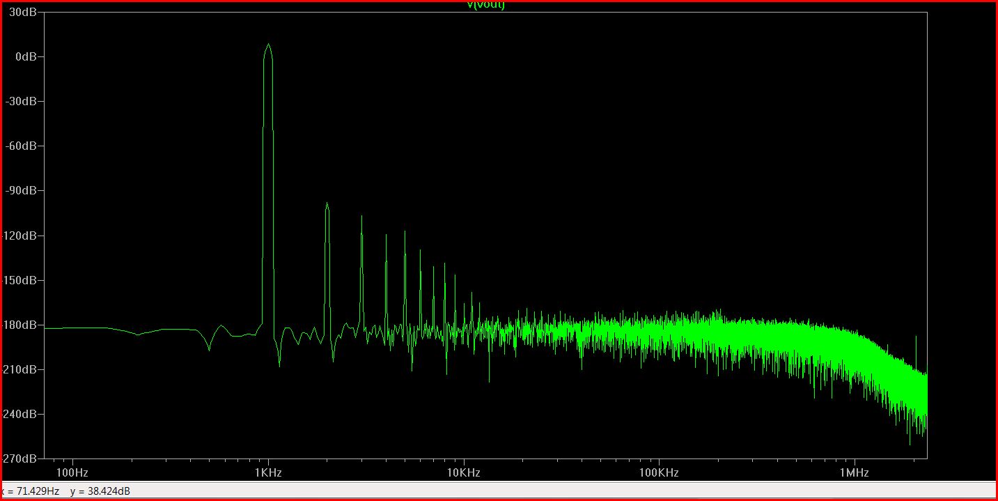

![KDSby83.jpg](https://i.imgur.com/KDSby83.jpg)
Hi Aniket . Here is an idea I have tried . Run it through the simulator . The values should be OK to get an idea . The purple node might be best ? I suspect the purple also can have a more even split of values . On the purple version I was able to use 100 R ( 56 + 270 pF on mine ) . The idea is to win back some HF performance whilst maintaining stability .

Hi Dvv , Aniket . DC offset < 100 mV is OK . To be frank I never had it above 40 mV if working correctly . A Rotel RA 931 I fixed recent was an identical 75 mV left and right . I am told some designers do that to reduce crossover distortion ( no idea if true or why ) . A device to detect and protect is great .

Thanks all,
i would take some time to simulate your mod Nigel.
@dvv, i strongly suggest you to upgrade your simulator to a newer version, the version 12 i use has all the necessary models from ON semiconductor, Texas instruments etc. if not version 12 then upgrade to version 11 atleast. I have used 10.3 version you are using and there's a lot of difference in simulation results of both version for the same schematic. that is why you are getting odd simulation results.
i have one more update, i bought new 2n5551/5401(philips) transistors, and replaced bc546/556 with them. also connected a 1.8K resistor in series after the input cap(2.2uF). did some testing and DC offset now is +8mV and exactly 0mV for channel 1 and 2 respectively. sounds all good.

@Nigel Pearson
Nige, 100 mV of DC is NOT all right simply because it's so easy to make that number much smaller.
If it does 100 mV of DC with no signal, what might it be doing when dispensing 200 Watts into 4 Ohms?

When I square-wave tested the idea it worked OK . I think it does produce a mild overshoot which I think is acceptable . Sounds good ( more open ) .
I have no experience of amps with DC oftest at 100 mV doing any harm . I will ask around my PA friends to see what they have to say .

I don't dispute that, Nige, however you should bear in mind that different circuits will behave differently, and some may not be as oblivious as the one you tested.
Also, I imagone that with your amicable temperament, you didn't really think of any vile loads speakers can present. Otherwise well thought of products, like Apogee, Infinity Reference, Yamaha NS1000, AR 3a Improved, that sort of thing.
You know the drill, Nige, as the designer, it's up to you to try to imagine every possible scenario you can think of. There's no telling what can happen.

Initial preliminary simulation results (may change during development):
Open loop full power bandwidth: 2 ... 78,000 Hz at -3 dB points/8 Ohms
Open loop THD: < 0.3% 20-20,000 Hz, 100W/8 Ohms
Global NFB factor: 20 dB (19.7 dB)
Full power bandwidth, no input filter: 2 ... 340,000 Hz at -3 dB points
Full power bandwidth, with filter: 2 ... 200,000 Hz at -3 dB points
Response: 20 ... 20,000 Hz +/- 0.15 dB at full rated power into 8/4 Ohms
THD, closed loop: less than 0.03%/0.07% into 8/4 Ohms at 28.3 Vrms output 20 ... 20,000 Hz
IM (SMPTE): less than 0.05% for 28.3 Vrms into 8 or 4 Ohms
Voltage Slew Rate with input filter (effective): > 70V/uS
Input sensitivity: < 1.4V p-p into approximately 20 kOhms
S/N ratio: as yet undetermined, hoping for >110 dB „A“ weighted
Exact working schematic is attached. simulation file also.
