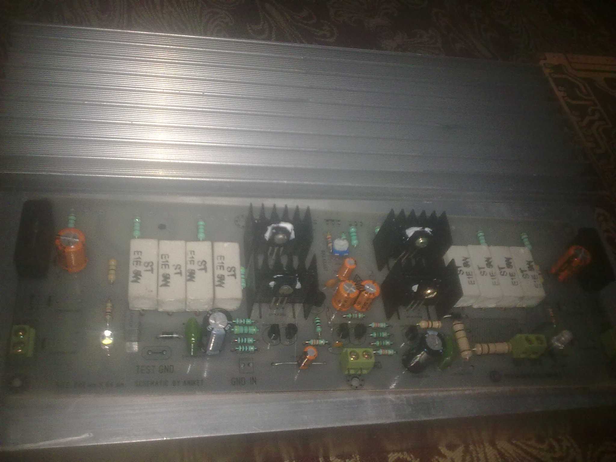

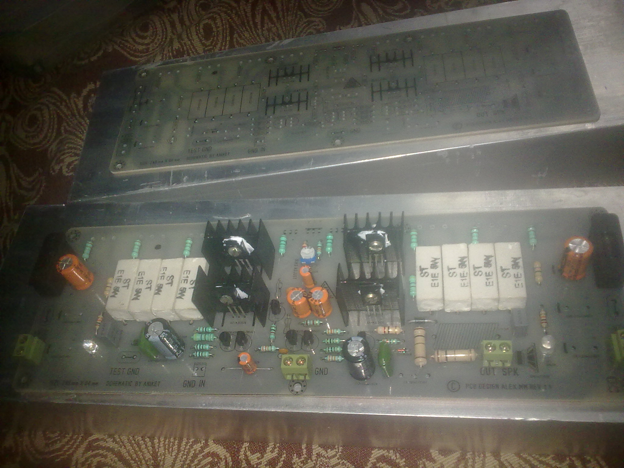

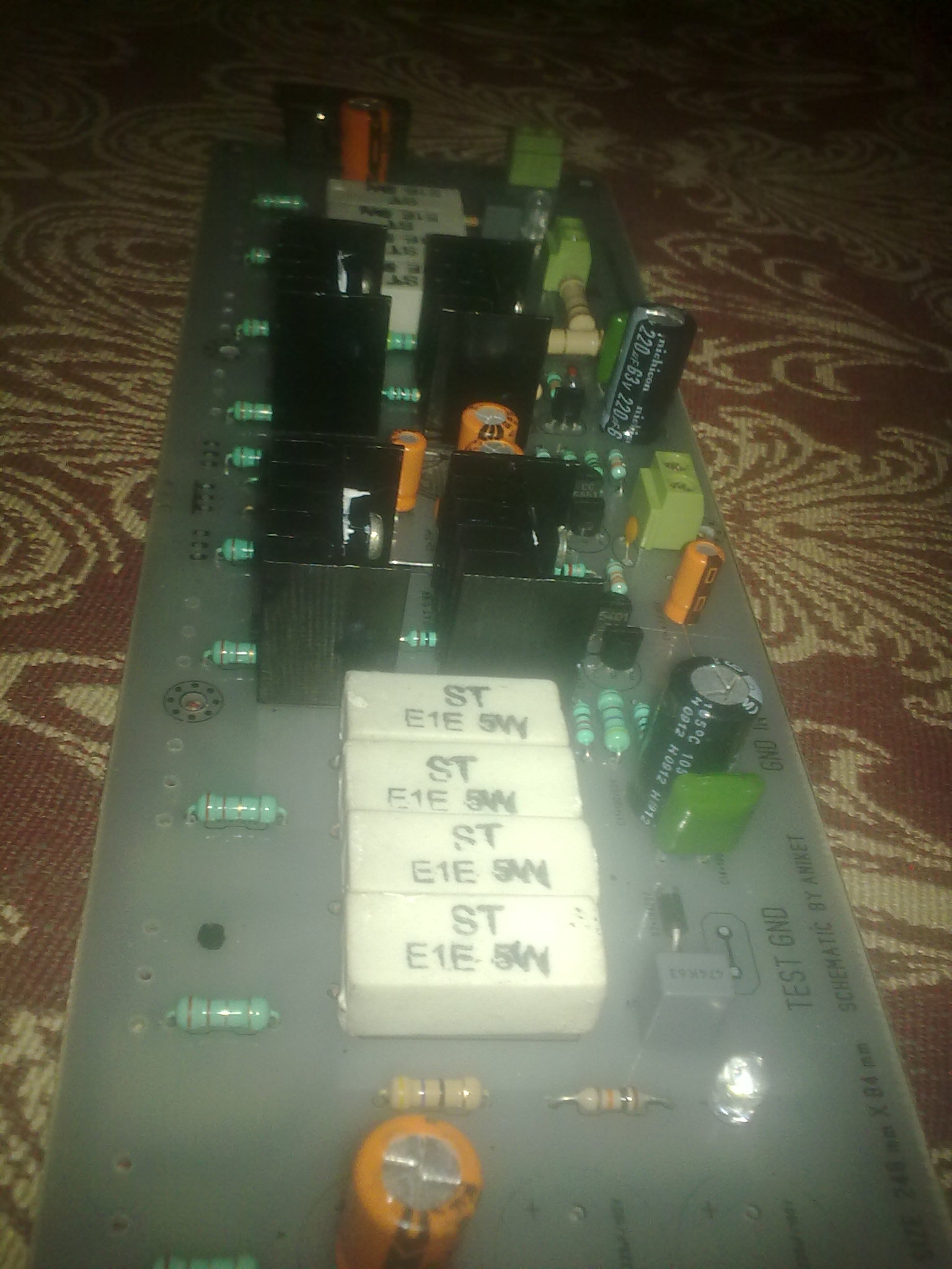

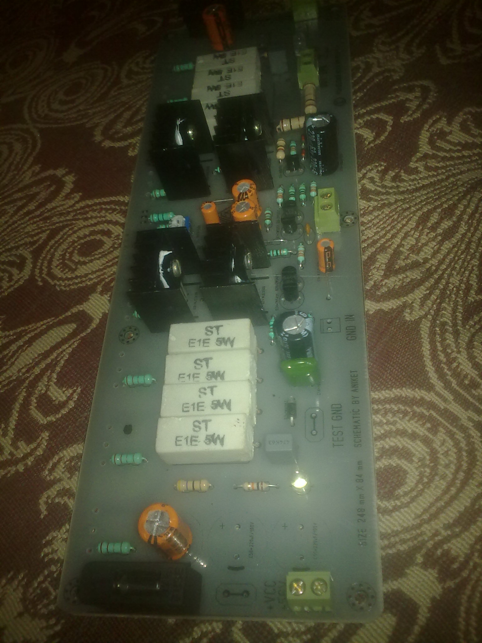

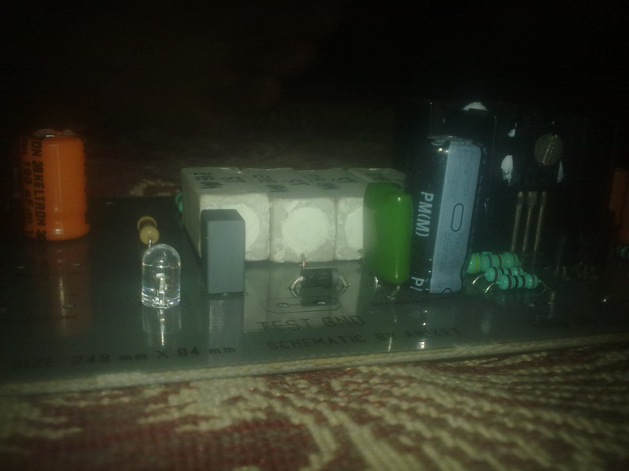

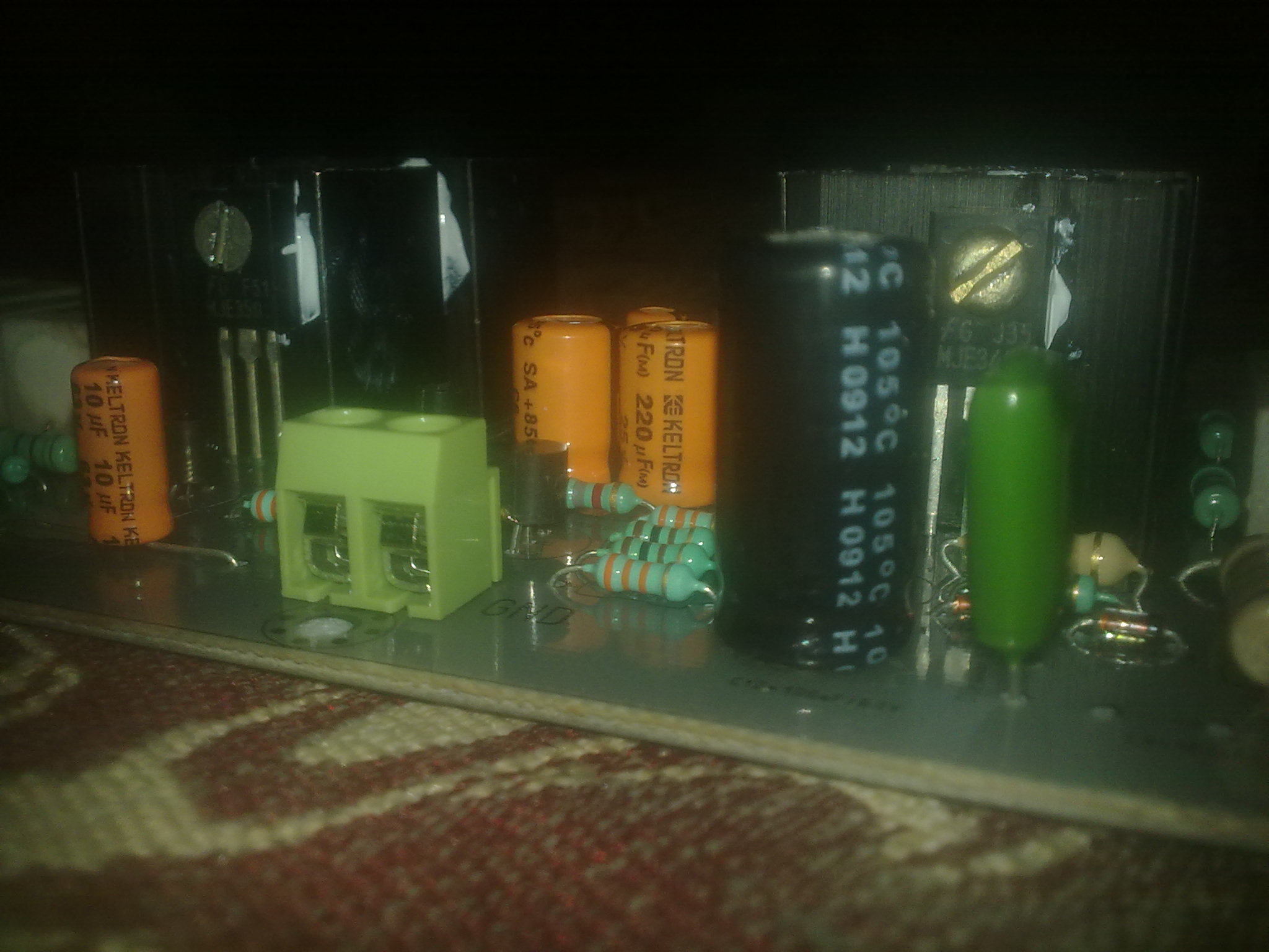

Cost difference wasn't much between 5 and 15 PCB's. So i ordered 16 😉.
Populated the first board.
Again many thanks to Alex mm, without his support it wont had been possible.
Any advice on power transistors mounting and drilling holes.

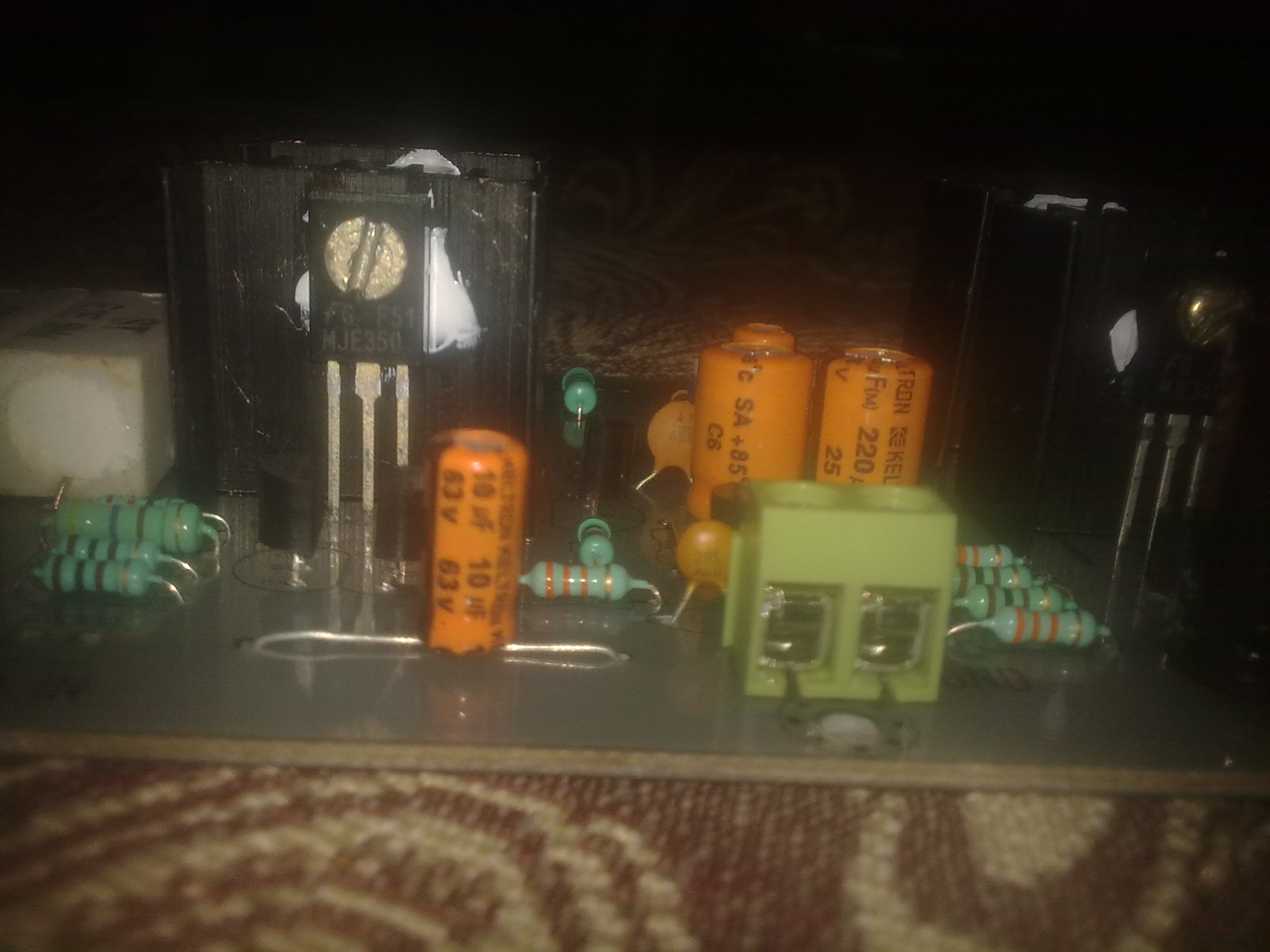

I suggest you add a 470Ω resistor in series with the base of Q4, this will improve the performance with the amplifier driven into a clip.
Q4 from this diagram:
http://www.diyaudio.com/forums/attachments/solid-state/348129d1368337244-simple-100w-power-amp-250w-hifi.jpg
Also see the same resistor properly implemented on this diagram:
http://www.diyaudio.com/forums/attachments/solid-state/328299d1360046931-simple-100w-power-amp-2n3773.jpg
For existing boards I would either cut a trace and insert it, or pull the base lead out of the board and insert it.

Yes, that resistor should be something between 470 and 1k Oms, but like djk, I'd go for 470.

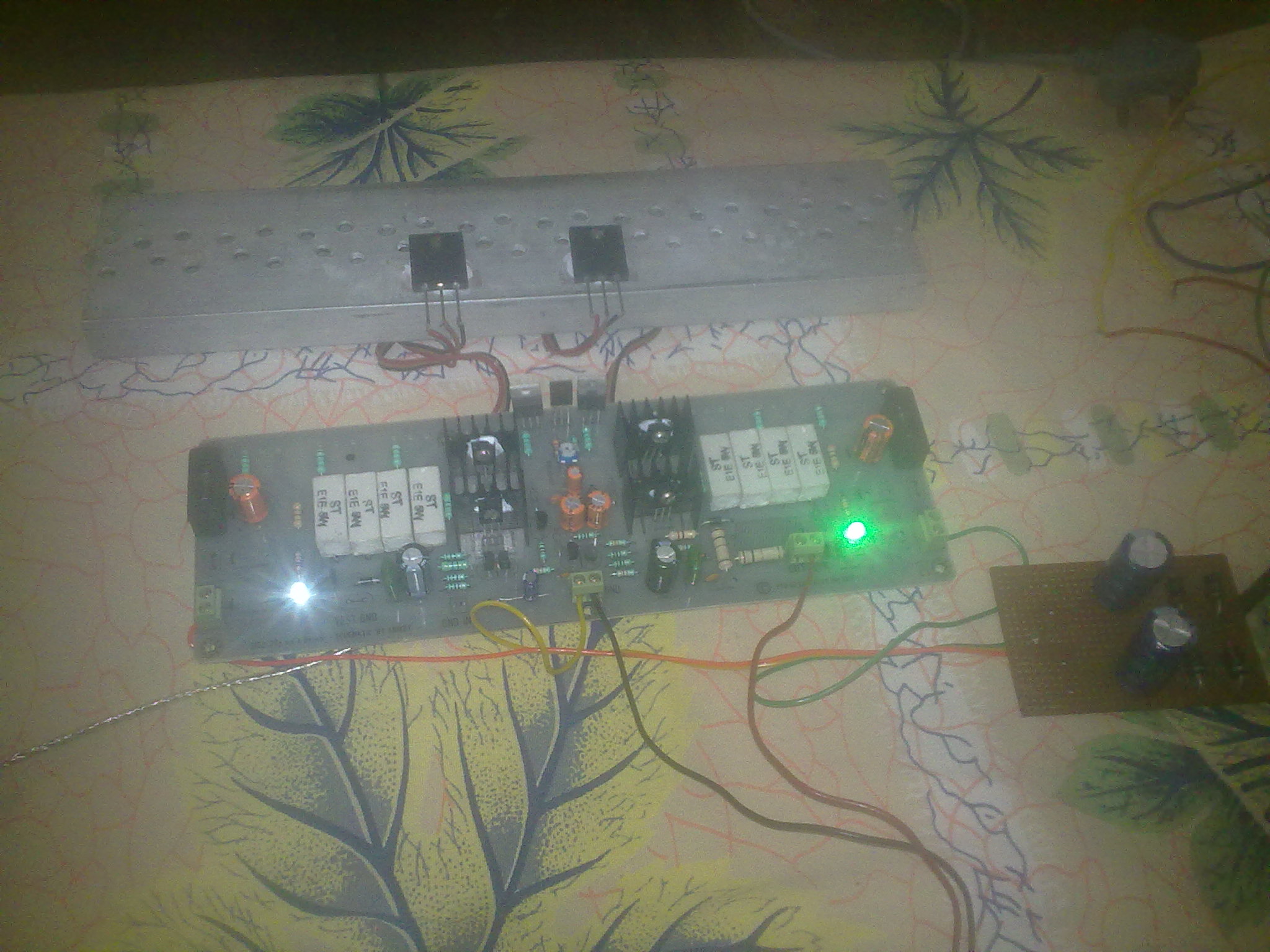

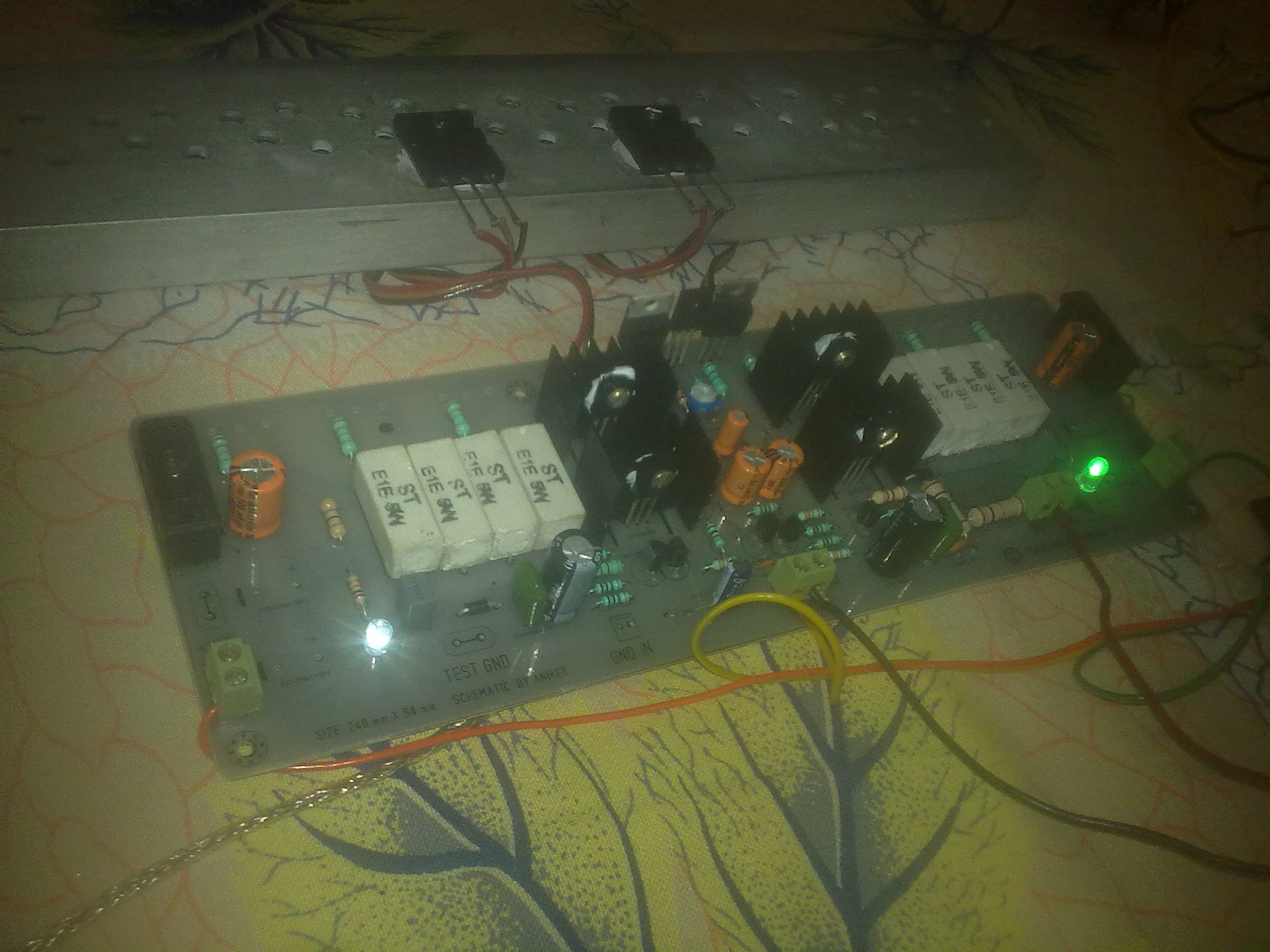

Success!!
Hi all,
We could hear some music now.
With a few glitches initially, amp worked fantastic.
Used a +/-17V supply, a single pair of output tansistors and a 50W 4 ohm coaxial speaker for testing.
On first power up, with no load and input, the output shows 16V !!!.🙁. The 2n5551 and 5401 turned out to be fake or maybe the pinout reversed, it depends on the manufacturer maybe. In many datasheets it's E-B-C for 5551 and 5401 and pinout is reversed for BC's. I would buy new 5551/5401 from a different make.
Then i replaced the LTP, CCS and current mirror with BC556 and BC546, inserted a 470R resistor between the base of Q4 as suggested. and 🙂😀
Output shows -2mV DC offset, is this normal, the negative DC offset.??
So, the amp worked great with BC556/546 in the input section. Set the bias at 50mA. Measured the current through LTP, shows 0.74mA for each transistor. measured the VAS current through R6(82R), shows 6.2mA, fine.🙂
Connected the speaker, dead quite, no humm and no hiss, silent.then, connected an audio source(my phone) and crystal clear sound.😀😀

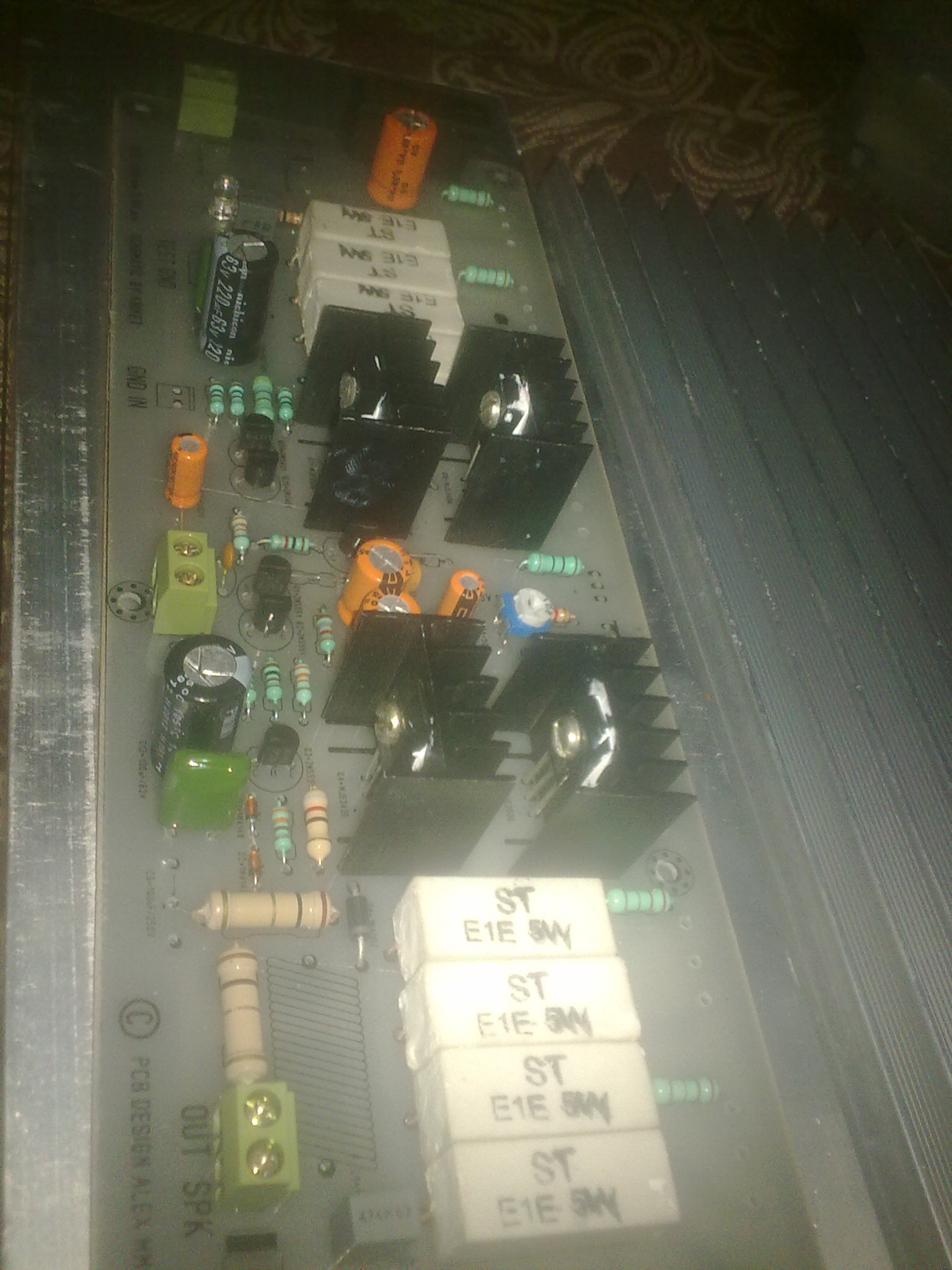

Impressions of the sound:
Bass was awesome, great depth and punch, you can say tight!! great thump at the lower end (30~60Hz). Highs were crisp and open specially the upper end of the vocals at about 10k frequency range. Mids were very smooth and clear, I am happy, certainly the best amp i have heard till now. I am excited, how well it will sound with +/-56V supply and my main speakers.

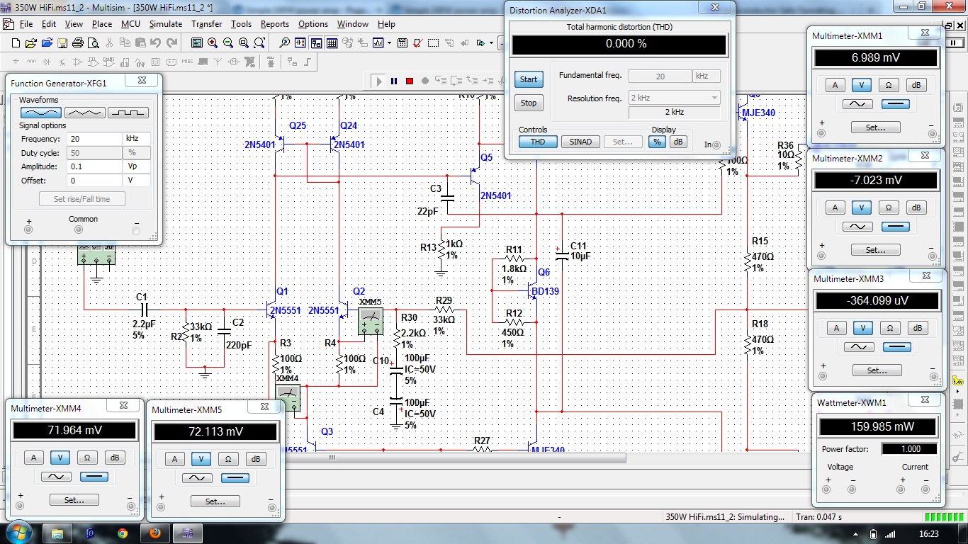

A thumps Up for multisim, the simulation results are very close to the actual circuit, a very good and eay to use simulator, i recommend it.

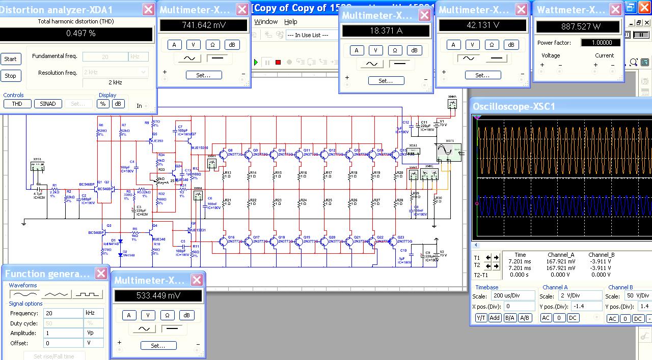

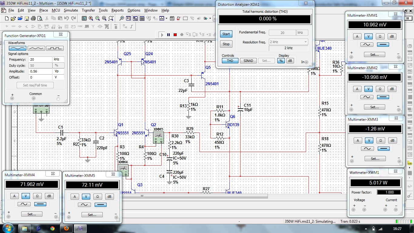

Aniket . If the circuit analysis is still available is it possible to do distortion at 20 kHz at 0.1W and 5 W 8R ? Just curious and thank you if you can .
I thought so . Even allowing for the simplicity of the program I imagine there is truth in it . That's what you hope to see . Maybe someone who has analyzed it in a different program will say if they know differently ?
I will stick my neck out and say this amp should outperform many super amps of the 1980's . Ones which get good money on ebay . The trait I look for is the ability to be a low power amplifier when required .
@ Aniket, Nigel
The program shown is Multisim, the same I have been using for 11 years now and swear by it.
Overall, it's nothing to write home about, it's main redeeming point being that its simulator is outstanding. Better yet, it is very conservative. If it says something will do say 500 kHz, in real life it will do better than that, like 520...550 kHz. If it says THD is say 0.01%, actual THD will be less, like 0.008% or some such.
Obviously, it's up to the user to properly define real world part tolerances, which surprisingly few people do.
Trust it Aniket, it deserves your trust. If there are discrepancies, more often than not you will find it was you actually, not the program. Very often, power amp THD is higher in real life than in the simulation, but that almost always happens because a loudspeaker is more complex than a simple lab resistor. The more complex the speaker, the greater the deviation from simulation, but that's only to be expected.
The easy way out is to search the Internet and find the electrical schematics of loudspeaker crossovers. Then simply make the nominal Ohmic value have a tolerance of say +/- 15%, which can happen once the speaker drivers start to heat up. This should give you a more realistic idea of THD.
