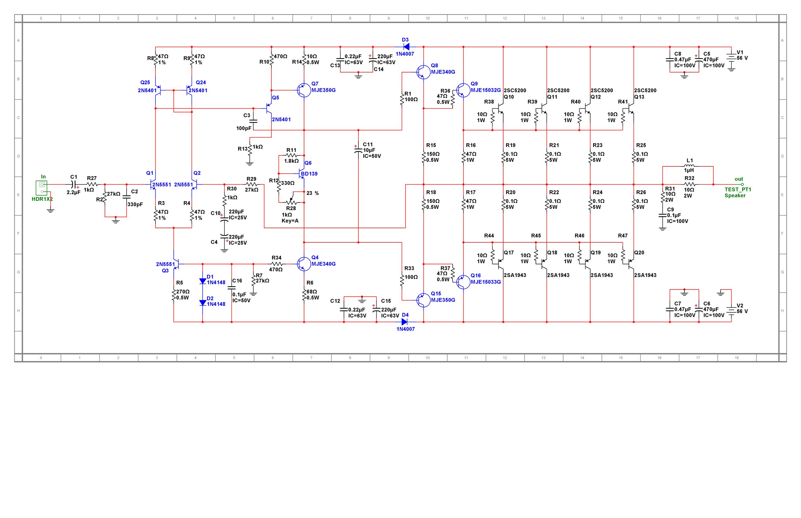

Dvv you should take some credit I feel ?
Huh? Whatever for? What have I contributed to the present state of the design?
Curretly, I am rather concerned with the emitter resistors, which are far too low a value for what I suspect the bias current is. Which means the amp is grossly underbiased if Aniket's to keep the ultra low value of 0.1 Ohm, and will possibly become very harsh once it gets seriously hot, even possibly unstable.
My feeling is that he should be using something in the range 0,22 ... 0,33 Ohms. For 0.33 Ohms, the bias could be 65-85 mA per transistor, for o,22 Ohms it woild have to be 115-130 mA per trannies, off hand. Remember Nige, you and I had this discussion a while ago for exactly the same reasons, you also used too low emitter values.
Hi dvv and nigel,
bias current is 78mA per transistor, got 7.8mV across each transistor.
simulation shows 78mA as optimum bias current, THD20 is minimum at this current and increases again with increase in bias. THD1 increases to 0.001% and THD20 to 0.005% with 100mA bias. maybe the TEF configuration allows lower bias for lower THD figures.
regarding the emitter resistors i have already ordered some 0.22R 5W resistors from a local shop. 0.33R are not in his stock, but he has 0.5R.

Off hand (no calc), at 78 mA per trannie, you should be using 0.33 Ohms, or possibly 0.27 Ohms.
These should give a nice, even bias spread across the board, which would linearize your output stage just that little bit better.
Anyway, the point is that you did do something about it. A word of caution - do not expect anything spectacular to happen, no revelation, no heavenly light shining on you. At best, you might notice a slightly better defined treble range. But at higher powers, your amp will definitely be better served.
And you say Dvv you had no part in it . Shame on you .
Aniket what you don't know is Dvv and I have opposing philosophies . He likes amplifiers like yours with the most amassing complexity of details . He says of me I take parts out until it stops working which is 101 % true . Funny thing is we like the same stuff ! That would be for example that power supplies are important . One can never have one that is too good . My suspicion is your amp is good enough to see the PSU as it's weakness . Cost is the problem not your design .
Dvv . If Aniket is interested would you advocate a small PSU where the 1N4007's are ? Take them out is all that is required . It could even have a low voltage switch if friends use the amp . On that note lowering the input side voltage can have dramatic consequences . Nicer sound is one .
