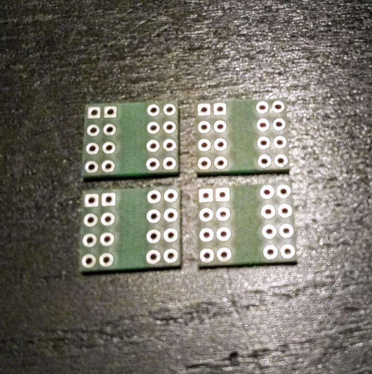

How different is ver.1 from ver.1.3?
I have Simpelstark boards ver.1 still unpopulated.
Hi Thimios,
The main difference is OPS configuration.
The version history is the following:
- V1 like you have is the initial design with the first opamp's inputs swapped mistake;
- V1.1 is the same, having the opamp mistake corrected;
- V1.3 is the latest update with different OPS configuration (no lateral MOSFETs).
V1 is still very good as soon as you can handle the opamp inputs swapped (only one of the opamps, the other one is fine).

PS Any remaining adapter board for error correction?😉

Thanks Valery, I think that is time for the soldering gun.😉
Hi Thimios! I've lost my "magic" opamp adapters some time ago but today I've found them again! I will send you 4 pieces just in case (got a lot of them) in the nearest days although you will need 1 adapter per channel.
Important - Pin 1 is marked by the square pad.
Good!Hi Thimios! I've lost my "magic" opamp adapters some time ago but today I've found them again! I will send you 4 pieces just in case (got a lot of them) in the nearest days although you will need 1 adapter per channel.
