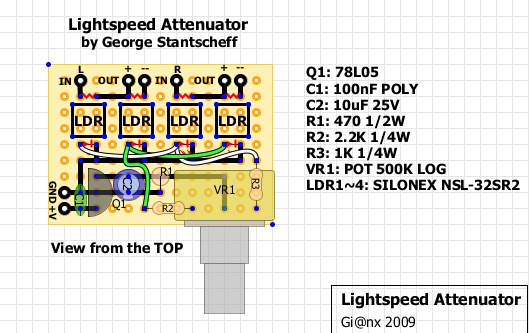

I have made a couple of Lightspeeds for practice with un-matched LDRs. I don't have much channel imbalance, although I have noticed when I turn it on the next day the image has shifted slightly and the trimmers need a bit of a tweak. Is this the real problem with un-matched LDRs?

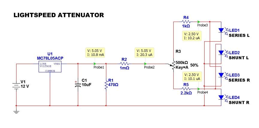

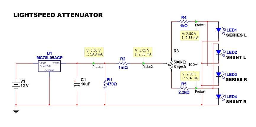

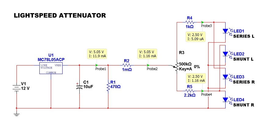

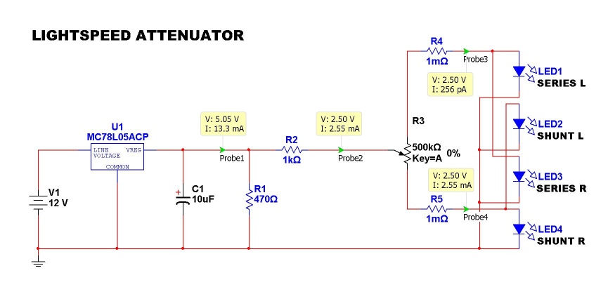

Found an explanation and possible solutions (part 2)
Hi everyone,
i left with the story about the leds being not a "democratic" current devices.
They tend to have what they need, eating current and voltage to less hungry ones, even if they are the same devices with the same specs.
This happens when they are in parallel, just like the lsa. Problem is even worse with a pot that moves up and down and changes the current between its two legs.
Tipically, it's a common and right method to put one resistor for each led, so to avoid the unwanted interferences among them.
That's George's way, but he use a small resistor value to protect the leds, with LDR sets that show about 10k total impedance (100k pot).
I'm posting in this "500k pot LDR set" because i have these from Uriah like many of you and in this 2 posts i only talk about them.
What i read in many posts about LSA is the tolerance of resistor side, never read about LED tolerances.
But they have tolerances like any other device and they may be not too small. I'm talking about Vf and If.
They can have different curves of If, altering the rated Vf.
Example: I can feed with a ccs three leds showing 2,5V or 2,3V or 2,8V at 20mA. Again, with a stabilized 2,5V i can feed other three showing 10mA or 15mA, etc.
The way Uriah does his wonderfully matched LDRs is the second one, in fact they don't match anymore in a CCS supply.
If we want to appreciate his patient and great work we have to "clone" his setup: 5V -> resistor -> LDR.
The same resistors for all of them, selecting the resistance values on the other side. But this can happen with different amounts of voltage and current, depending on LDRs tolerances.
Anyway, one resistor for each LDR, how can it be the same with a splitting pot and a single resistor before the pot?
Leds will start to fight, dropping voltage here and there to the others, depending on the current they need. They are leds, not lamps.
First, the resistor will produce a consistent voltage drop if it is 1k to limit the current, then it will be a chaos after it, i measured 1,4V at extreme positions!
These LDRs set works with a very small current, in my circuit (see LSA_05.jpg) 5uA each at -6dB volume position, showing a resultant 20k, with a total of 40K each channel.
For me it's ok, i previously had a 50k normal pot, so it's nearly the same. If you want a total 20k, use a 250k instead.
The solution seems to be 4 resistors for 4 LED. Not a problem, isn't it? But i like it simple...
Luckily, there's a correlation between If curve and the value of the resistor of the LDR, i mean its progression, measuring with 100, 200, 300, 400k, as Uriah does.
If two LDRs are so well matched to show, for example, 0,1dB along its entire range, Led side will be almost the same.
Uriah matches them in pair, so let's use his work. We can put 2 resistors after the pot, one for each leg, no resistor before the pot, and no chaos appears.
Now look at "LSA_05.jpg", R2 is negligible, it was here to simulate the previous 1k. Situation (V and I) is identical to LSA_02.jpg of the part 1 post.
But now we have 2 resistors after the pot and the advantage is shown in LSA_04 and LSA_06.
Now the pot always sees a correct 5V in every position, even at extremes. current is too different from LSA_01 and LSA_03.
We have a minimum of about 2,5uA for each LDR, not pAs! And that 2 different values of R4 and R5?
Note that we have 2 new maximum: 1,16mA for R5 at 0% and 2,55mA for R4 at 100%.
Who listen with a full throttle volume? Most systems clip at 3 o' clock or even before, at 95% you soon have 1mA again.
Logarithmic curve is now a bit compressed at full position and a bit linearized when full down.
I can really live without a 100% volume position but not without a very low position, like background music.
It won't go totally off, depends on the gain of the entire system, with my 40Wch amp and 92dB speakers, i can only hear a whisper.
I have that old habitude to close the volume when powering off the amp, now i know that i cannot overload that 500K 1/2W pot with 1mA flowing.
For all other positions, R4 and R5 are negligible with a 500k, but if you need a 250K, you need to modify them.
Now it's really working, i replaced my old pot, so when i power off the amp, the LSA will also go off. Super safe i think.
This is possible with the matched sets showing 10K with a 400K resistor in series, as Uriah's chart reports.
Now the "look" is just like the last image below, not too elegant, i know...
That's it, please tell me what do you think...
Thanks,
Gianni

My comments:
Try it, I think I will and I dont want to have to replace pots in my preamp all the time.
It should work fine and it should be a bit louder than normal at min listening position because we can not now get the shunt LDRs as bright as normal. This is fine. Dont sweat it, just try it.
Instead of resistors of that exact value following the pot it would be fun to use trimmers but do not fall below the value of his spec'd resistors if you are doing this for safety of the pot. So considering you do this and you want safety then you stay above that value and tweak the pot. WHY? Because now you can change the curve of the attenuator and you may find a curve of volume increase/decrease that you find appealing and very fine for your listening.
My only complaint about the write up is the suggestion that a 250k pot should halve the value of the LDR. Its not that linear. If you want a lower impedance on your LDR pot then you should read my datasheet I sent with the LDRs and figure out the value of pot you might use from the values at 100k,200k,300k,400k. The value at 200k is usually not half of the 400k value.
Thanks Gianni. Have you yet built it this way and has it been fun!? 🙂
I love this circuit and its simplicity allows so many people to enjoy truly exquisite clarity. I hope Gianni will keep tinkering with it and reporting if he has a want to do this and I know I will keep messing with it. Kind of never stops!
Uriah
Uriah
Shunt LDR get half the current of the "1k before the pot" version.
It's not so bad with that set that works with very low currents.
It's the series that remains a bit on, nearly a half respect to the -6dB position, so the resistance won't go too high.
But this also flattens at the extremes the floating input impedance that i get before.
Let me know if you will try these modifications.
Gianni

I don't understand why the 1k0 and 2k2 in series with the LEDs are different.
Could you explain.
Similarly, if one requires a wide range of volume (SPL) adjustment then the shunt LDR must go to low resistance. This requires it's LED to be fed with high current and this demands that the series resistors must be low in value.
Why adopt 2k2 as the series resistor? 200r would allow a much lower LDR value and protect the LED from over current?
I see a pair of parallel LEDs fed from a single 2k2 or single 1k0. Could you update the drawing to show the 4 resistors?
Why do LEDs with 5uA and 1.1mA passing show the same Vf of 2.50Vdc? Same for 2.5mA and 250pA?
Andrew, i know it's a bit too long post, but i think i already explained there at 95% of your questions.
Except for the last: Multisim 10 have its limitations, especially with virtual devices like the leds. I don't have modellized ones in the database. It's correct for the current, not with the voltage. In this case it is uninfluent, i was pointing out about current sharings, explaining why 2 resistors, why they are different and why they are only apparently high values, instead perfectly working with the "500k pot LDRs set".
Gianni
