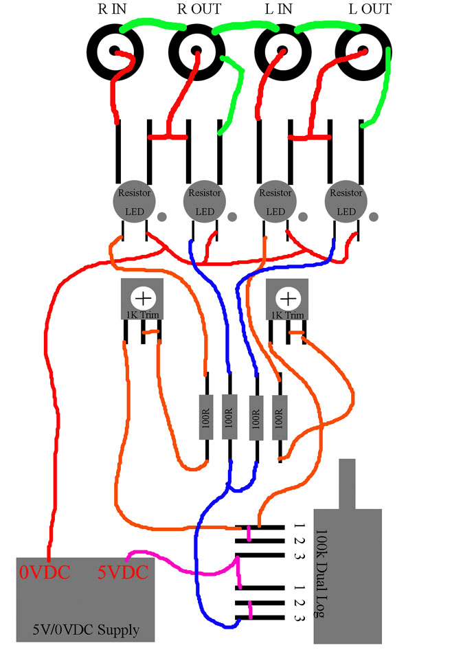

Wiring a LightSpeed Attenuator

Here is my easy to follow drawing showing how to wire it. I think anyone can follow this drawing.

pchw said:Kind of a stupid question, and please forgive my laziness not to go through the long thread.
What kind of pot is needed? Any recommendation?
Thanks!!
Penny & Giles, obviously
Lets keep build questions to the original thread.
The pot is of no consequence. Any 100k junker will do. Its the LDRs that matter and the LDRs are the ONLY signal bearing device.
Uriah

He was kidding about the Penny And Giles. I dont think you can buy a more expensive pot than that but at least you can make one that sounds better with the LDRs
Just buy 2 or 3 of the Radio Shack 100k dual log pots. Sometimes they call them stereo pots. Measure the resistance full on and full off with both pots (there are two pots in a dual stereo/log pot) use the pot that has both pots measuring the closest. We dont care much about this pot at all. It can be a 2 dollar Chinese knock off. All it does it change the power going to the LEDs that are embedded in the LDR.
Uriah
Uriah
udailey said:It can be a 2 dollar Chinese knock off. All it does it change the power going to the LEDs that are embedded in the LDR.
Uriah [/B]
yeah, I was kidding about the P&G
Anyways, $2 pot might be pretty extreme. Have you seen how bad these things track? I haven't read the thread you reference, but I have measured the tracking error of a number of pots and have the data somewhere around here. Measuring the start and stop position isn't bad, but these things can track pretty poorly as well in the middle of their rotation. Anyways...
