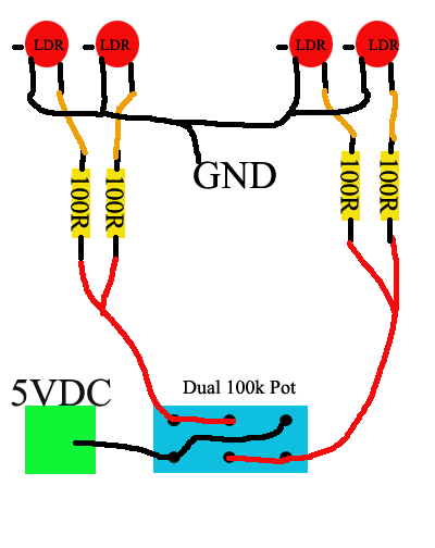

Anyway, got it sorted and it looks like I am running about 102mA and this is with the 4 resistors and the 4 LDRs.
So I have a wire going to the end of each pair of resistors. So one wire to two resistors and each resistor to an LDR. This formation twice.
I put the probe on the junction of the wire and resistors and then on the other side of one of the two resistors. At this point I am reading 104mA. When I remove an LDR not associated with that resistor I get a jump to 108mA-112mA. When I remove the associated LDR current goes to 0. When I put it back it jumps up to 200mA and then cools down over 60-90 seconds to 104mA.
At this point LDRs read 24, 27, 40, 54 Ohms.
I remove one LDR it jumps like I stated but it does this with the removal of each LDR. A jump in current.

When I measured the total current through the all 4 LDR's, I measured the voltage across the 4 100R's and used ohm's law to calculate the each current and sum them up. I never got the total above 70ma at any position of the pot. I was quite surprised to see yours settle at 102.
If I am not mistaken, the DMM should be in series with the circuit. In your diagram, it is in between the pot and the 5VDC. How did you get the current reading?
Fred in my diagram I did not show the DMM.
I put the lead of the DMM on one side of the resistor and the other lead on the other side of the resistor. One lead on each leg.
So what I SHOULD get is about 28mA so X4 would be 112mA. I wonder if somehow I was measuring total current of the circuit.

Hi Uriah,Fred in my diagram I did not show the DMM.
According to your diagram, there can only be 2 LDR's drawing full current. So, even 112mA is way too high. I don't think the way you measured the current was correct. You DMM probes must be in series with the 100R, not parallel. I don't think this number is meaningful.

I agree Fred the numbers must be meaningless in regards to mA.
So, Gaba, dont sweat the circuit. Everyone who has built an LSA so far has used 100R if they followed any of the advice on this forum. Yours is fine I am sure.
Gianni its good we have a few different values people can try if they have the same trouble with their 500k. If we have another pot lying around its probably in a range we can use.
Back to Fred, I ordered 2.2k pot, dual linear. Linear because it is what they had at that low resistance. I could probably find log no problem but I want to see the difference to.
So LM334 feeds 2 LDRs. So 2 LM334. Dual gang pot, each gang acts as Rset for one LM334 with A to W parallel to Adj and -. LDR + goes to LM334 - and then LDR- to GND.

the standard way to measure current passing a resistor is to monitor the voltage drop across the resistor, then use Ohm's law to calculate the current. I = V/RI don't think the way you measured the current was correct. You DMM probes must be in series with the 100R, not parallel. I don't think this number is meaningful.
Thanks Andrew, That the only thing that makes sense to do here as the DMM is not giving an accurate read.
