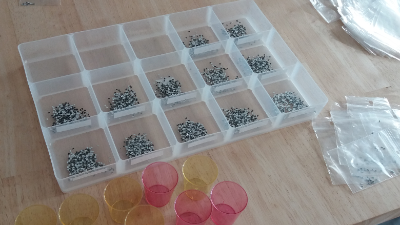

The difference with the new batch is that they now come, like the previous ones, set to +/-15V 'analog' out, but they can be changed to +/-12, +/-8 or +/-5V. Or a combination. There's a small bag with resistors and a User Guide how to add them to change the output voltage.

I have revised the User Guide for the variable version on two points:
- added the max load current per output voltage table;
- changed the customizing resistor table to identify resistors for pos. and neg. output values so that combinations like +8V and -12V can be implemented.
