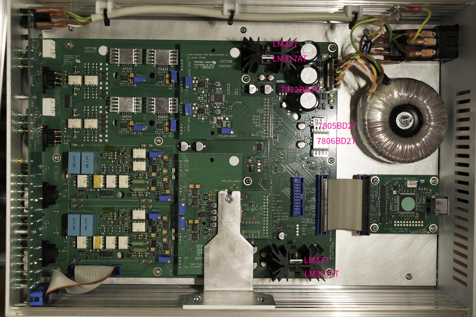

Seems all within a SS range. Do you know current draw?
I have pinged Jens. Let's see how he feels about this.
Jan
Jan
Not per regulator, only the three currents at the transformer output. They are all about 300mA during normal operation.

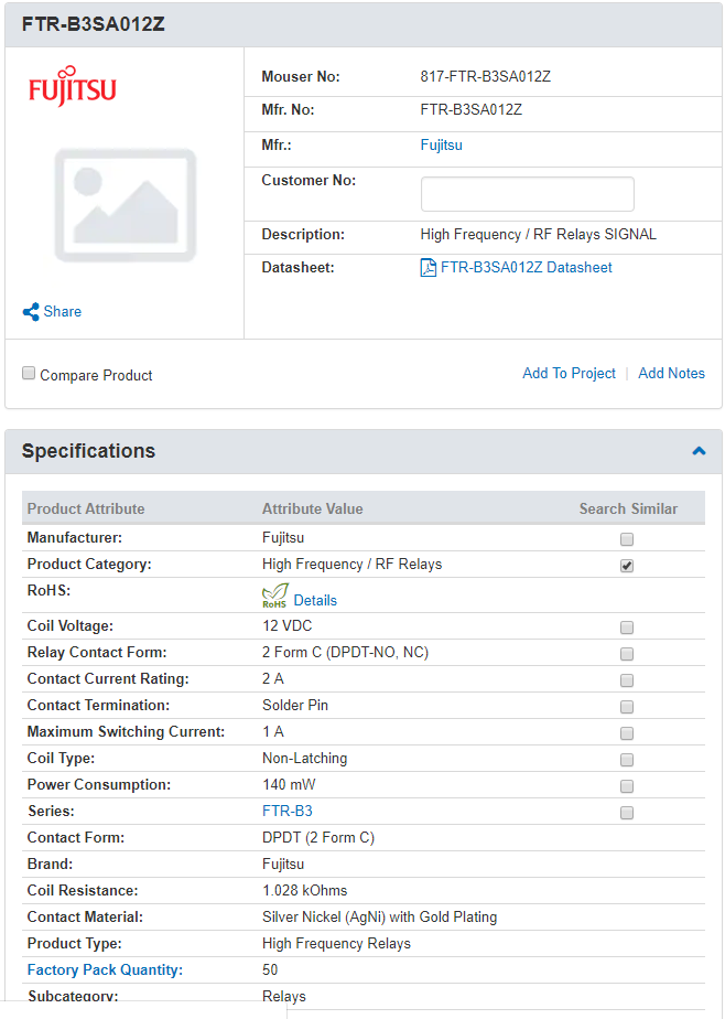

I assume the 12V is for the relays and I have not measured the current while relay switching.
OK, thanks. Definitely SilentSwitcher land ;-)
The relay, if it uses the +12, will happily run on the +15 too. Remaining +5 and +6 can be another SS. I wonder what that +6 is used for?
Jan
Jan
There are no provisions for that. Two SilentSwitchers will have minute small output voltage differences, and if you parallel them the one that is slightly lower would start to draw current from the one that's slightly higher. So that won't work, sorry.

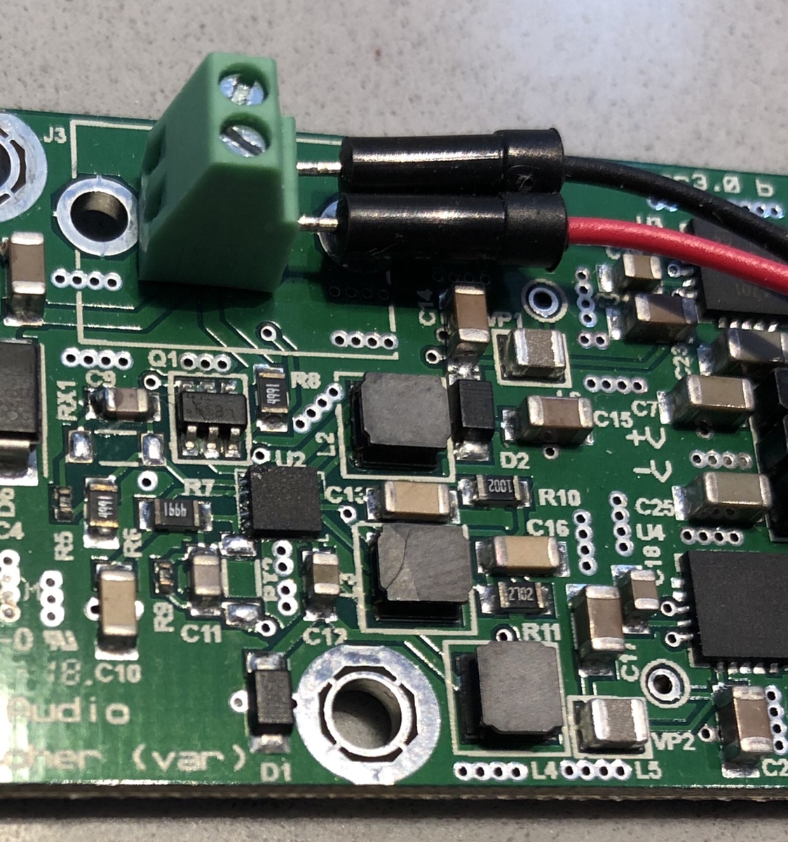

Hi Jan, I am afraid that I may have hurt my SilentSwitcher. Not exactly sure what is causing it, but this is what I see:
- the -V output gives 0 V: almost no voltage difference with ground
- L3 is cracked - see attached pic, don’t know what happened there!
Do you have any suggestions on how to go about troubleshooting or fixing?
Thanks in advance,
Maarten
