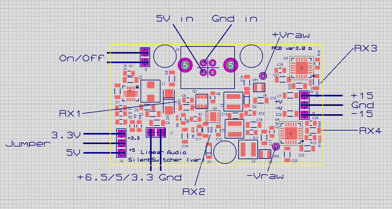

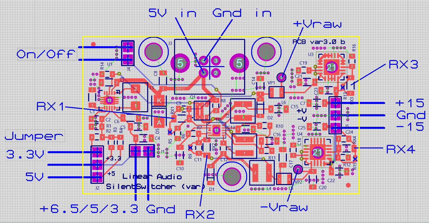

Hi Kim,
Glad you are enjoying it!
Customizing for +/-18V involves removing 4 tiny SMD parts - easy, just heat one side and they come off.
Then you need to solder 4 SMD resistors 1206 size, RX1 through RX4 in the attached. These are relatively large, and a steady hand and a fine-pointed solder iron does it.
If you are game I will give the resistor values tomorrow.
Jan
Jan

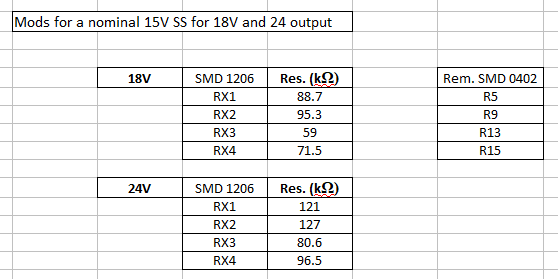

Mods to convert a customizeable SilentSwitcher (var) for +/-18V or +/-24V
Attached is the overview of resistors that need to be changed.
Note that the small SMD0402 resistors that are on the board need to be removed first. Just heat one side for a few seconds and you can then push them off. They are shown with a small blue cross.
Then solder the new resistors, which are larger SMD1206 so should be easy to do. Download the mod guide and follow that. There's a link to a short Youtube illustrating how to solder them. No special tools required, just a steady hand, a pair of tweezers and a pointed solder point. Best time of day is in the morning after your shower ;-)
To limit the risk of making mistakes, follow the prescribed order. First remove one resistor, solder the replacement new one, and measure the voltage as shown. It's really must faster than describing it.
Jan
Jan
