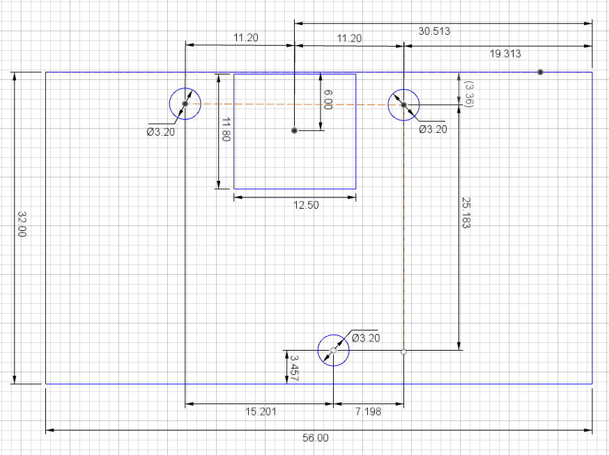

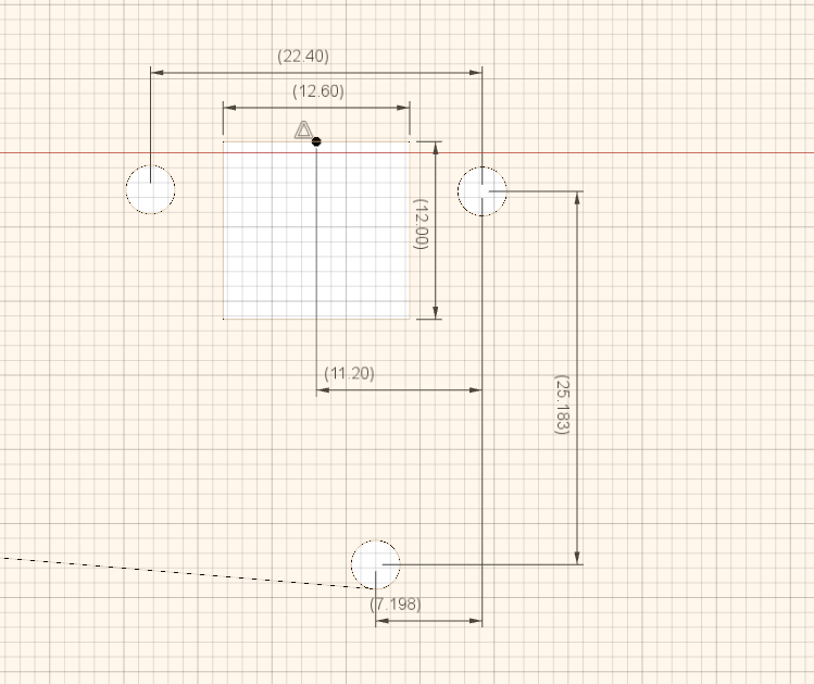

This is bit better perhaps. The dotted line shows the PCB outer dimension. Not sure why I could not get these dotted lines visible on the Fusion 360 in my work PC. Now in home PC it does show them as it should.
Thanks Ergo, I just hadn't gotten around to post it. Can I use it, with proper attribution of course!
BTW the hole pattern seems OK but my CAD repeots the PCB size as 32 x 55 mm instead of your 56. Then again, what's a millimeter between friends ;-)

My SilentSwitcher measures 32.3 x 56 mm and is small enough! 😀

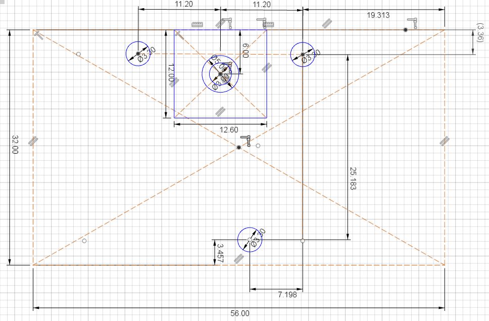

Jan, most pcb cad programs has built-in to make drawings and then you will have exact dimension which are tied to the elements.Thanks Ergo, I just hadn't gotten around to post it. Can I use it, with proper attribution of course!
Jan
Sure, but give me a weekend and I'll tidy it up a bit and make all lines solid lines etc. I used my caliper and yes my boards are still 56mm too. PCB houses are very precise when doing traces but the cutouts are done with bit more reserve sometimes.
