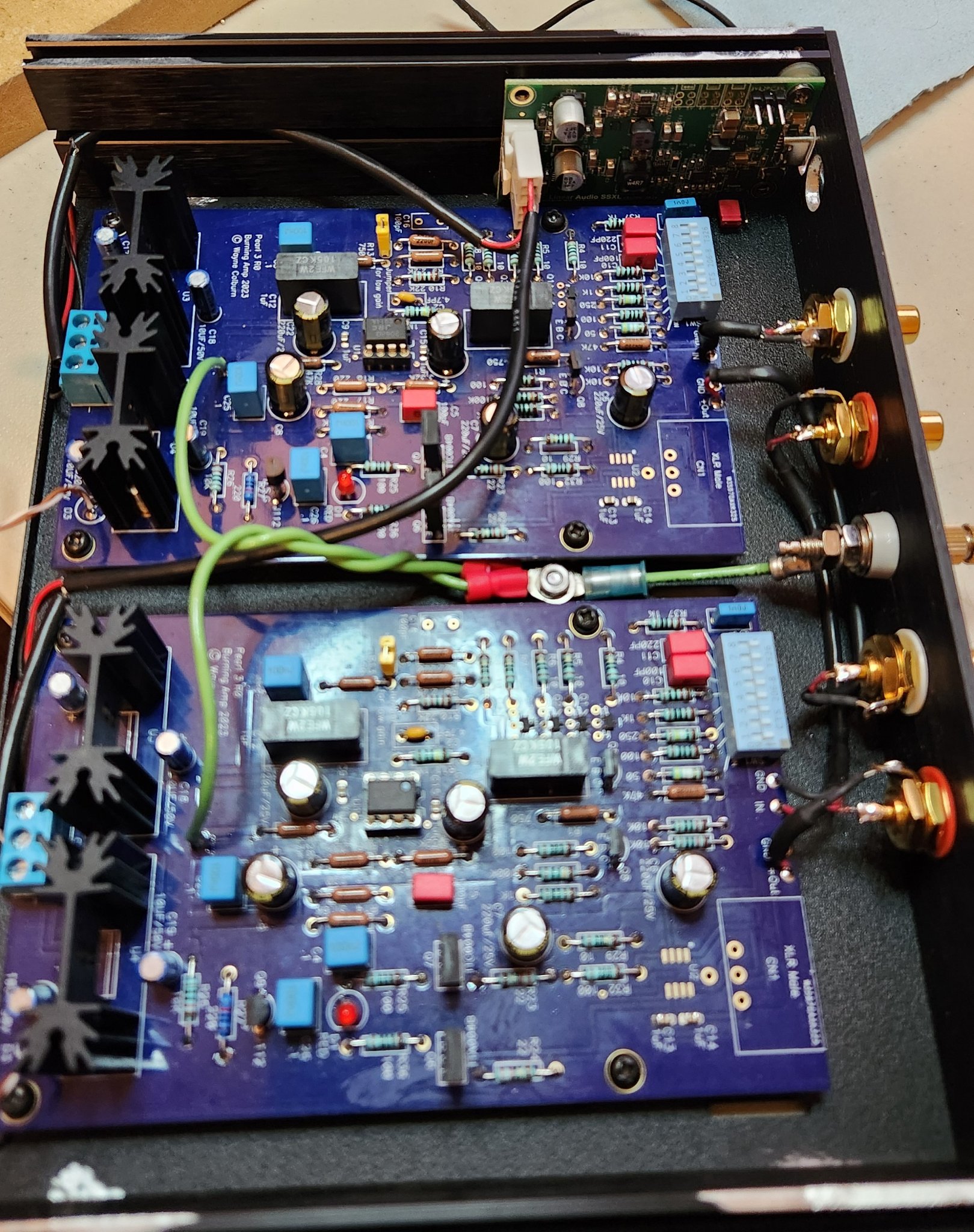

🙂 🙂 🙂 That's gorgeous! I'm looking forward to receiving mine, SSXL + Pearl 3 is one of the first applications I'll use!
I'm using a 20 watt Apple PD cube.
Yes, I left the capacitors. Maybe a resistor instead of a jumper would give some additional filtering, but it's very quiet.

Great job.Silent switcher fit nicely in a tight space for a Pearl 3. The 15-volt regulators were removed and in/out pads Jumper'd. It is very quiet. Only had a brief listen so far.
Are those opamps in the signal path?

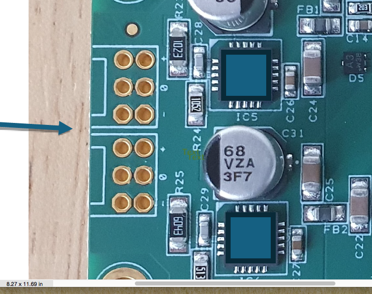

Can the two +/- 15V outputs be connected in parallel for a 30V supply. If they can, can the 0V of each be left to float?
You mean, "can they be connected in series for 30V?
Yes they can. But note that the center of that 30V (the gnd of the +/-15) is connected to the gnd of the USB input voltage.
So if you do that, feed them from a floating USB DC source, like a charger .
Jan
Jan
You mean, . . .
Well, no, I was looking at the two output footprints on the board and thinking if each was +15 / 0 / -15 = 30V total , that being connected in parallel would allow for greater current draw and /or less heating of individual components on the board. Am I anywhere near the mark on that?
Those connectors are already in parallel so each connector (or both together) has the same current capability.
By changing resistors it is possible to have +/-30V output from those connectors but available current would be lower. I have tested the boards with +/-24V output and available current was at least 200mA. Input voltage needs to be at least 9V, preferably 12V or even 15V.
Ah, That's what I didn't know. I just want 30V total so the board as supplied will do the trick. Thanks !Those connectors are already in parallel
