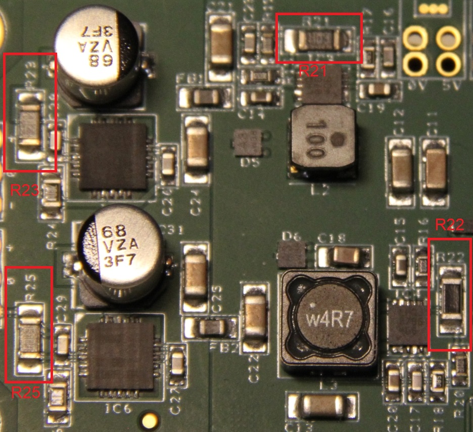

Wishing a prompt recovery to Jan.Yes, by replacing 4 1206-sized resistors. The top board in https://www.diyaudio.com/community/attachments/ssxlv3-jpg.1330175/ has +/-24V output.
And thanks a lot for these possibilities to Jan and @bohrok2610 .. Would the new Silentswitcher be able to supply continuous 200mA at 24-24vdc (or better 200mA at 27vdc)?
I have run load tests at +/-24V@240mA so +/-27V@200mA should be ok though I have not tested that.
Note that higher output voltage requires also higher input voltage as the current draw from a low voltage power source easily becomes excessive. E.g. +/-27V@200mA would require close to 3A from 5V input. Also the efficiency of the DC-DC converter is lower at low input voltages.

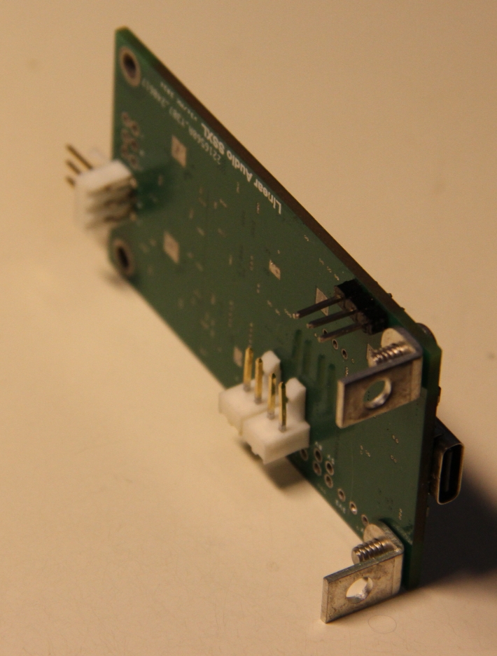

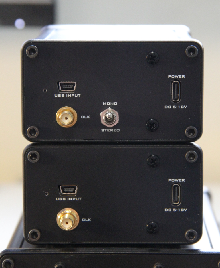

Here are pictures of how the SilentSwitchers were mounted vertically using Keystone mounting brackets. The 2 black phillips screws are attached to the mounting bracket.

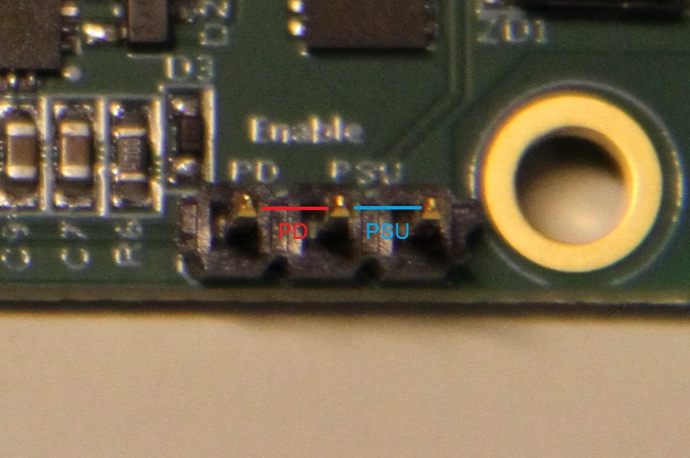

Here is some information related to the new SilentSwitcher boards.
Enable
There is a 3-pin header for enabling the board. A jumper or a switch can be used to select either "PD" or "PSU" setting.
In PD-setting the on-board USB PD controller is in charge of enabling the board. It negotiates the USB PD profile, monitors the input voltage and enables/disables the board. So it works well with USB PD compliant power sources. The downside of this mode is that in case a non-USB PD compliant power source is used the USB PD controller only accepts 5V input voltage. So it disables the board if e.g. a 12V battery is used.
In PSU-setting USB PD controller only negotiates the USB PD profile but does not monitor the input voltage. So this setting is similar to manual on/off switch. Both USB PD compliant and non-compliant power sources can be used.
Voltage setting of +/- output
To set the voltage of +/- outputs 4 resistors of 1206 size (R21, R22, R23, R25) need to be changed.
Attached is a table of suitable resistors values for 5V, 12V, 15V, 20V and 24V outputs. Outputs are independent so an asymmetrical setting is possible (e.g. +5V/-15V). However polarity of outputs cannot be changed.
For high load currents at higher voltages the input voltage should be at least 9V.
