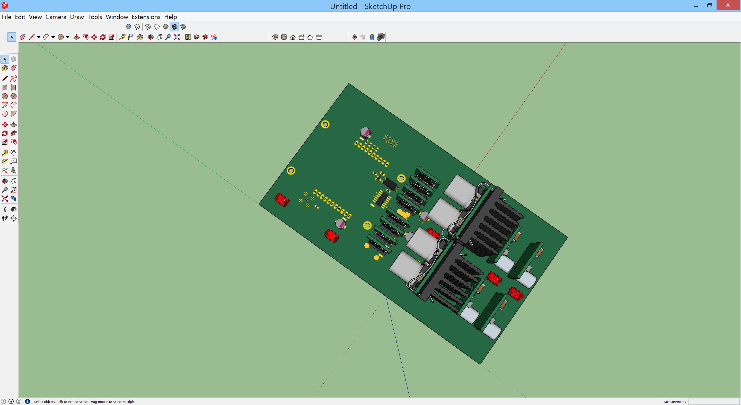

JLSOUNDS give me 3D datas for the I2SOVERUSB converter: I´m working on some missing components but the results are today quiet good, please see the attachment...
Jean-Paul
I reiterate my question about coupling between the different stages to know if I can go completly DC and only place a coupling cap at the output of the last Sallen-Key filter?
I´ve asking Patrick (EUVL) for helping to built a last version of his simplistic OPAMP to use as output buffer.
Jean-Paul

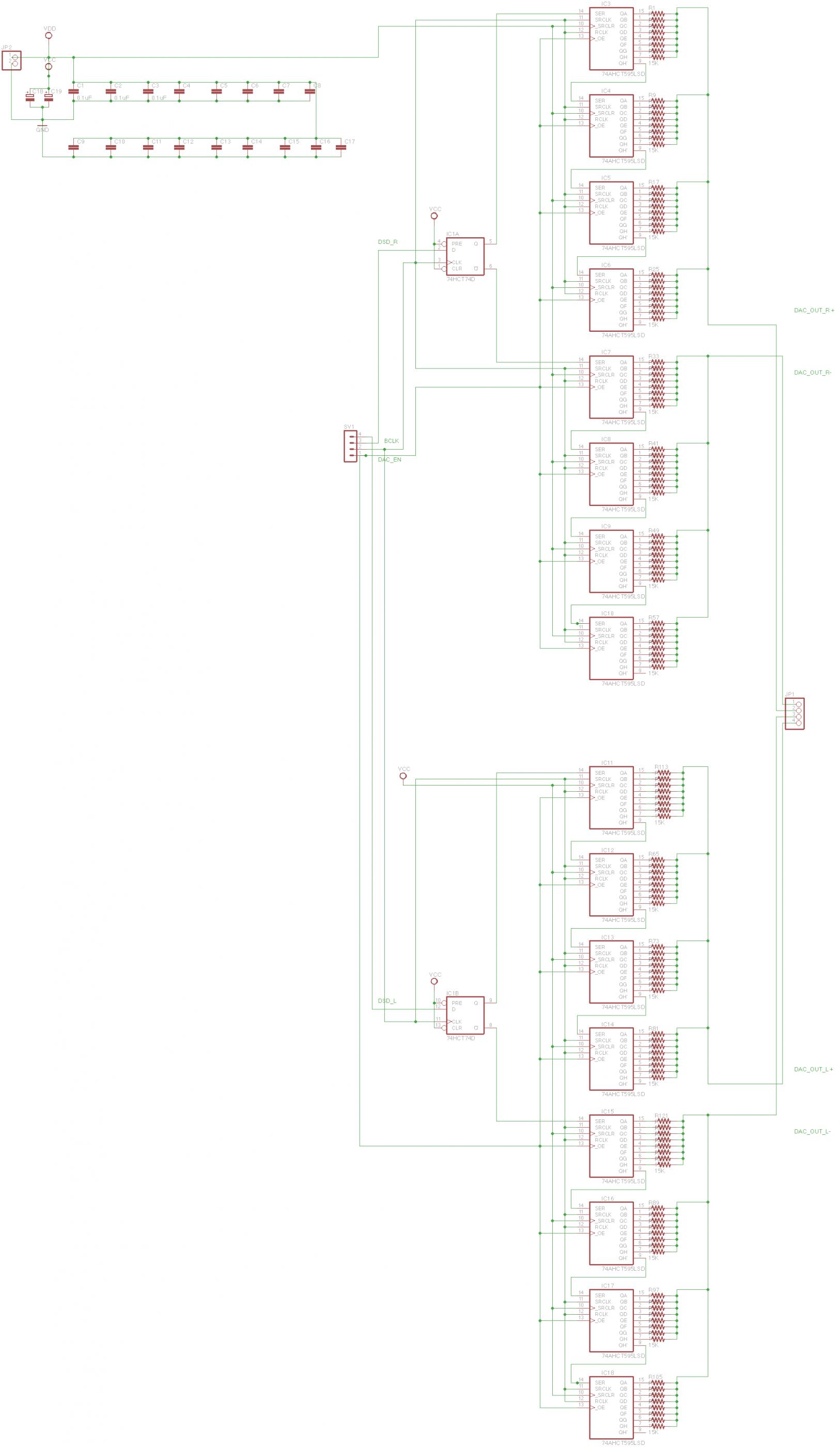

Inverter for Balanced?
Does anyone know? Would placing an inverter on the DSDR and DSDL lines provide the input to a balanced DSC1?

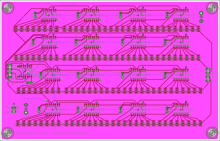

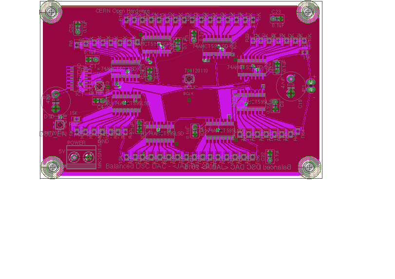

Balanced DSC
So balanced DSC is as easy as:
View attachment DSC1b.pdf
And then dual I-V Sen and filters.
