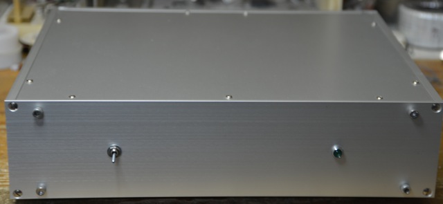

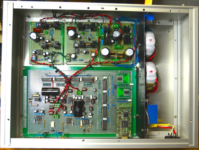

This is my boxed version. I added a DIYINKH power supply to feed the Amanero board. This made a huge improvement.

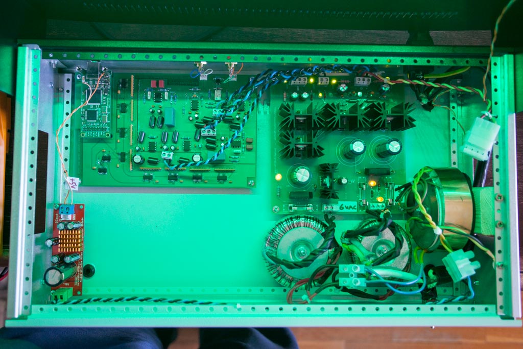

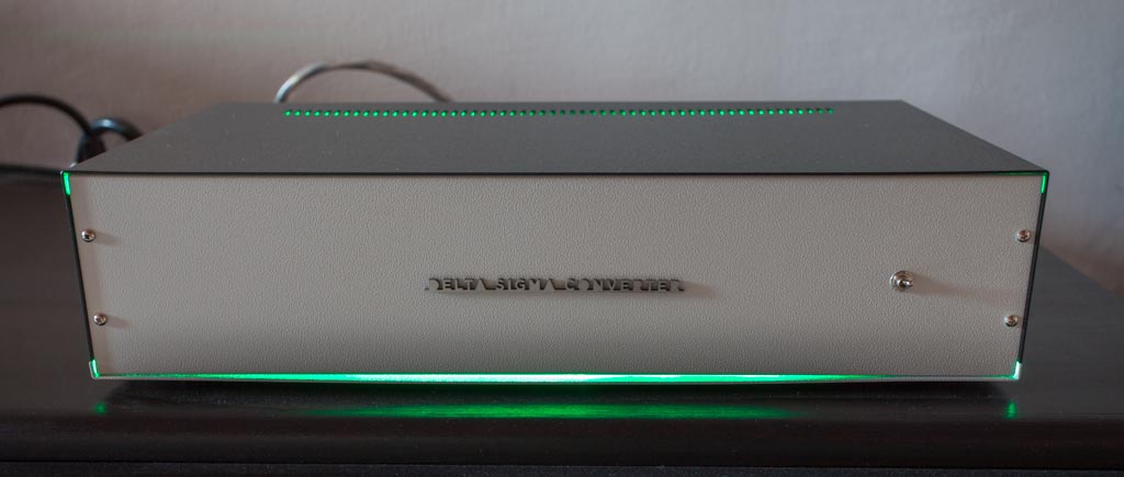

I am interested in removing the 2.2uf too. I have built another version of the DSC1 to give me more flexibility to make mods.
My new version uses Jung super regulators for all voltages, and has an isolator chip after the Amanero board. My Bootcamped Mac mini uses a highly outboard regulated linear power supply and there is a separate Jung power supply to feed 5 volts to the USB. Overall I am very happy with the result but am looking to pull out the most from the dac, hence my interest in your proposed mod.
Pictures of the DAC are posted below.
N.
