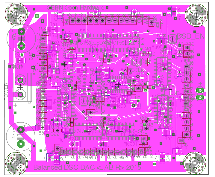

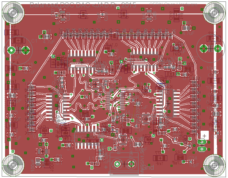

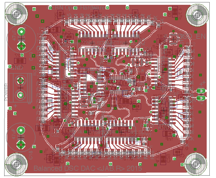

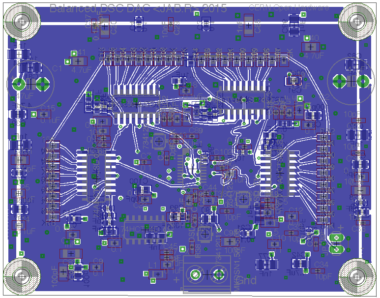

Here are two versions of the board/routing. Opinions as to which tradeoffs are best? In both cases the Signalyst DSC1 design with the shift register FIR filter is used. Boards are 4 layers with solid GND and VCC planes. A potato semi D flip flop is used to generate the DSD' signal for the (-) side of the balanced design. A potato semi 1:10 clock buffer is used. This has probably the lowest output device to output device skew (<80 picosecs) in a 1:10 clock buffer. power supply bypass cap networks are used. The susumu rg 15k 0.05% 10ppm 0603 resistors are used in the ladder. VCC = 3.3V. Clock trace lengths are matched to 0.2mm
#1: all chips (shift registers) and clock traces on the top layer, so no vias on clock or data lines. Clock traces are ~17.5mm
#2: the (+) and (-) shift registers are mirrored on the top and bottom layers of the board. 1/2 of the clock traces traverse a via and so a via is placed on all clock traces to match capacitance. An extra 1.6mm is placed on the top layer clock traces to match via traversal. Clock traces are thus ~24.2mm
So which should be better?

The idea of mirroring the logic chips is a sound one. One could even use the same power trace, or put both chips behind the same inductor/capacitor chain and so the switching spikes would then theoretically cancel, but this all depends on the chips switching at precisely the same time and that's where a delay caused by the vias could entirely negate the benefit of mirroring the chips.
This is technically better for the digital side...
Intuitively I like this better as it has potential to utilize common mode rejection for the analog side if it works well enough at the digital side. I think this has some good potential and it would be great if this can be just tried out and see how it performs!

This (#1) is technically better for the digital side...
Intuitively I like this (#2) better as it has potential to utilize common mode rejection for the analog side if it works well enough at the digital side. I think this has some good potential and it would be great if this can be just tried out and see how it performs!

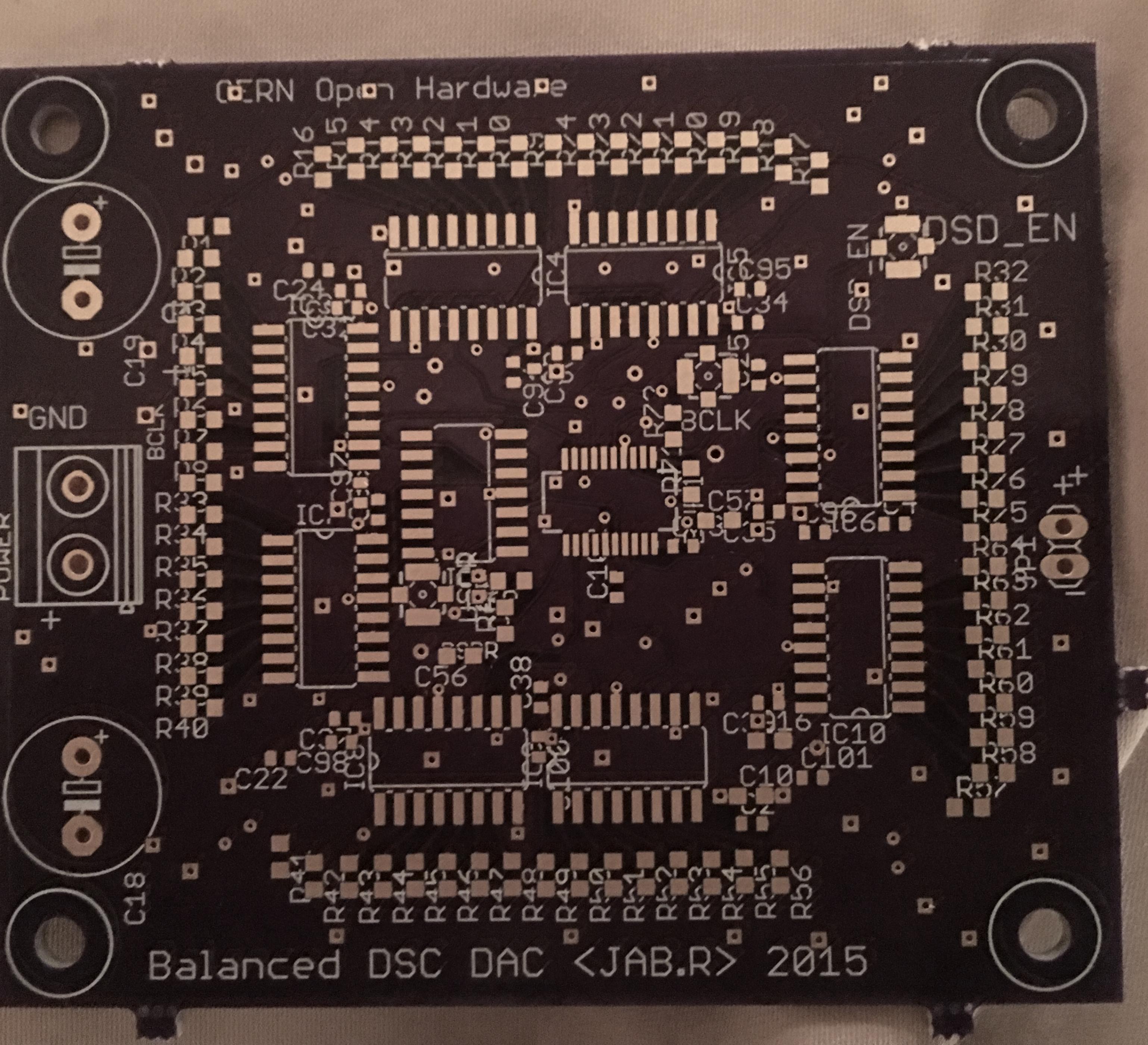

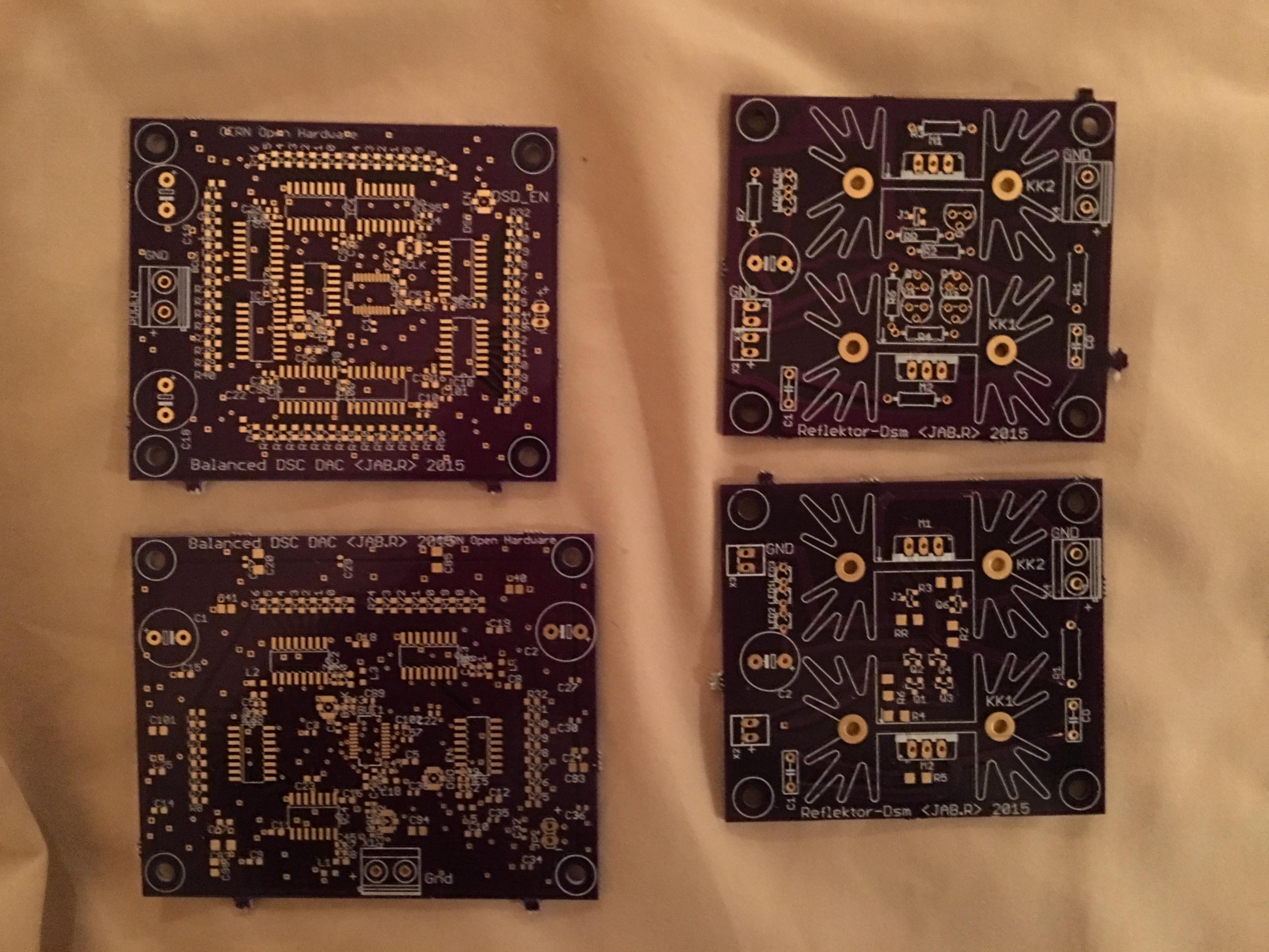

Boards arrived:
The parts are inexpensive -- majority of cost are the Susumo RG series 15k 0.05% 10ppm resistors.
Both boards are SMD double sided, the first mostly bypass caps and the chokes that filter each chip. The mirrored version obviously has chips on both sides.
Its going to take some time for me to build, get all the components together to test, needing to build the I-V (sen variant bf862/j111 cascode) and SK filters (jfet buffer based) as well as Salas reflektor-d supplies for digital side, NiCad battery suppies for I-V etc.
