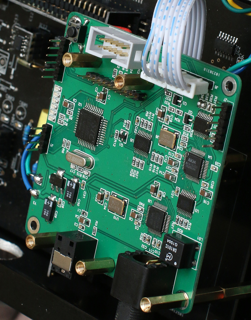

China's implementation of open hardware Signalyst DSC1 from Ultimate current, looks better than the original 😉, but do not know how it sounds.
DSC1 DAC DSD Amanero XMOS

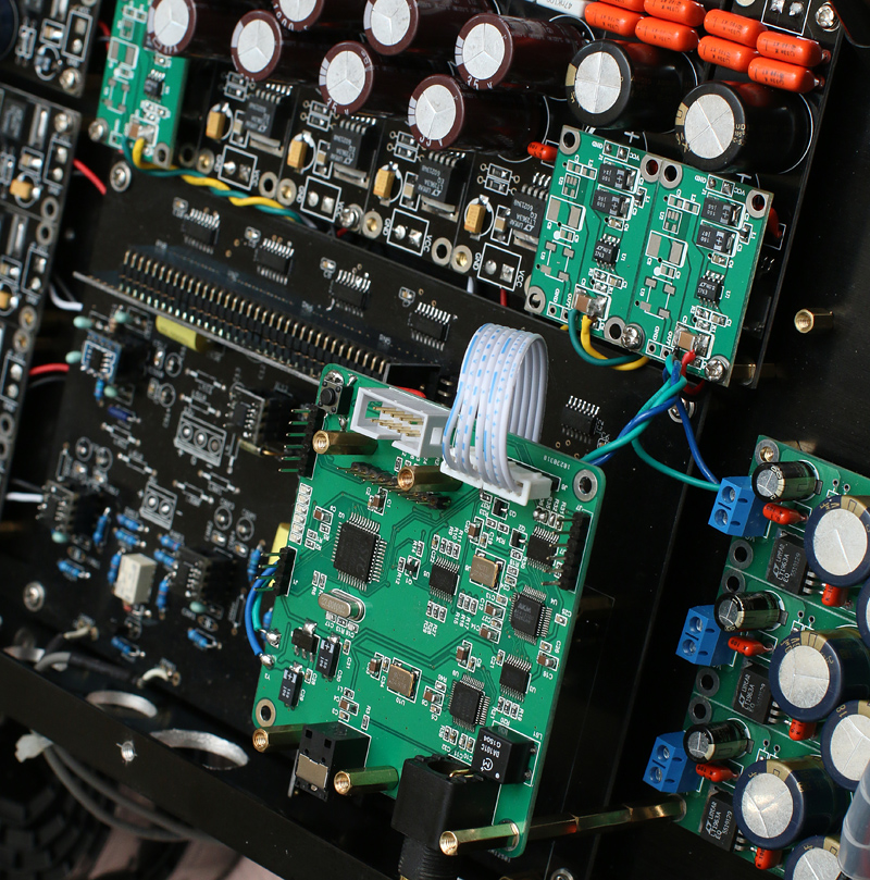

This looks like the power supply board.
DSC1 DSD Powersupply

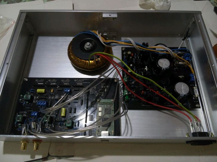

Another Kit DSC1 Kit
DSC1 Kit

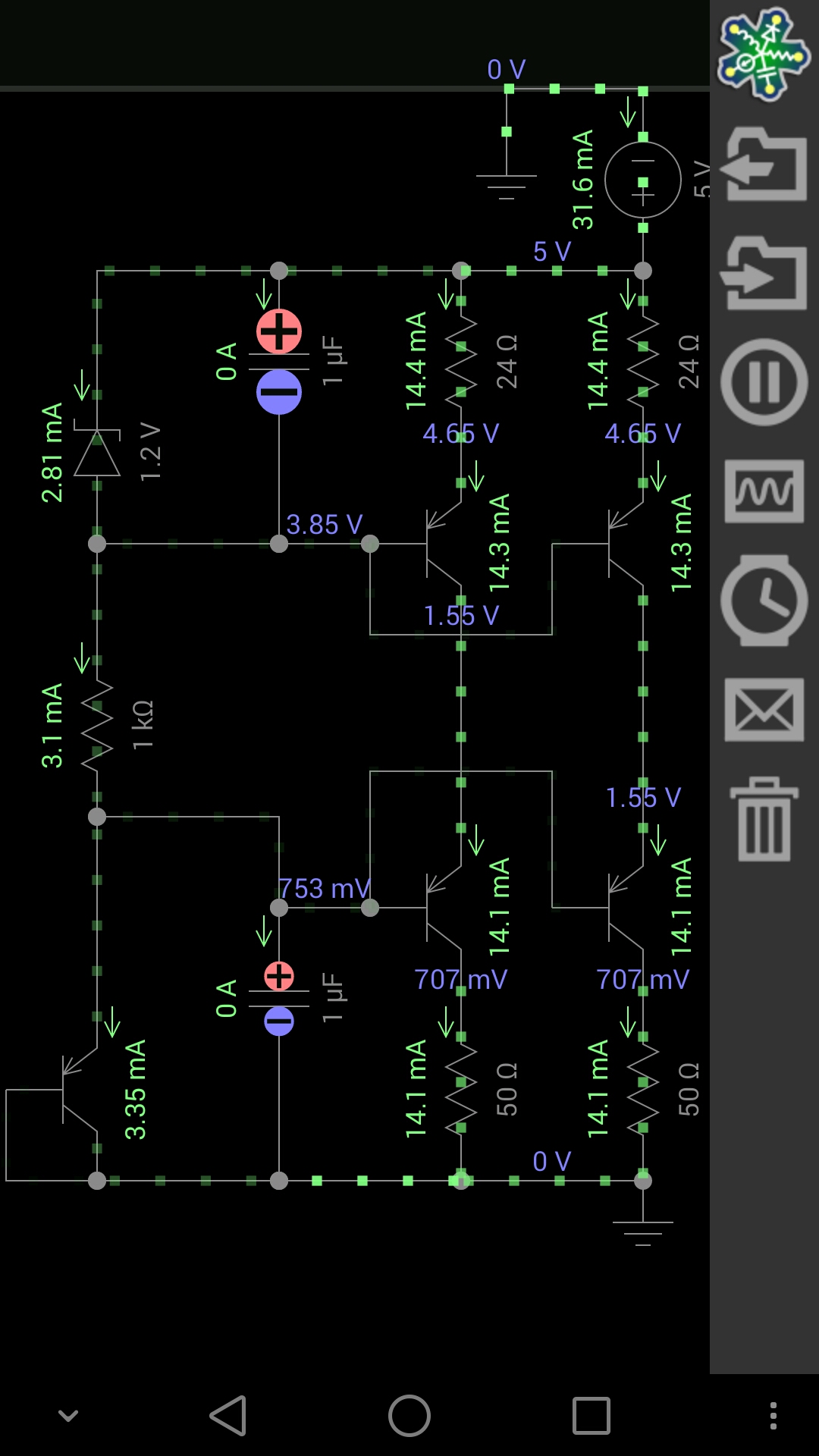

Jussi, forget opamp, try discete IV with UHF Transistor Arrays. Take a look at intersil HFA3xxx series.
cheers
Or a variant of the EUVL Sen I-V (very low noise) with commonly available BF862 JFets: http://www.diyaudio.com/forums/digi...inimalistic-iv-converter-182.html#post4633856

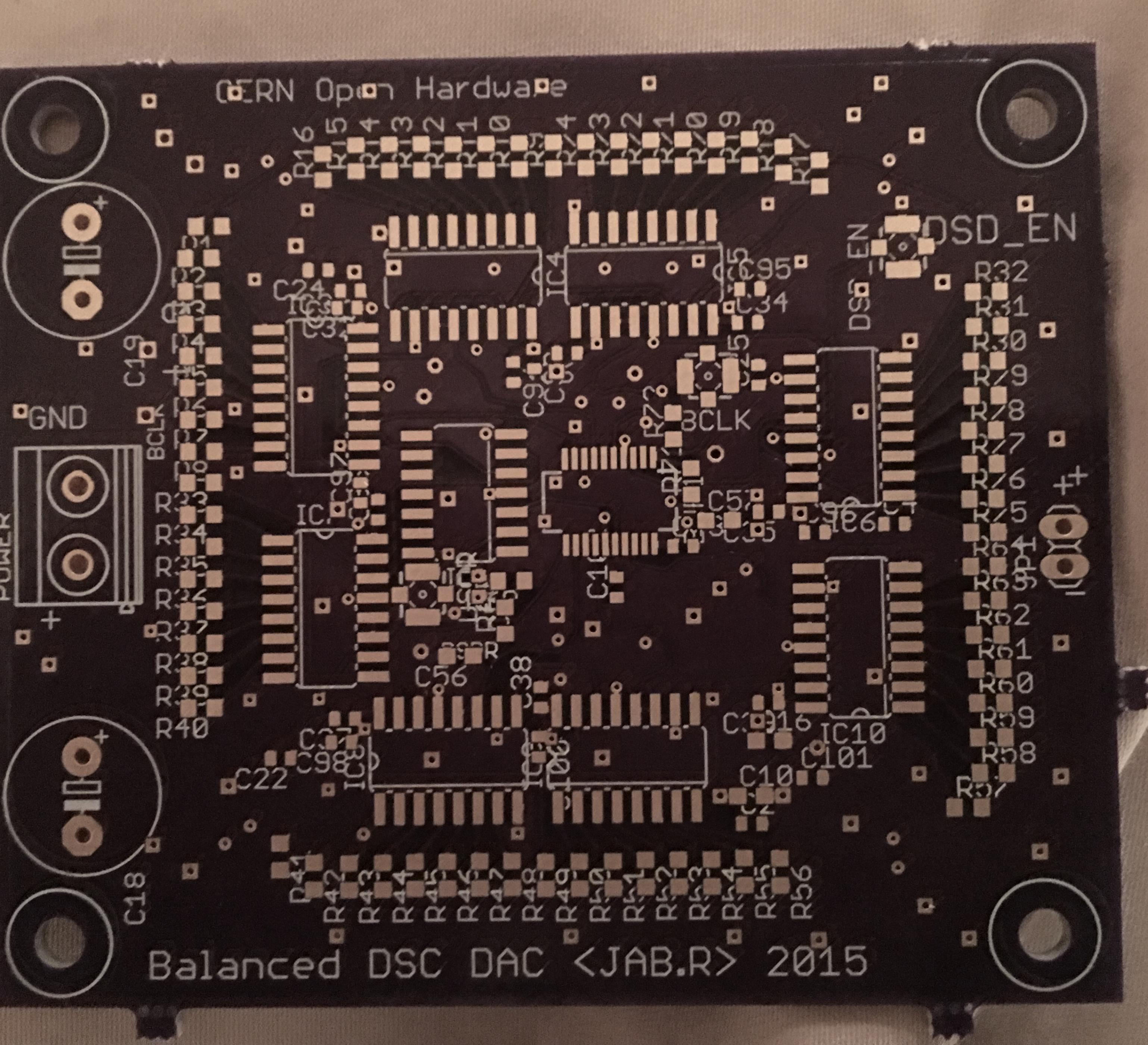

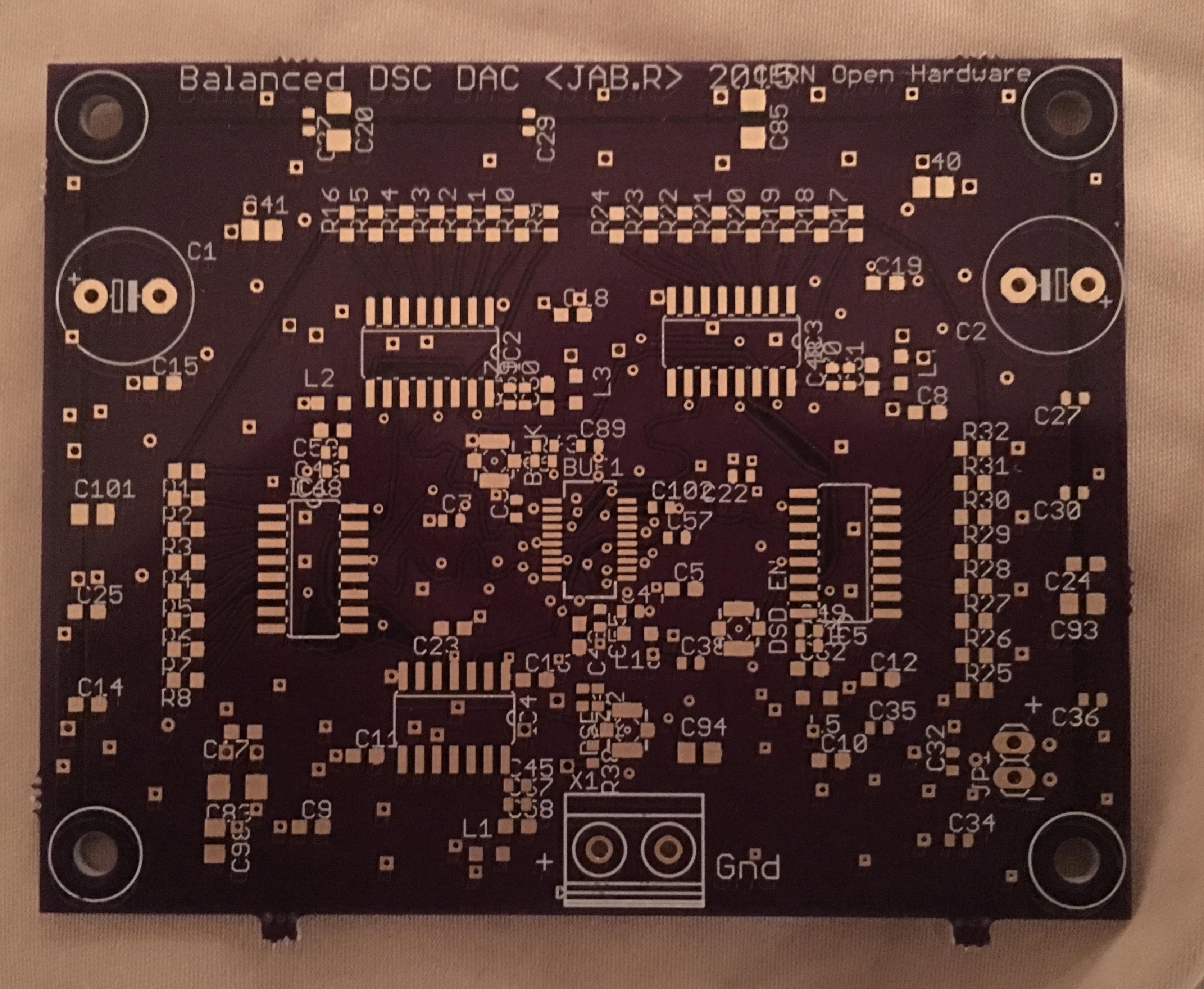

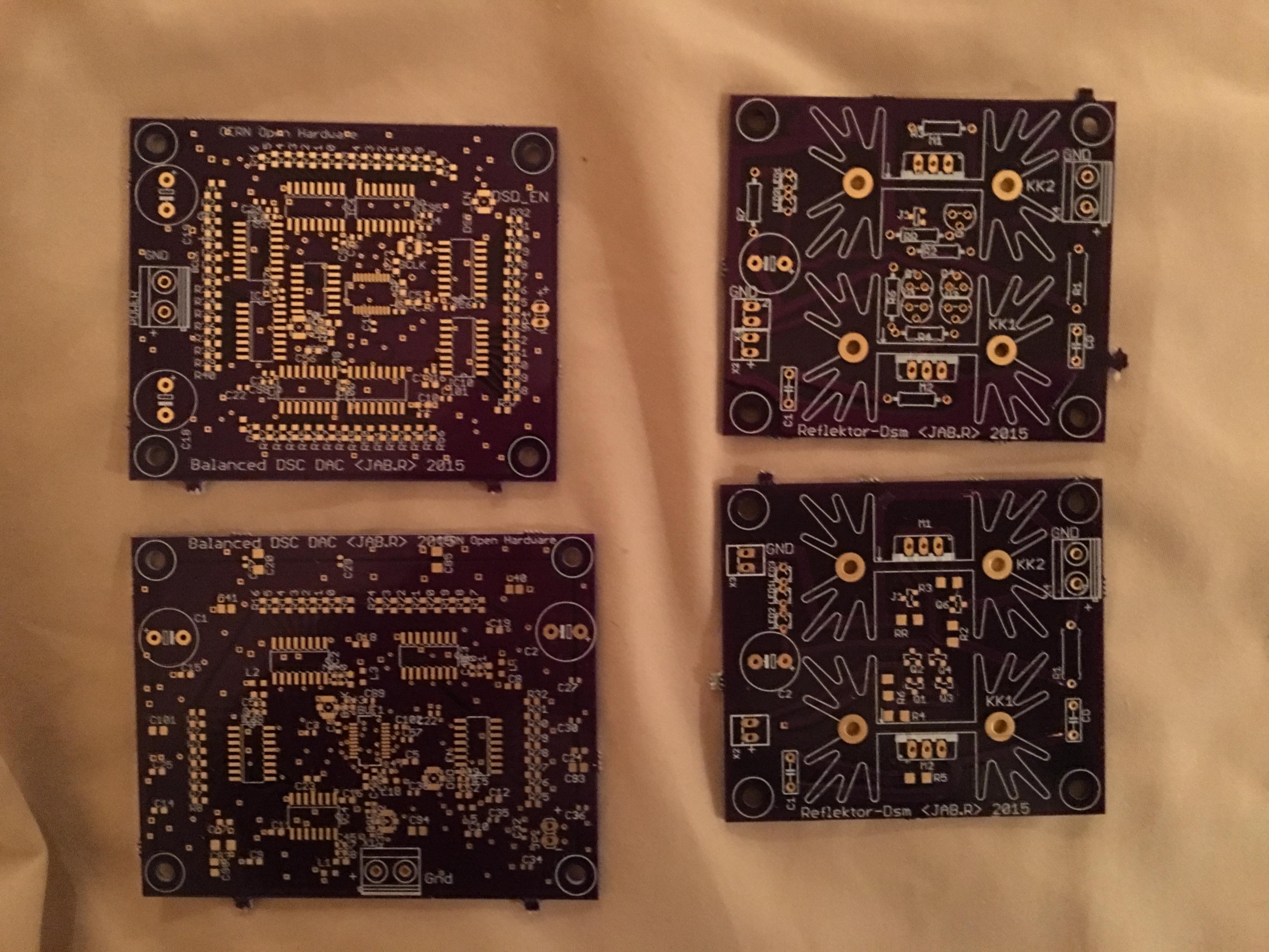

Boards arrived:
The parts are inexpensive -- majority of cost are the Susumo RG series 15k 0.05% 10ppm resistors.
Both boards are SMD double sided, the first mostly bypass caps and the chokes that filter each chip. The mirrored version obviously has chips on both sides.
Its going to take some time for me to build, get all the components together to test, needing to build the I-V (sen variant bf862/j111 cascode) and SK filters (jfet buffer based) as well as Salas reflektor-d supplies for digital side, NiCad battery suppies for I-V etc.
For reference, the schematics used:
Clock path optimized:
Mirrored:

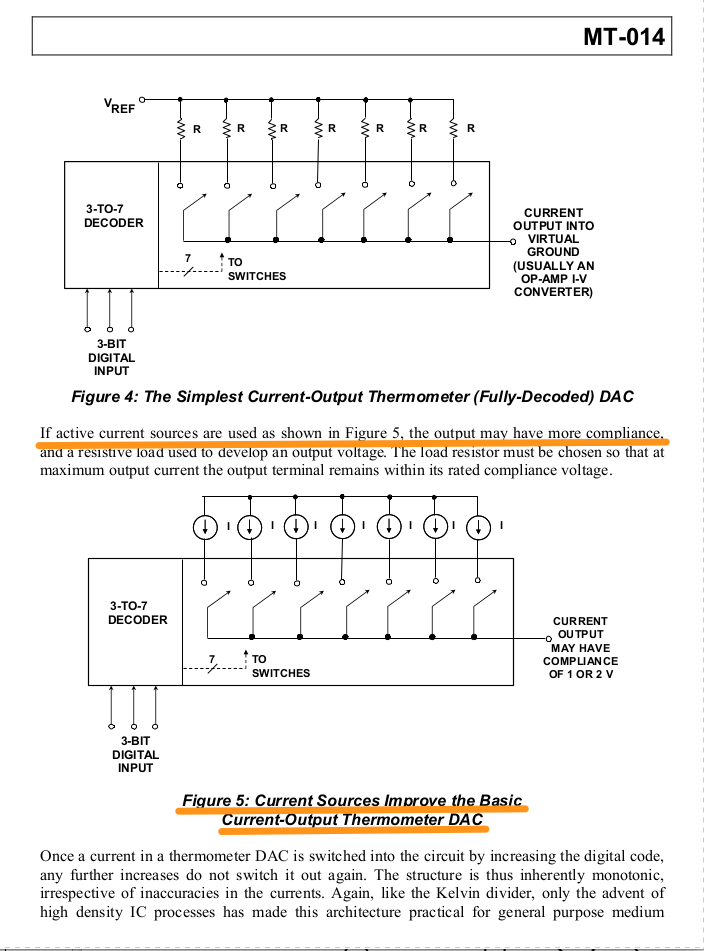

I have never heard a DAC I/V stage using IC opamps which was not bettered by a really good discrete design. But, I am not sure that is what is going on with Jussi's design. I suspect he may be needing to use ICs as high speed switching devices to drive the digital DSD signal. Then the following stage would be the output buffer, and that could be discrete or IC based...
For high speed, on/off switching, a really, really fast IC is going to be the way to go.

I've been really swamped at work and with kids activities on weekend -- my son does travel hockey and while I can lots of design etc on my laptop in various hotels, hasn't led itself to working much in my shop 🙁 That said when I get a break from work I am all set to sit down and place all those little SMD parts and then cook the board.
The idea about cascoding the jFets (cascoded SEN with bf862/j111) should minimize the Miller effect/improve bandwidth. EUVL alluded to that. That said, since we are then going to LPF the output having a higher input capacitance may actually be a blessing as noted by Pass.
