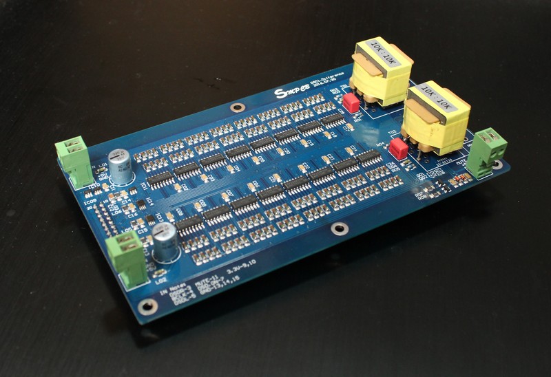

Here are some pictures of the PCB, as you can see, a neat layout with crisp, clean tracks. Registration looks OK. I obviously can't comment on the circuit implementation...
Ray
Ray
The smd soldering isn't as bad as I imagined it was going to be, I might even get the hang of it before I finish the board!

I've received the above mentioned chinese board yesterday and assembled today. Came across this topic only after ordering it. Many thanks to the author.
Unlike most of diyaudio topics, this one says really nothing on the SOUND of this design in 27 pages of tech discussions, that's why I call it funny.
As of now the board's been done in original schematics, except the resistor matrix: I bought 4.99k Susumu 0.1% resistors instead of 15k, which (I believe) is going to somewhat improve SNR. Got a pair of ad844's, a pair of lme49713's, and an idea of composite opamp in the i/v. Will listen soon, and see what's next.
All the voltages will be supplied by Jung's "super regs". The SRC is AK4137. If I see a good potential in this design (now I only feel it) the next step will be an own SRC on a FPGA.

Have you noticed that the Chinese board doesn't incorporate the grounding updates Jussi published here;
http://www.diyaudio.com/forums/digital-line-level/254935-signalyst-dsc1-2.html#post4104608
It looks like the schematics were not updated for these changes as they predate the above post by several months.
Instead of AGnd and DGnd connecting at pin3 of the AD844s they connect via L15 (Chinese BOM doesn't state type or value).
The schematic (and Chinese PCB) do include a 100K resistor to ground from pin6 of the AD844 but it is on the output side of the 2.2uF capacitor.
It looks as though some modifications are needed to the Chinese PCB (simple enough) to comply with Jussi's updates.

Yes, I will run a wire from the DGnd pad of the ferrite bead to pin 3 of each AD844.
With the 100K resistor, the extra (electrolytic) pads for the 2.2uF cap make it easy to move the resistor connection to the input side, but I guess you've worked that out already.
For gain, I've left R1/2 (499R) and used 7.87K Susumu RG 0.1% resistors in the filter network.
Whoa. This chinese guy is just ahead of me. No i/v stage at all?
The transformers are the I/V stage (and perhaps gain as well)?
