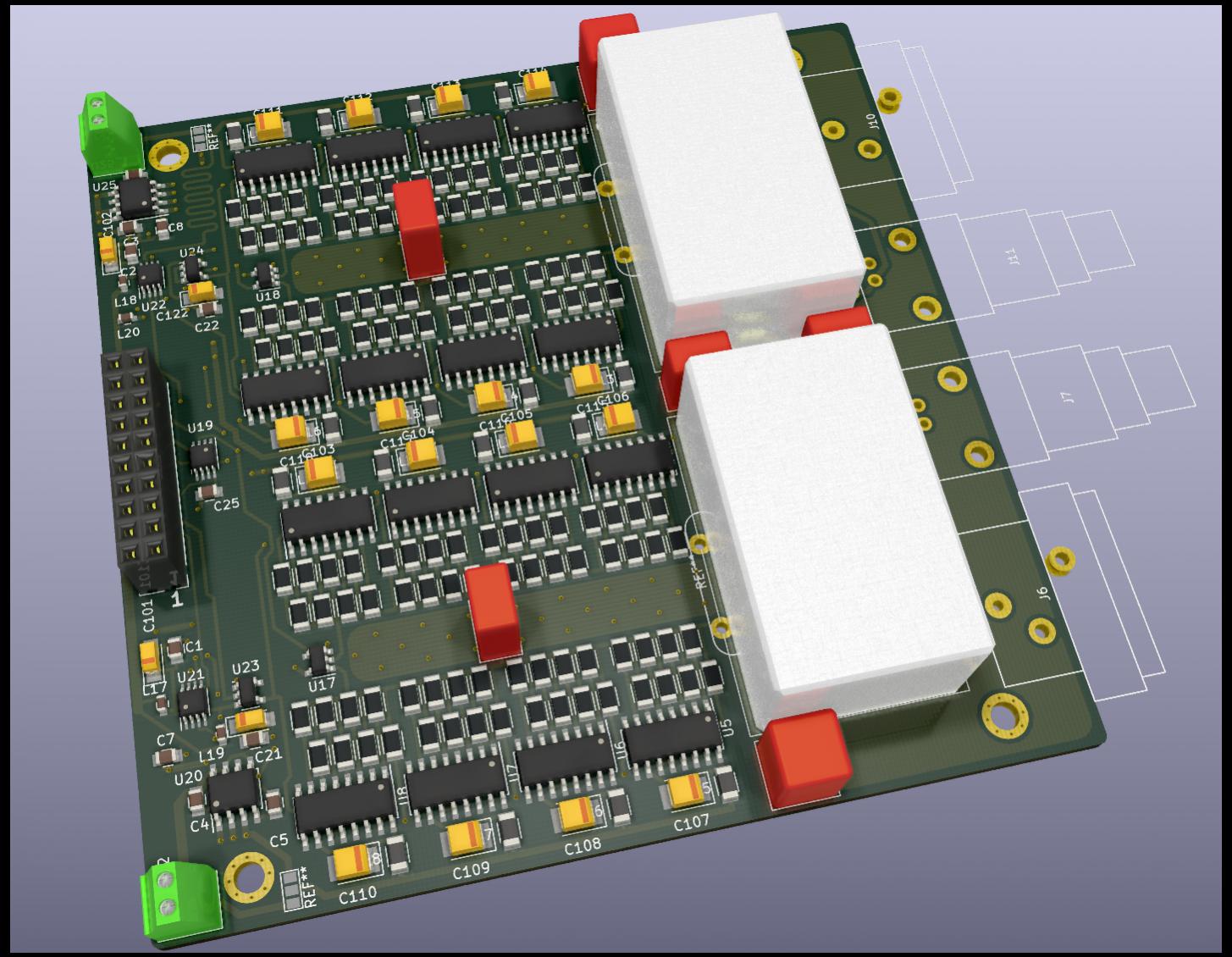

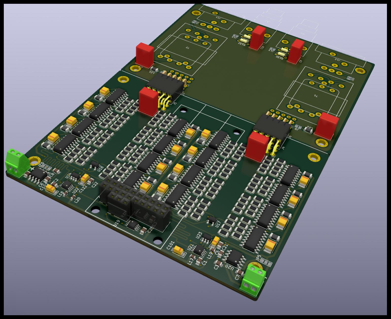

I prepared two versions of the release:
The first for the DIY community with great opportunities to change the design - v2.5.2
- You can install Amanero along the board or the second floor.
- Replaceable output module with Chinese transformers or Lundahl LL1527xl
- The output module can be placed on the third floor or under the main board.
- You can disable built-in LDO
- It is possible to put resistors of any size 0603-1206
The second release v2.6.2 is made on the same board with the possibility of replacing the transformers.

DSC is designed to work with Amanero. A MUTE signal is required for this DAC.

Do these boards contain 2 exact copies, mirrored channels? May one cut a board in half and use them separate?
The channels are completely isolated except for the MUTE control circuit.
The board can not be cut in half.🙂
As soon as I check the performance of this release, I will give the gerber files for self-production in any quantities.It would be much easier if Pavel could offer blank boards so he doesn't have to do all the assembly by himself. 🙂 I'm in for whatever you will offer.
