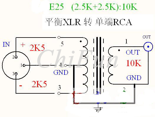

I had the opportunity to compare LL1527XL and Chinese transformers. I like Chinese more.
