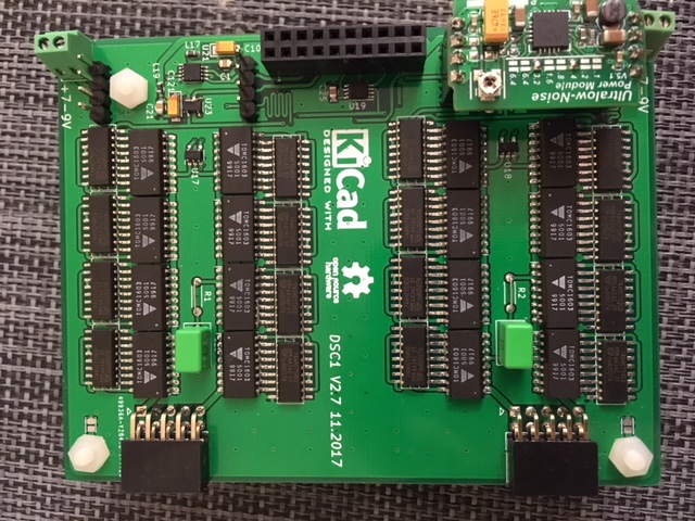

In the release, I'll save the LDO. They will be installed directly on the board. And it will be possible to connect a separate power supply. But my opinion is that this DAC good LC filters for each chip allow us to use cheap LDO without loss of quality.
I also envisaged the possibility of installing resistors of different sizes 0603-1206.
P.S. I have a v2.7 with resistor networks Vishay TOMC1603. Unfortunately, TOMC is discontinued. But there is a modern replacement - NOMC. The sound of this version I like most. But these resistors are quite expensive.
I do not think that the resistor can significantly influence. I have retained measurements of the non-balanced version of DSC1. Very similar to the measurement of the version with FF. And most importantly, both options have an unpleasant correlation noise.

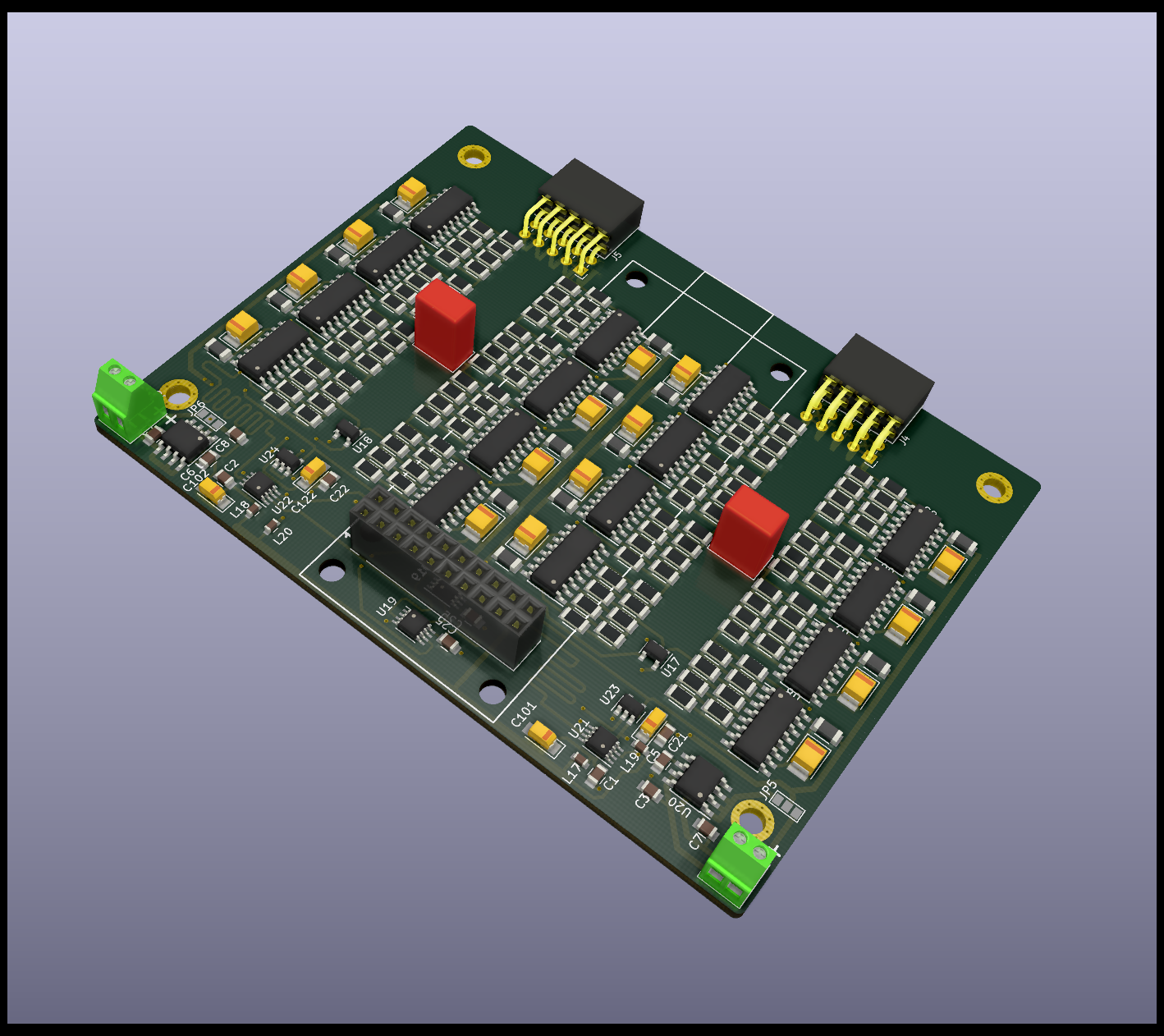

The following changes were made:
- The design will be with a replaceable output module.
- Inverted Amanero.
- Replaced OS-CON with organic tantalum capacitors KEMET. Better SNR and less 2nd harmonic.
- It is possible to install resistors of any size 0603-1206.
- LDO ADP7118 is installed on the board. But jumper JP5 and JP6 allow using an external power supply.
This is Great!
Any reason ADM7150 is not used here?
ADM7150 is a good LDO. But...Any reason ADM7150 is not used here?
The reasons are enough. 🙂

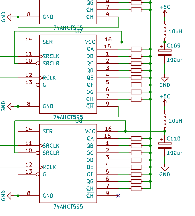

- Each chip receives power through an LC filter of 10uH+100uF. Therefore, good noise parameters are not required.
- Connecting the ADM7150 is a bit more complicated.
- The price is higher.
